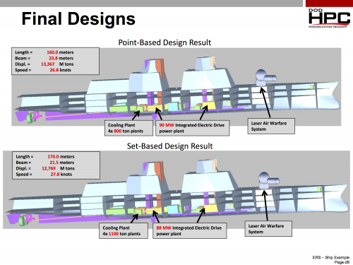

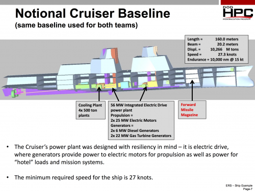

Funnily enough, a notional cruiser design space exploration paper did a include a 12 MW, 450 metric ton laser AAW system.
  • Wednesday14965_Mackenna.pdf

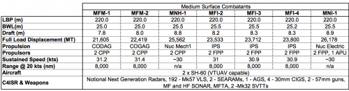

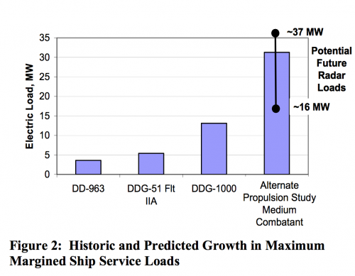

Wasn't the motivation for two reactors a federated design where one reactor was coupled to one propeller?
I think in all of the studies over the past decade+ the Navy only looked at single reactor arrangements
typically of the nuclear IPS style; the "medium surface combatant" specs were quite eye-watering.
  • Webster_James_AlternativePropulsionMethods (1).pdf
It may have been because they didn't have a single reactor available of sufficient power. That's why Enterprise had 8 reactors, two to a shaft.
Damn. :'(

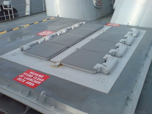

This would be mainly putting VLS cells for Tomahawks and maybe ESSM onboard.
I think we discussed this in another thread, but BAE's McCullough was pointing out that the MK 132
cannot accommodate the weight of 8 x ESSM Blk IIs. The Adaptable Deck Launcher (in some form) is
being pitched as a replacement.
There are always the VLS cells. (Why would you think there would be an 8-cell Sparrow mount? San Antonios don't have them.)
An upgrade for MK132 to handle ESSM Block II has gone to RFI.
sferrin said:
Forgive my Monday-morning incoherency: the Adaptable deck launcher gets a mention in the article and
is being pitched as a Mk 132 replacement on the Nimitz and Ford class and a firepower enhancement on LCS.

You'd think there would be enough space for a set of Self-Defense length Mk41 VLS. One in each aft sponson (of the CVNs) would give them 64 ESSMs.
The typical argument against VLS for self-defense has been the increased minimum engagement distances for ESSM but
maybe RAM Blk II in the trainable launchers makes that less relevant.
