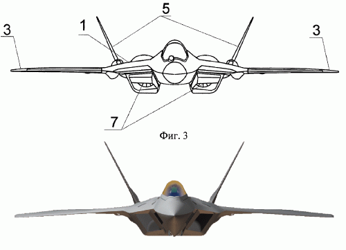

PAK-FA drawing from patents and F-22 graphic from Lockheed Martin, side by side. Assumed wingspan for F-22 is 13.56 m, T-50 is 13.95 m. Hard to tell which one is thicker from frontal diagram because F-22 wing twist. T-50 does not seem to have this kind of twist.
I think part of the twist is actually conical camber, and in any case the T-50 does have both as well, just not nearly as pronounced (which might well be down to the higher sweep angle). As for thickness, what's perhaps more important is t/c ratio, which should favour the wing with higher sweep, as its chord will tend to be longer.
