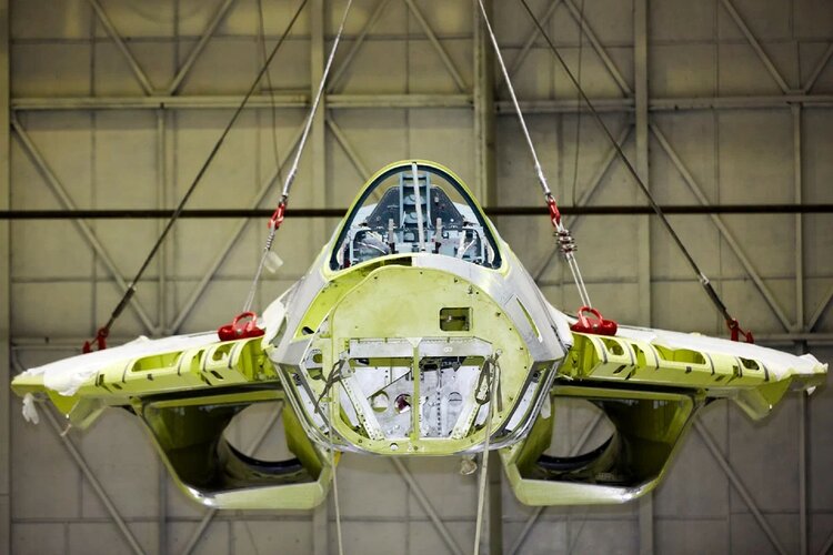

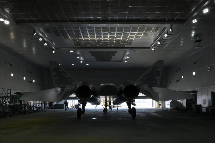

There's something white between the two halves, but in that light it's impossible to be sure.

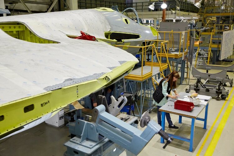

In that article, among other things, there is an interesting note about the complexity of the structural solution of the fuselage with unprecedentedly large weapon bays with regard to overloading during demanding maneuvers, plus many other interesting things.

Special mention should be made of the materials used in the design of the Su-57. It also uses traditional metal alloys, but there were some innovations here too. For example, in the airframe of the Su-57 there are four times fewer parts than in the Su-27. This was achieved, first of all, due to the capabilities of high-performance machining tools, as well as due to electronic prototyping in the development of the aircraft. As a result, there was a qualitative transition to large milled parts, the number of fasteners and small parts was reduced. “This made it possible to significantly simplify the design,” says Andrey Filatov, head of the research department (R&D) of materials and technologies at the Sukhoi Design Bureau. – According to production specialists, it has become much easier to assemble the aircraft, because large parts come to the assembly.
If we talk about the outer surfaces of the Su-57, then about 70% of their area is made up of parts made of composite materials. It was composites that made it possible to make larger skin elements, while simultaneously reducing the number of fasteners and the number of conventional parts. There were new technological methods, methods of work that required additional equipment.
Close ties between the Sukhoi Design Bureau and composite manufacturers, developed in previous projects, contributed to the widespread introduction of composite materials. “For example, we used to work well with NPP Technologiya in Obninsk,” Andrey Filatov recalls. “For the Su-57, they had to master the production of many new specific parts, use new materials.” On the other hand, according to Andrei Anatolyevich, when using composite materials, the designers of the Design Bureau got the opportunity to control the properties of parts by changing the options for laying the filler. “After all, you can put all the material in one direction, you can put part of it perpendicularly, you can put it at 45 degrees. Combinations of these stackings determine the final properties of the part,” Andrey Filatov explained. - So far, composite materials have only one significant drawback: they are more expensive than metal ones.
Before launching parts made of composite materials into mass production, a large number of their full-scale samples were tested. At the enterprises-suppliers of products, they achieved full reproduction of the specified indicators due to the regulation of the production process, strict adherence to technology and strict control.

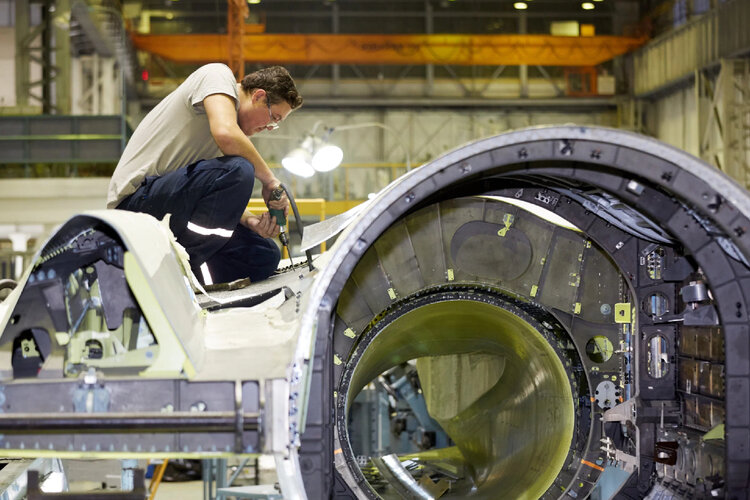

In the manufacture of the Su-57 skin panels, it was very important to meet the highest requirements for accuracy and for one more reason. “The quality of the surface seriously affects the visibility characteristics,” Mikhail Strelets explained.
In addition, other special events were implemented. These, according to the director of the Sukhoi Design Bureau, included, for example, the use of special radio-absorbing and radio-reflecting materials. Shielding materials were also used, in particular on the antenna compartments. “All onboard equipment, for example, facing the leading edges, was designed to meet the requirements for low radar visibility,” Mikhail Strelets specified. - To reduce infrared visibility, certain measures were also implemented. For example, shielding of engine emissions is provided by blowing through the heat exchangers of on-board equipment.”

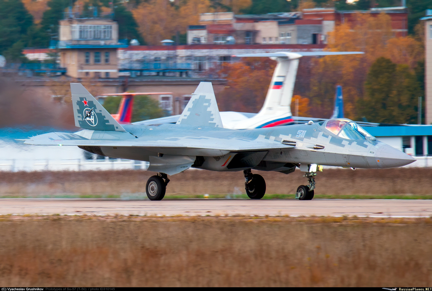

Visible changes on T-50M prototype:
- new sensor
- new 101KS-U sensor
- new helmet
Appears I was wrong in my initial observations regarding the new 101KS-U sensor, in terms of dimensions the bulge is still present as before. Not as slimmed down as I thought.
That picture shows T-50-11 before the modification. That "new sensor" Quadro spots, has been there from the very beginning of the second stage (T-50-6-2 onward, in fact the hole for it was seen in the second static model already).
This is the picture Quadro made that cut from:
scale_223400-jpg.690504
That is T-50-11 as it was seen at MAKS 2021, before the upgrade.
Here are some pictures of it after the modification:
And here it is a few weeks after the revelation in November, the apparently new 101KS-U sensor having been removed:

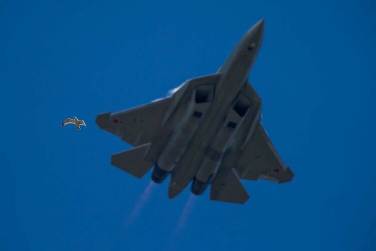

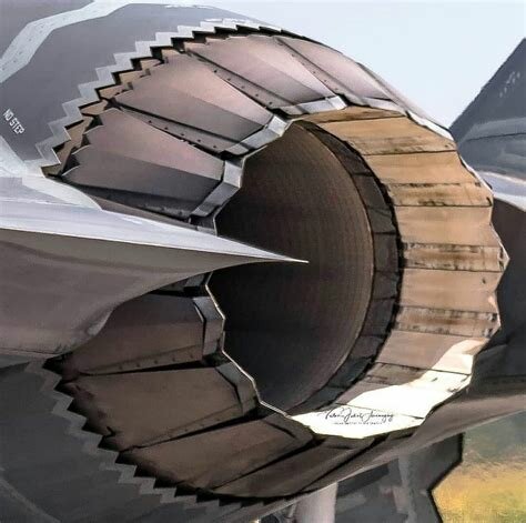

The photo shows the nozzle divergent / external flaps with chevron trailing edges, but every thing else is straight edges both internal and external. Looks like LO considerations are mostly cosmetic.
The inside of the f-35 nozzle Look very similar to me. The only thing I don’t see is serrated edges on the engine covers and a better seal between the el tailerons and fuselage. Who knows if they are planning on adding them later. Maybe they don’t want to waste time and money doing it yet. 1D5E2720-A642-45C4-9DB9-FE4A616EB50A.jpeg
The inside of the f-35 nozzle Look very similar to me. The only thing I don’t see is serrated edges on the engine covers and a better seal between the el tailerons and fuselage. Who knows if they are planning on adding them later. Maybe they don’t want to waste time and money doing it yet.View attachment 690836
The internal liner to Convergent flaps and trailing edges of the convergent flaps can be relatively hidden with the nozzle closed. It will be interesting to see if they come up with anything at the front of the augmentor to hide turbine blades and eliminate the highly reflective flame holder and sprayrings /spraybars.
Static discharge wicks, most likely.
