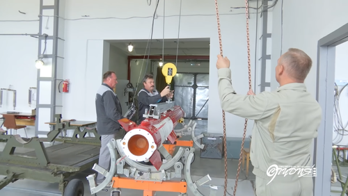

Is that real or a fake?
What happened?
Very real. It is safety testing, footage here (follow the link for timestamp);
View: https://youtu.be/QnxvLedbM0k?t=394
It is not unheard of, check the testing with Tornado as linked previously in this thread, or Su-35UB without canopy. Also, Izd.180 at 10:20 in the video, screenshot attached.

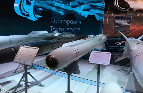

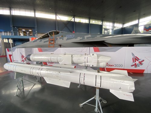

My bad, thank you for correction. Looks like Kh-38ML indeed looking the smaller orange dots next to exhaust and their fairings and a number of other differences.
attachment.php

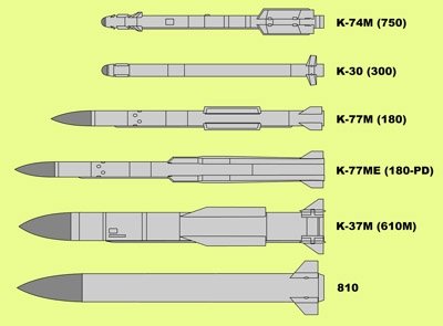

Can you please tell me which one of them is R-37M?
In that photo, none of them (unless you consider Izd 180 as encrouching on R-37M capabilities).
First two are short range missiles, and then R-77-1 and the follow on.

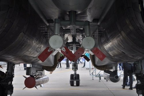

If this is not a static display trick.. would not the left R-77 have to be launched first.. or the right one.. i'm not sure, lol! It would depend on how it seperate from the adaptors?
But they do look to be in conflict with its mesh fins.
It would drop or eject the missile, not make a rail launch., I see no problem with it. The missiles are staggered so the fins do not make contact...

If you say so. Most of the Russian A2A missiles launched from wing adaptors are Rail launched. Hense my train of thought
The R-77 is dropped (forcibly ejected) before it ignites, by the standard launcher (AKU-170). Don't see why the dual one would be different.
АКУ-170Е относится к пусковым устройствам поршневого типа. Оно состоит из силового корпуса, имеющего узлы подвески к самолету-носителю. Внутри корпуса размещены передний и задний гидравлические толкатели для катапультирования ракеты, приводимые в действие пиротехническим приводом (через механизм синхронизации) при использовании энергии пиропатрона ЭПК-28Т-2.
Besides, as there are two hardpoints in tandem in the Flanker "tunnel" that are often both occupied by medium-long range AAMs, they *have* to be dropped no matter which launches first. It's either that,
or suicide either way.
Then you have the Semi recess missiles on the belly of the Mig31. Those like the the F4 and the Flankers needs to dropped or else you will experience a significate emotional event.
