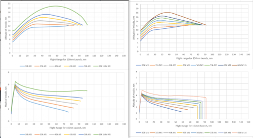

The missile may have like half of its weight dedicated to rocket motor, since the dimension is quite evident (2 m class and 20 cm diameter) One can resonably guess launch weight to be at something like 88.6 Kg. Assuming 40 Kg of it dedicated to propellant, L/D of 2 (reasonable for axisymmetric missile) and boost-glide profile it can reach like 60 Km.
As you see in image is my estimate on potential trajectory, assuming Mach 0.9 launch speed and 12000 m altitude

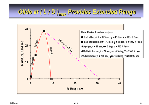

Thanks for the analysis. Two questions:
- Wouldn't the lattice fins affect that L/D you estimate?
- Are you sure regarding that flight profile? Normal lofted trajectories I have seen look different, with a less marked climb at the beginning. For this one of yours I am left wondering what the resulting flight speeds would be.

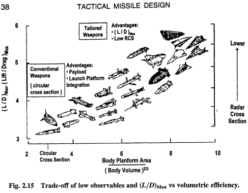

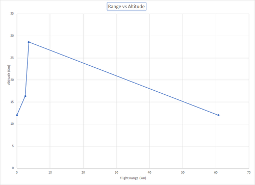

I would say the effect wont be too much as the fin might only move little bit and locked during the apogee. It will start make matters at endgame when it determine maneuverability. In fact it is very conservative as for axisymmetric you can actually have L/D max of 3. But i use 2 to take account for possibility that L/D might change along the flight and cannot be compensated by the guidance.
and i am very sure about that flight profile. It does not really like the "smooth" curve of the Ballistic profile of the 5V55 missile but that's just what happen when you only have few points of data yielded from the equations. You can google up trajectory estimates methodology by E.Fleeman in his missile design course and you will find similar trajectory plot.
The speed profile of the missile are as follows :
At the end of boost phase : M 5.6 and altitude of 15562 m
The missile continue to climb unpowered until its apogee at 27800 m, at this stage the missile velocity is M 3.7
The missile proceed to glide down to target altitude of 12000 m at the end of the glide/endgame the missile's velocity is M 1.2
I hoped to find some CFD analysis by user "litzj" (http://jaesan-aero.blogspot.com/), but he didn't do R-77. In any case the shockwaves at the lattices may cause interference if the speed range is very wide (like in your case from 5.6 to 1.2 M), a detailed analysis would be needed. From what I see it is normally assumed that the reduced range of the R-77 vs. the AMRAAM is mainly due to drag and flight profile issues.

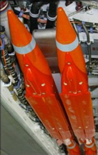

We know that there are single munition launchers and launchers for two munitions (stacked one behind the other). So it'd seem safest to assume one long range missile (up to 700kg) or two of these short missiles per door.
It looks like a cut down R77. Shortened rocket motor and added TVC. Foreend is copy & paste, until red section (rocket motor) starts. It looks as well a booster could be added. The housing and the wire tray end like there could be added something. So maybe a WVR 1-stage and BVR 2-stage system?
Further interesting are the windows in the strake of the R-77 version. For aerodynamic reasons?
