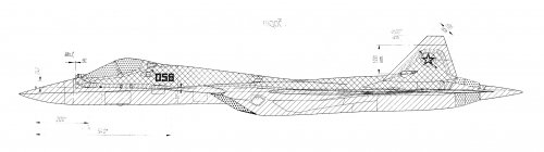

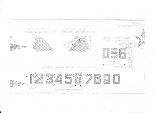

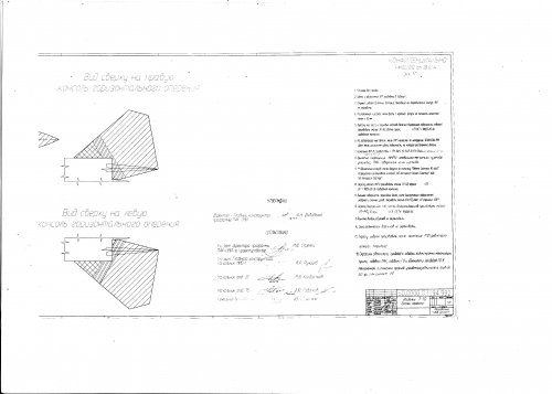

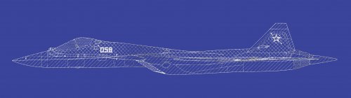

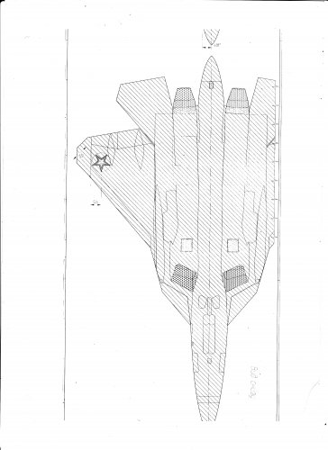

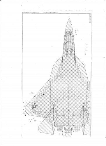

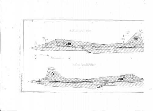

"Spot 10 differences" in the attached pics... The last two are cleaned up by a friend of mine.
After looking at it more closely the tail stinger does appear to be a bit longer. Any reason as to why?
If these drawings are official then we may be able to get the exact dimensions of the aircraft.
Trying to measure length from that drawings. Got 19.4 m length. as for wingspan.. the top aspect image give 14.4 m
does that sounds reasonable ?
