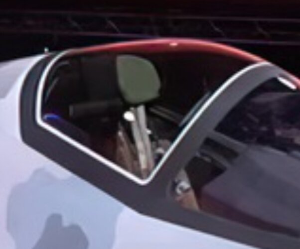

Not only the canopy bow but the geometry of the canopy (not wind screen) that rescind abruptly where the pilot's helmeted head sits. That could make swiveling from left to right difficult with a rear view only possible when the pilot lean forward.
The seating position is also odd with the seat headrests nearly in contact with the canopy.
Once again, with helmets as they are built today for off-boresight targeting and synthetic imagery, the available space looks oddly small.

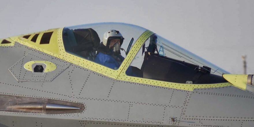

Do you even realize that part comes DIRECTLY from the Su-57?
Just coming from the Su-57 raises questions in itself - is the over the nose angle the same? If it isn't, does that mean raising the seat to achieve an acceptable over-the-nose view for landing? If the seat position has to be moved, how much space does that leave for the pilot and helmet? And so on. These aren't comments to run down a Russian project, they're questions we'd ask of any project.
