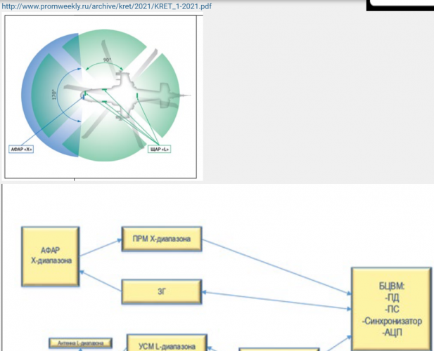

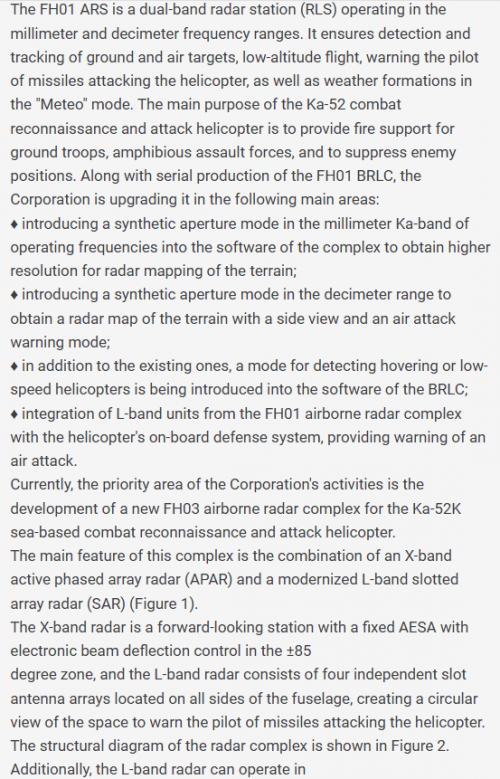

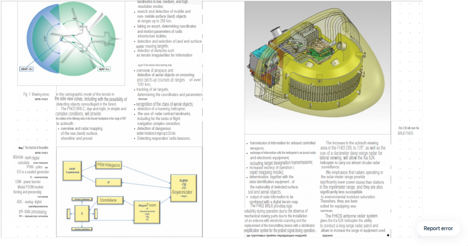

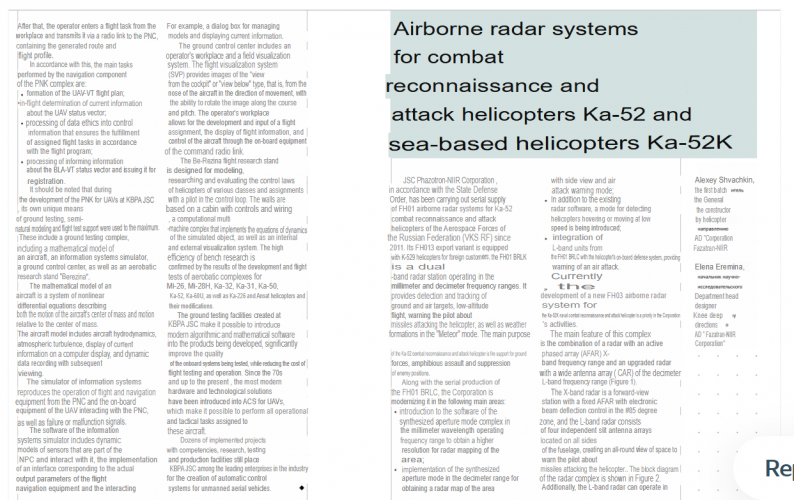

BRLC FH03 radar consists of 4 slot L-band arrays and one X-band slot array in the front. it can search for detection of moving and stationary surface (ground) objects at ranges of up to 250 km. Detects air objects passed 100 kms. I am assuming the L-band arrays on the Su-57 wings are far bigger than the 4 L-band arrays on the helicopter they are talking about.
The L-bands they are talking about sound like they are used for radar surveillance
The L-band they state can detect objects camouflaged in the forest or be used as air surveillance, I am assuming the 100km+ is what they are referencing for the L-band and 250kms for the X-band. Maybe the antenna size and power range would put the L-band tracking capabilities to be efficient at 200kms but anything past that as imprecise?
As they described, the L band (decimeter band) is used for SAR (Synthetic Aperture Radar) and early warning
Synthetic Aperture Radar (SAR) is a type of radar used to create highly detailed images of landscapes, structures, or objects, typically from aircraft or satellites. It works by simulating a very large antenna (or "aperture") using the motion of the radar platform to increase resolution far beyond what a physical antenna of the same size could achieve. It doesn't work against air target though since they constantly moving very quickly.
As for the so called early warning against air attack, they probably want to take advantage of the very wide beam of the L band. Because the L band is not used for fire control, so the only thing it need to tell the pilot is if something is incoming at high speed. Probably used to supplement L370 Vitebsk which use UV based missile warning sensor. An UV sensor would be useless against coasting missile, unlike radar based MWS. Assuming the L band length is about 1 meters, with operating wavelength of 30 cm, the beamwidth would be 21 degrees. Which is not very useful at long distance. But if your goal is only warning of missile attack when the missile is like 2 km from your position then you can probably get missile azimuth position accurate to about 700 meters.

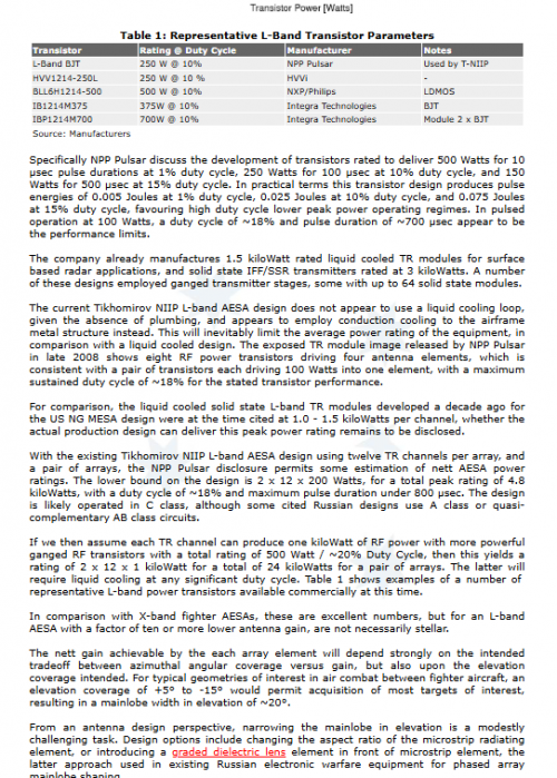

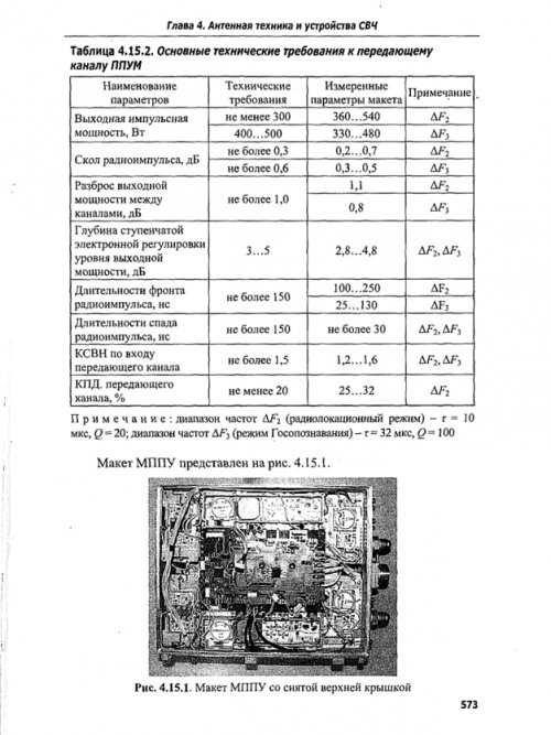

So basically 500W peak per T/R module for radar?
Is there any information about their cooling requirement?
So quite similar to most ESA basically.
From 2010 it was 700W with plans to increase the value to 1 kW in 2011/2012. This is some original Russian NPP 'Pulsar' articles about that. I already posted transl versions.

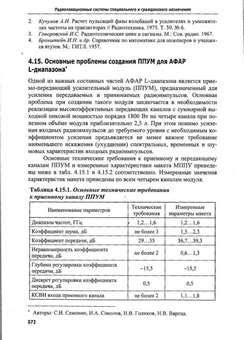

This one is from 2010 :
МОДЕРНИЗАЦИЯ МОЩНОГО МОДУЛЯ БОРТОВОЙ АФАР L-ДИАПАЗОНА
''Модуль первичной разработки был представлен на конференции «Пульсар-2008», сейчас он осваивается в производстве. Вопрос о его модернизации – ответ на требование оперативного повышения уровня эксплуатационных характеристик, что свойственно быстро развивающимся
областям техники.Главная цель модернизации – повышение уровня выходной импульсной мощности с 400 Вт до 700 Вт в рекордной полосе частот 1 -1,5ГГц в каждом из 4-х каналов модуля. При этом габаритные и присоединительные характеристики модуля остаются неизменными.В основе модернизации – новое поколение интегральных сборок под
названием «усилитель мощности» взамен мощных СВЧ транзисторов, а также развитие принципа объемной интеграции. Модернизированный модуль является приемопередающим устройством с коэффициентом шума в заданной полосе не более 4 дБ. Рассмотрен вариант конструктивной модернизации корпуса с целью повышения технологичности сборки, контроля и ремонтоспособности. По параметру удельная выходная импульсная мощность на единицу
объема модуля полученный результат (2 кВт/л) превышает известные мировые достижения.''
You asked about beamwidth and this is also original Russian doc. about that ( already posted and translated).
Be aware that there are data for the transmitting and for the receiving. ∆f1 is in fact radar mode and ∆f2 is IFF mode.
''4.2.1.8 Ширина ДН в азимутальной плоскости по уровню минус 3 дБ при работе в поддиапазоне ∆f1 должна составлять.
4.2.1.8.1 При работе на передачу:
- режим максимальной мощности, град - (130+/-3)/N/cosΘ;
- режим оптимальной ДН, град - (125+/-3)/N/cosΘ
где Θ – угол отклонения главного максимума ДН относительно нормали к антенне, N – число излучателей.
4.2.1.8.2 При работе на прием, град: (135+/-3)/N/cosΘ, где Θ – угол
4.2.1.9 Ширина ДН в азимутальной плоскости по уровню минус 3 дБ при работе в поддиапазоне ∆f2 должна составлять.
4.2.1.9.1 При работе на передачу:
- режим максимальной мощности, град - (102+/-2)/N/cosΘ;
- режим оптимальной ДН, град - (108+/-2)/N/cosΘ;
4.2.1.9.2 При работе на прием, град: (120+/-2)/N/cosΘ, где Θ – угол
отклонения главного максимума ДН относительно нормали к антенне, N –число излучателей.
4.2.1.10 Ширина ДН в угломестной плоскости по уровню минус 3 дБ должна составлять 70-90 град. во всех режимах.''

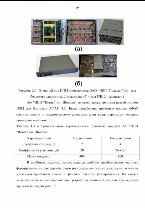

''Сегодня ФГУП "НПП "Пульсар" создает изделия, отвечающие самым высоким требованиям. К ним относятся:

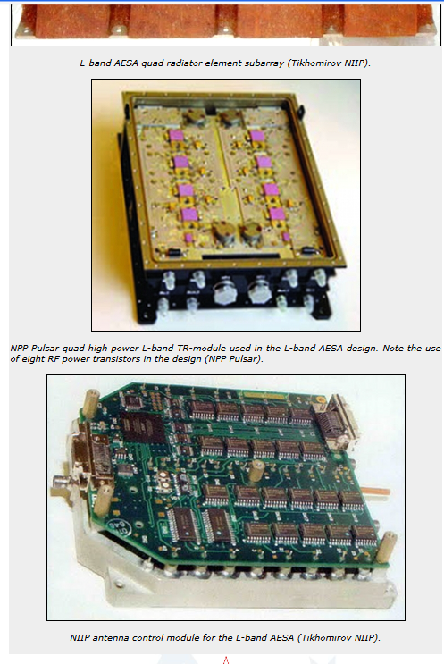

• не имеющий аналогов, сверхширокополосный четырехканальный приемо-передающий модуль L-диапазона (1–1,5 ГГц) с выходной мощностью 200 Вт на канал для РЛС с активной фазированной антенной решеткой (АФАР), объединяющий функции госопознавания, международного опознавания и обзорной РЛС и размещаемый в крыле са-
молета (рис.1). Модуль отличается рекордно малыми габаритами и характеризуется высоким отношением выходной СВЧ-мощности к объему (2 кВт/л) . Он позволит поднять энерговооруженность перспективных РЛС с АФАР, предназначенных для самолетов пятого поколения;

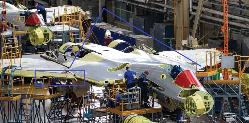

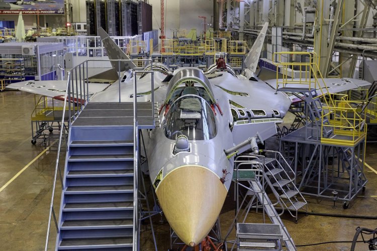

Su-57 Bort number 01 blue. Note the censored area around the LEVCON. Of course they wanted to hide that 1.6 m wide L-band AESA in the leading edge panel.

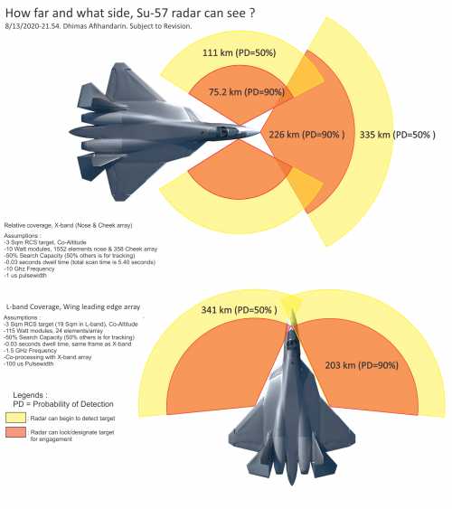

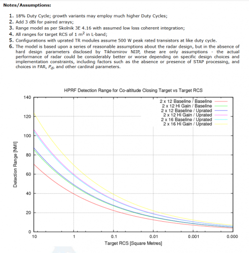

Let's say that L-band array potentials. Especially if one make optimistic prediction on power of the TRM's. Allowances on cooling has to be taken account for. Ausairpower specify cooling was through conduction where the heat flows out of the radar through the metal ribs for dissipation. This limit the cooling capacity to about 1.15 KW/sqm, which in turn limit the average power dissipation of the array. Which can be estimated with following :
For AESA TRM of today, typical efficiency of 35% can be assumed. More is possible depend on the class of the amplifiers (How the amplifier are biased that is). The most linear A-class is the least efficient, but also desireable for signal purity. Radar can do however other class e.g B,C which efficiency can reach 60-70%, but filtering is necessary as there would be spurious harmonics from its operations.
Now if A-class is used.. like Zhuk-AE which use A-class and cooling capacity from conduction of 1.15 KW/sqm, 12 elements and L-band say 30 cm wavelength (about 1000 MHz). Using equation above, the available cooling limits the Average power to 334 Watt for 1 array.
Regardless how much Peak power TRM can provide, the average power are limited to that amount. Any increase would require :
-Increase in cooling capacity (say, switch to liquid) with penalty in weight and volume
-Reduction of duty cycle, means low PRF waveform with long pulse which cost the radar in range and minimum range. Long pulse means the radar might not be able to detect close target determined by the pulse length. e.g 1000 microseconds (typical for L-band Radar) equals to minimum range of 1000*150 (1 us of pulse is 150m ), 150000 m or 150 km. You cannot detect target that close. This typically addressed by transmitting a second shorter "cover pulse" waveform, this imply increase in duty cycle.
-More TRM thus increase the surface area one can dissipate heat but do one have the leisure for wing leading edge ?

Thanks for the suggestions .Now I will present some of the available links...
Основные проблемы создания ППУМ для АФАР L-диапазона
СЕМЕНИН С.Н., СОКОЛОВ И.А., ГОЛИКОВ И.В., ВАРЕЦА Н.В
The main problems of creating PPUM for AFAR L-band
SEMENIN S.N., SOKOLOV I.A., GOLIKOV I.V., VAREKA N.V
Опыт разработки и освоения в производстве приемо-передающих модулей АФАР в L-диапазоне
СЕМЕНИН С.Н., СОКОЛОВ И.А., ФУНДА В.Н., СКИЧКО Д.Ю., БАЦ А.В
Experience in the development and development of AFAR transceiver modules in the L-band
SEMENIN S.N., SOKOLOV I.A., FUNDA V.N., SKICHKO D.Yu., BAC A.V

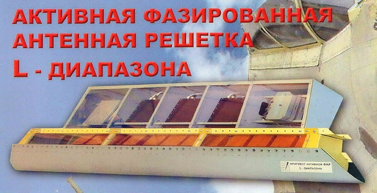

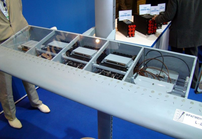

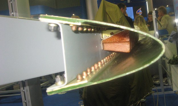

One correction pls, each array ( antenna) has in fact three TRM's only where each has four channels. So there is 12 working channels or 12 RE ( radiating elements) in total.
12 RE in the upper row.
12 RE in the bottom row.
You would still use the number of element to calculate beamwidth so result is same.
What do you mean?
He's saying its a 12 X 2 element array.
so therefore 130/2 = 65 deg beam width in vertical scan at 0 degrees and 85 degree beamwidth at +40 degrees?

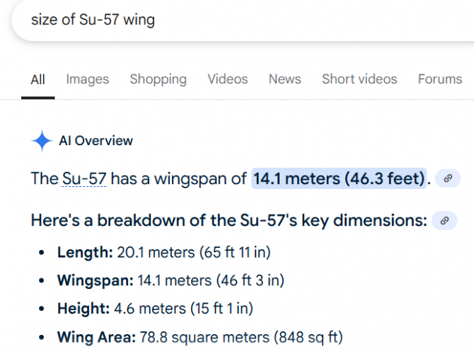

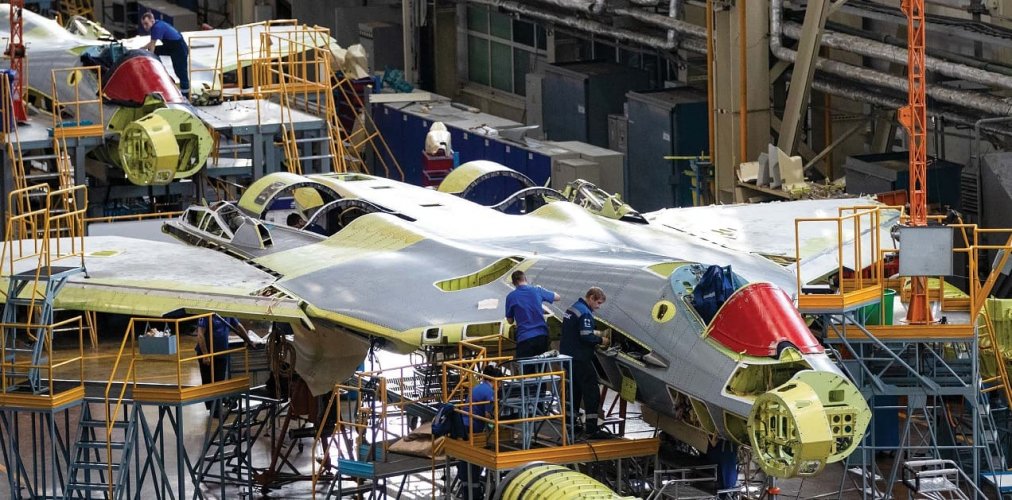

The wingspan of the entire aircraft is 14.1 meters, and height of aircraft is 4.6 meters according to a simple google search. Roughly what is estimated length of the entire N036L antenna and with that estimated length and size what is needed at minimum for 1-2ghz tracking to work or what frequency would work with that sized antenna (like C-band or S-band)?
There is the cockpit, the LEVCONs, supposedly the placement of the L-band radar and the wing tips which look like 6 pieces of the aircrafts that measure the entire length of the wingspan of the aircraft which is supposedly 14.1 meters. If anything the supposed L-band placements seem as big as one half of the cockpit, LEVCON and wing tips combined which we can divide 14.1 meters by 4 and get 3.525 in meters length and I suppose that is where the L-band radar would be placed.

САМОЛЕТНАЯ АНТЕННАЯ РЕШЕТКА​
''Для этого излучатели вертикальной поляризации установлены в плоскости, перпендикулярной поперечной оси передней кромки крыла, а активные СВЧ устройства и схема суммирования закреплены в отсеках либо подвижного, либо неподвижного носка крыла между силовыми поперечными диафрагмами.''
We can see three blocks with four RE's on each of them.
One block with 4 RE's.
''Самолетная антенная решетка состоит из излучающей системы 1, выполненной из отдельных излучателей 2, установленных на панелях 3. Излучающая система 1 крепится на передней стенке 4 носка крыла и закрывается съемным радиопрозрачным обтекателем 5, являющимся составной частью носка крыла.
Активные СВЧ устройства (например, приемопередающие модули) 6, суммирующее устройство 7, устройства распределения и фазирования 8 располагаются за передней стенкой 4 носка крыла, в отсеках между силовыми поперечными диафрагмами 9 носка крыла. Демонтаж и монтаж аппаратуры подвижной части носка крыла обеспечивается съемом радиопрозрачного обтекателя 4, а также доступом через нижние люки 10 носка крыла.''
Аbout cooling requirement there is very little info about that ....
''Самые теплонагруженные усилительные паллеты ЮР 1268 (поддиапазон частот AF2) располагаются непосредственно над отверстиями канала жидкостного охлаждения.''
Основные проблемы создания ППУМ для АФАРL-диапазона
''AF2 (радиолокационный режим)'' ,so this is radar mode.

There was a plan to integrate only two arrays in wingslats with width of 10λ ( 240cm) but they decided to integrate four instead of two antennas ( 1.6 m wide).
Alright so the wings do operate in radar mode, which is why Kopp made the estimated radar performance graphs, this old info is new info to me. I will cross my fingers if he get additional information on the Su-57M avionics.

From 2008 :
молета (рис.1). Модуль отличается рекордно малыми габаритами и характеризуется высоким отношением выходной СВЧ-мощности к объему (2 кВт/л) . Он позволит поднять энерговооруженность перспективных РЛС с АФАР, предназначенных для самолетов пятого поколения; ''
These are unavailable links now...

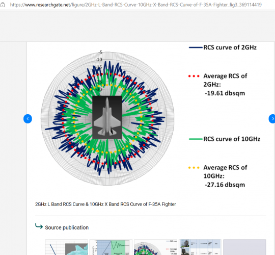

F-35 Joint Strike Fighter vs Russia's New Airborne Counter-Stealth Radars
''What if a fighter aircraft was fitted with a sensor system, which operates outside the radar frequencies where X-band stealth is most effective?
Shaping is a critical aspect of stealth design, since the facets and aligned edges in stealth designs bounce hostile radar returns away from the radar producing them. A stealth design shaped to beat X-band radars will lose effectiveness in the lower S-band, and become even less effective in the L-band, performance becoming progressively worse as the operating band of the radar is moved away from the design target X-band.
If a fighter, which produces a tennis ball sized radar return in the X-band, produces a basketball or beachball sized radar return in a lower band, a sensor operating in that lower band nullifies the stealth capability. The fighter built with “narrowband” X-band stealth is no longer difficult to detect and must fight it out using its aerodynamic capabilities alone.
Dr Carlo Kopp of Air Power Australia explored low band AESAs embedded in fighter wing leading edges in 2007 and concluded that this concept is operationally and technically viable. Study results were not published by APA, due to the potentially adverse impact – APA has a long standing policy of not publishing concepts that might provide potential adversaries with a competitive combat advantage.
However, unbeknownst to APA, Tikhomirov NIIP were already working on this concept for two or more years, and revealed the technology at the Russian MAKS 2009 Airshow this August.
The appearance of the first L-Band Fighter Radar is an excellent example of focused and intelligent lateral thinking which targets opponents' weaknesses. This is sound technological strategy and practice on the part of Russian industry.
While the NIIP L-Band AESA disclosed at MAKS 2009 might be considered a prototype, where the specific performance of this prototype might confer only a small combat advantage, the inevitable development of this technology confers long term and accelerating air combat advantages, both as a counter to specialized X-Band Low Observability and for the detection and disruption of sensors and digital communications systems that operate in the heavily used L-Band.
L-Band AESA technology is much cheaper to manufacture and test than X-band AESAs. Once in volume production, retrofit packages for legacy Flankers could be as cheap as US$1-2M. A likely configuration is a dual-band radar arrangement with an X-band AESA retrofit and new radar back-end, to replace legacy N001V and the N011M BARS series Flanker radars. For the new N035 IRBIS-E radar, the hybrid ESA antenna would be replaced by an AESA, and the back-end could control and process for both the L- and X-Band radar antennas.''
Now after we got some pretty valuable data and info about the multifunctional L-band AESA especially from the NPP Pulsar as the manufacturer of TRMs,we can recognise that Dr Carlo was confused by some wrong advartisments from the MAKS 2007 and 2009. As we all know ,multifunctional L band AESA was developed and constructed only for the Su-57 while IFF L band AESA was developed only for the Su-35S ( it is also integrated in the wingslats of the Su-30SM2). Also we know that prototype model of the multifunctional L band AESA ( known as N036L) was first presented on MAKS 2007 and that the model was tested in the period 2006-2008.
СЕМЕНИН С.Н., СОКОЛОВ И.А., ГОЛИКОВ И.В., ВАРЕЦА Н.В.: Основные проблемы создания ППУМ для АФАР L-диапазона
стр. 572-589, "Радиолокационные системы специального и гражданского назначения.2010-2012", Под редакцией Ю.И. Белого.-М.: Радиотехника, 2013
г. Москва
That detail was mentioned before....
БОРТОВАЯ ЛИНЕЙНАЯ АФАР ДЕЦИМЕТРОВОГО ДИАПАЗОНА
''В носке крыла можно разместить довольно протяженную апертуру длиной до 10λ, котораясможет обеспечить необходимое угловое разрешение в одной плоскости - по азимуту. Напрактике этого вполне достаточно, несмотря на отсутствие углового разрешения в плоскостиугла места''
Transl :
''A fairly long aperture of up to 10λ can be placed in the wing tip, which can provide the necessary angular resolution in one plane - in azimuth. In practice, this is quite sufficient, despite the lack of angular resolution in the plane of the elevation angle.''
It seems that L-band AESA with width of 10λ (240cm) was considered earlier. This is from MAKS 2009 .
''Новый радар впервые был представлен общественности на авиасалоне МАКС-2009. На ПАК ФА РЛС состот из пяти антенн: 1) АФАР Х-диапазона Н036-01-1, размещенная под носовым обтекателем, 2) две АФАР бокового обзора Н036Б и Н036Б-01, 3) и две АФАР Н036Л и Н36Л-01 L-диапазона в носках крыла, предназначенных для обнаружения и опознавания целей «свой-чужой». Также в состав РЛК входит универсальная вычислительная система Н036УВС.''
So instead of two 2.4m wide antennas they decided to integrate four 1.6m wide.
I wonder if @stealthflanker can give estimated radar target tracking performance based on the antenna size, modules used and power output with the GaN modules used for the L-band radar.
Doesn't have to be me. Like literatures are available. Accuracy in angle, range and doppler can be calculated relatively easily and then you can plot it as a function of range and SNR. The SNR in turn is from radar range equation.
Still, the hard part is to find the accuracy figure everyone happy with. Like Low band radar is typically for surveillance and to cue higher band to "verify" the presence of target in more accurate means and guide weapon. That's good enough. One only need to find the range.. if the detection range exceed one in X-band against say a "stealth" target then it's viable.
Now if one wish to be more specific is then one should find the required figure for tracking. That typically tracking function is defined to be achieved at PD-90 (range where probability of detecting "real" target and not False alarm is 90%) So your radar can keep tracking the contact at that range.
But there is also another criteria, which is the tracking accuracy in unit of Radians or Miliradians. One such figure can be found in K.Barton's "Radar Systems Analysis and Modeling" In part of Multifunction radar track.
As seen the book provide requirement of 0.7 Miliradians or in degrees would be 0.04 Degrees. It also shows that for tracking typically beamwidth of 1-2 Degrees or smaller are needed. Along with simple equation to estimate antenna size required (assume circular aperture tho). This is however rather tight requirement, i myself believe such accuracy are only needed for gunfire and command guidance with beamriding control laws. For fighter combat or early warning it would allow for more e.g say 4 Miliradian especially those doing BVR in excess of 100 km, might be too tight. Not including the errors coming from the environment (propagation error) etc.
The angular accuracy equation in turn can be found here, this is from "Radar Homing Guidance for Missiles" Which listed some good equations to use. There is a typo tho in relative error. the (sigma x (S/N)^1/2)) Should be (Sigma x ((1/(S/N))^(1/2))
S/N is Signal to Noise Ratio (SNR). Let's say a radar that can achieve SNR of say 30 dB (1000) and having beamwidth of 1 Degrees or 0.017 radians will have accuracy of (0.017*(SQRT(1/1000))) = 0.00054 Radian or 0.03 Degrees, pretty much "fire control grade" as per abovementioned literature. SInce SNR is also function of range, then one can plot the SNR and thus accuracy. resulting with this kind of plot.
Now one do that to an L-band one.
Before any mathematical calculation is carried.. (and again doesnt have to be me) Will everyone agree on 0.04 degrees and below as "viable" accuracy requirement ?
