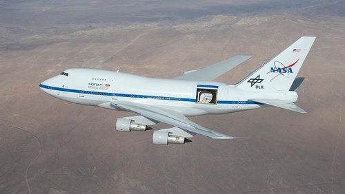

I want to see what they will do with the big bird. Hopefully it is not a caretaking / mothballing team... I want this thing to become a fire bomber (in your face, Evergreen 747) or a NASA high altitude astronomy platform (in your face SOFIA, who needs 747s, really ?)
I like the sound of the NASA high altitude astronomy platform. Though instead of replacing SOFIA I would imagine it working in a different wavelength altogether so they do not compete with each other.
Yeah my reference to SOFIA was rather tongue-in-cheek.
What I had in mind was the ER-2, were sensors on pallets are swapped according to the daily or weekly mission. Also the CV-990s used for Spacelab, the Learjets carrying small telescopes, and so many others platforms. NASA has a knack for that.

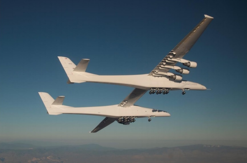

The Roc aircraft could do the same but on a huge scale. Build a huge pressurized pod and cling that under the central wing. Then into that pod put science instruments that can be swapped according to the mission. The usual business: above 18 000 ft the thick of the atmosphere is below you. At 45 000 ft, perhaps 80% of it. Imagine, when they stuffed a 2.7 m IR telescope into a 747-SP, they had to cut a huge window into the rear fuselage side. Compared to that, building a pod mostly independant from Stratolaunch own structure might be a little easier. You could build the pod from the beginning with a huge hole for the telescope - unlike a 747-SP fuselage which was not exactly designed by Boeing with such idea in mind.

Didn't they study using a pod for various purposes along the way? I seem to recall "large, outsized cargo" but there was mention of other pods for other uses... OH DEAR LORD IT'S THUNDERBIRD 2!

Unworkable. The wing and fuselage would block the field of view. Need a low wing aircraft.
Wouldn't or couldn't the pod extend forward and aft of the wing for a clear view?
Randy
You still have the fuselages to the sides.
Not to the rear and front though so you 'field of view' is actually more open. Less a 'hatch' in the side of the pod but more an proper observatory turret fore and aft, (or just one) which you can adjust to sight along the open lanes. You may have to fly "towards" or "away" but your field of view would be the same if not better.

If it's an astronomical telescope, having a central pod extending somewhat aft of the trailing edge with the tail cut off at a slant leaving a big upwards-exposed hole for the telescope to look up and out from would seema good solution. The airflow environent would seem to be - or at least could be made to be - fairly benign, and the view upwards would be quite clear. Simply point the tail of the aircraft at the target in the sky and fly "away" from it, and the scope could stare at the target probably longer than the fuel supply would allow.
