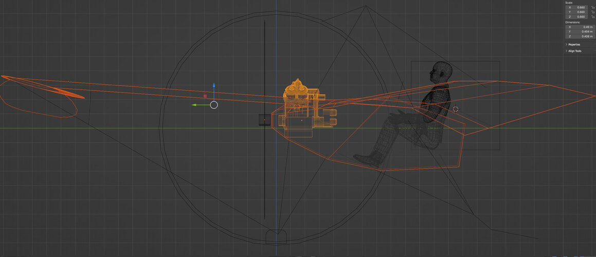

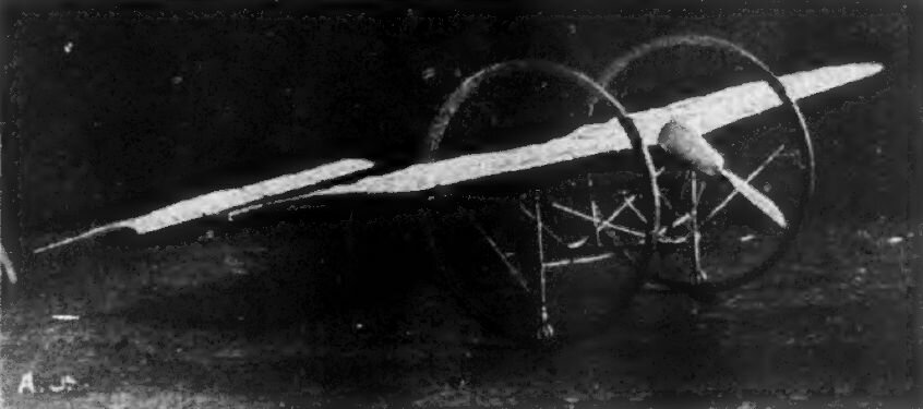

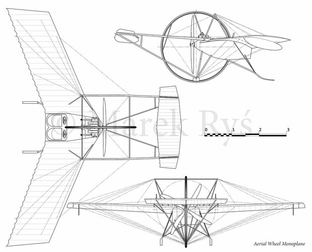

Since few days I tried to reconstruct strange monoplane of Aerial Wheel Syndicate. It was built in 1912 (but never flew) to compete in the Military Aeroplane Competition which was to be held at Larkhill. Exist one photograph and simple sketch of this plane. Problem is, that sketch (probably oryginal from patent, but didn't saw this paper) only a bit correspond with photograph.

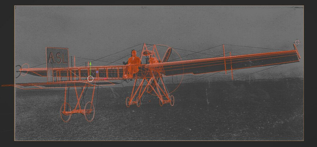

I tried to use some architect programs for dig basic shape and proportion from photograph, but unfortunatelly angle is not very friendly for this work. Here are mine effect for now (still at work) bit different from sketch.
Plane is described in few sources, but I'am not sure if airframe description is based on sketch - then it is not 100% right I think.
But I'am also not so succesful so far. There is not big deal to fit main wheel and propeler theoretical wheel - they fits well, but then many unfited elements start to appear after symmetry is turn on - left side fit, right not so. But still fighting.

Mine trials:

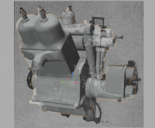

Second thing - engine. On oryginal sketch is four cylinder inline, but was used NEC 50 hp engine, four cylinder in V.

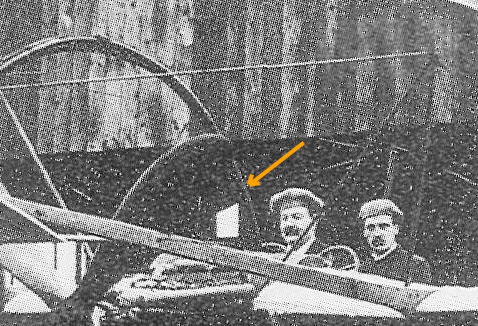

IMO, pilots are evidently just after wheel - it is visible on photo. I marked yellow arrow wheel edge. What you write is logical, but this plane was a bit ... strange:) Proble with this reconstruction was, that teheoretical lines along x, y, z axis, that should be paralel are not. Barn just after plane is correct when using only it for recon, but plane is tilted a bit in all axis. I think also, that structure was not 100% rigid, and some distortions were because of it.
There are two version of why plane was not flying finally: first is that it was so complexed, that its makers was late with asembling it after arrived in box (box dimensions were also defined by competition rules); second is that there was no pilot, who was ready for risk his life on... this :D Probably both versions are right :D

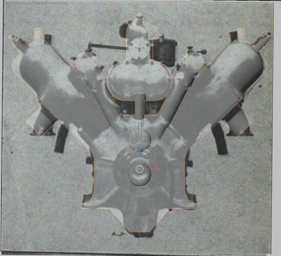

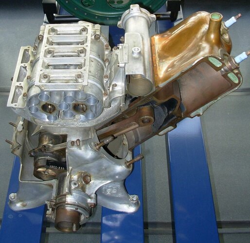

I made some new estimates - also engines. IMO NEC 50 hp V4 had about 620 mm lenght and 750 mm width. I count this based on this data for cylinder: 101 mm (3.976") bore, 115 mm (4.528") stroke. VERY simple, "blocky" model of engine, byt fit not bad in photo:
Next I put engine into plane model - pilots I used and fited to photo, as you can see in my previous posts gave me ability to estimate whole plane dimensions: lenght 6,4 m, span 8,7 m and main wheel diameter 2,53 m. "Official" data are 7,6 m for lenght and 9,1 m for span.

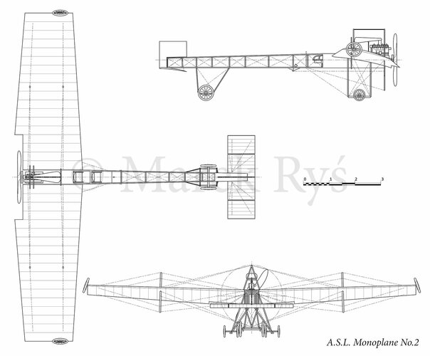

Another STRANGE Thing at workshop. A.S.L. Monoplane No.2, There is a bit mess with No.1 (pusher, tractor, canard, stndard, was not was, Barber's one, not A.S.L etc). but for No.2 exist two photographs only (as far as I know) so used them. Engine is Green D.4.

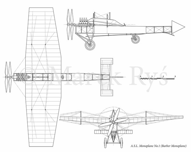

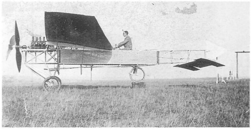

I have question about Horatio Barber's Monoplane (1909) built by Wright, and A.S.L. Monoplane No.1, which seems to be the same plane after Barber's attachement to A.S.L. as general director. It is what can be found in most sources. In this version of hisotry it was tractor monoplane with contrarotating, twobladed propelers (!) and was unsuccesfull - exist photograph. But I also found information, that Monoplane No.1 was canard pusher very similar to No.2. It is based on book Flying with the Larks: The Early Aviation Pioneers of Lark Hill by Timothy Brown (2013). I have not this book so cannot interprete it by myself, but feel, that it is misunderstanding and No.1 was really Barbers first plane. Maybe someone have this book and could enlight me a bit?

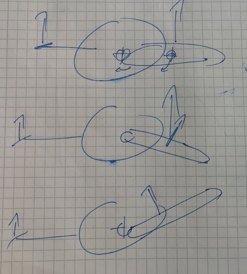

Have you explored the possibility that the wheel is also used for pitch? We can see that the wheel is embedded into the fuselage through a slot. Perhaps, in that slot, there is a mechanism to raise or lower slightly the cabin and attached wing.
The need for demultiplication would justify having such a big wheel that can then double down as a cartwheeling pylon.
Hence when the fuselage move clockwise, pitch is increased on the wing and the plane nose down (the entire airframe, not the fuselage that actually pitch up).
When the fuselage move anticlockwise, the wing pitch down, hence the aircraft nose up.
In that hypothesis, the CG is at the center of the wing with a deported forward canard and a close wing aero center to balance both lifting surfaces.
The major problem is that the sink rate is astronomical compared to the agility and reversed to the intended change of trajectory!
Pendular wings do that better.
Edit: Probably that the entire airframe is intended to move around the wheel. Or just the Canard. The wheel give demultiplication to the pilot.
Edit2:
Ah, stupid me.... Got it now.
The aircraft is balanced when the lift from the front plane equals that of the main wing.
Now, let's imagine that the center of the wheel is at the center of gravity, moving the rear fuselage along the wheel (no change of attitude) decrease the momentum generated by the lift (cosinus is decreasing), hence aircraft pitch up.
On the contrary moving the forward lifting plane along the wing generates a pitch down moment.
That's that simple.
I am not sure it's really practical with all the loads concentrated in sliding liaison and on the rails. But wow, that's a pretty original design worth the attention you poored in and, perhaps a restoration.
Congrats!

If I would build this airplane - I would agree with you. But I only tried draw what I see - not corect designers :) IMO - can be as you say, but we will never know, how far technical knowledge of creators reach. Without documentation we will never know. Shape I reconstruct is far from perfection also - the only photograph is not enough to do more correct reconstruction. The same is with A.S.L. Monoplane No.1, or Barber Monoplane. The only photograph almost perfect from side - what give ability to hand reconstruction but is not enough for digital test. Wire system would be close to No.2, I think.
For the A.S.L. Monoplane No.1,
Can you show us this photograph or the A.S.L. Monoplane No.1/Barber Monoplane ? Or can you show us a link to see this photograph ?
Thanks a lot @Schneiderman :)
@mrys :
When you say that the A.S.L. Monoplane No.1/Barber Monoplane was "unsuccessful", you mean it failed to fly ?

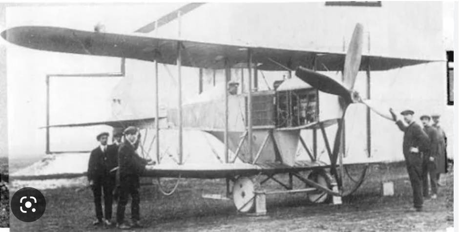

Does anyone know this plane ? (apparently it has contra-rotating propellers, see below)

That's the COW Biplane No11 second machine for the military trials. 110hp 6-cylinder inline Chenu engine with standard 4-blade propeller. No mention of contra
From "English Electric and their Predcessors"
"A four-blade propeller, made from a pair of superimposed two-blade propellers, was fitted, this somewhat unusual arrangement possibly arising from the transport and crating requirements of the Military Trials, although Manning may have considered the economics of being able to replace one two-blade propeller in the event of damage. The only other noticeable changes were the fitting of two short skids behind the undercarriage wheels and skids below the lower wingtips."
