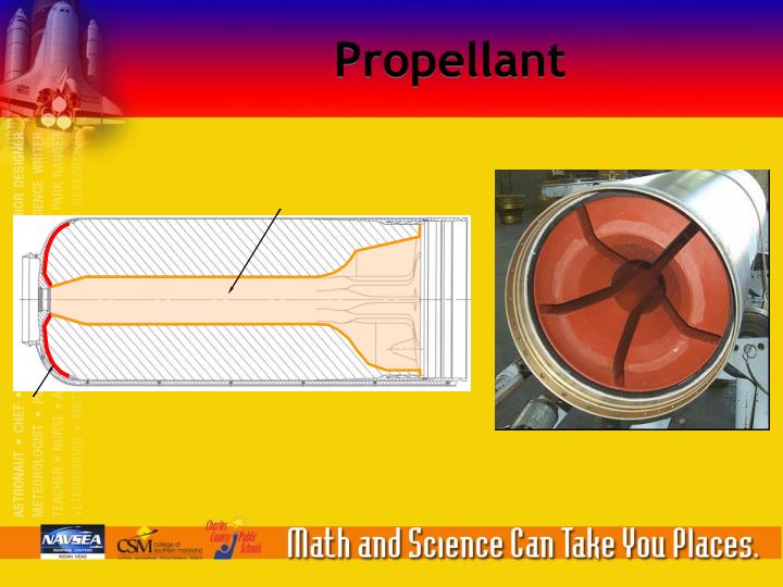

Dude is mistaking the total weapon weight pretty greatly. We've figured here that they're a ~1500lb edit: 1900lb weapon, not a 3300lb weapon. 3300lbs being the weight of a RIM-174B with booster. Not sure how heavy the 21" diameter Block 1B version is, but a back-of-the-envelope guess says that the Block 1B version (RIM-174C?) is going to be ~2.4x the volume, so 2.4x the weight wouldn't be out of line as the upper bound. But the electronics and apparently warhead are the same in the Block 1B, so 2.4x is probably high. 2x the weight is probably more accurate for the Block 1B.
And since the booster is 21" its weight won't change for the surface-launched stack weight, guesstimating in the neighborhood of 4800lbs 5600lbs for the Block 1B in surface-launch configuration. Frack, that's a big load!
So weight wise a Super Hornet could carry 6 of the 13.5" RIM174Bs, but probably wouldn't carry more than 4. 2x fuel tanks, 4x AIM174B, 2x AIM120 on the conformal stations, and 2x AIM9 on the wingtips. Centerline store could be the big Legion IRST pod or another fuel tank, depending on needs.

The 21" SM6 Block 1B is now likely to weigh some 3800lbs without the booster, and the total stack weight is likely to hit 5600lbs!
Block 1b uses a new diameter booster but the rest of the missile remains the same. Which means that the air launched version is not going to profit from it, as it can't use the booster.

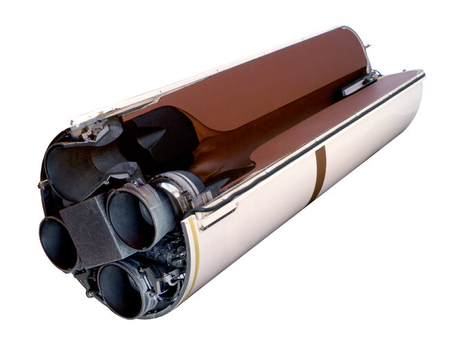

No? The Block 1b uses a new main engine which has now the same diameter as the
booster similiar to the SM-3 Block IIa engine. Its replacing the MK 104 DTRM and not the MK 72 booster.
Edit: the picture Shows the Change really good tought we don't know the final design.
The Mk-72 booster could be used for the AIM-174B if the missile was encapsulated in a 21" diameter jettisonible fairing with a Von Karman profile nose with a strong integrated into the fairing to mount the suspension lug to attach it to the launch pylon.
