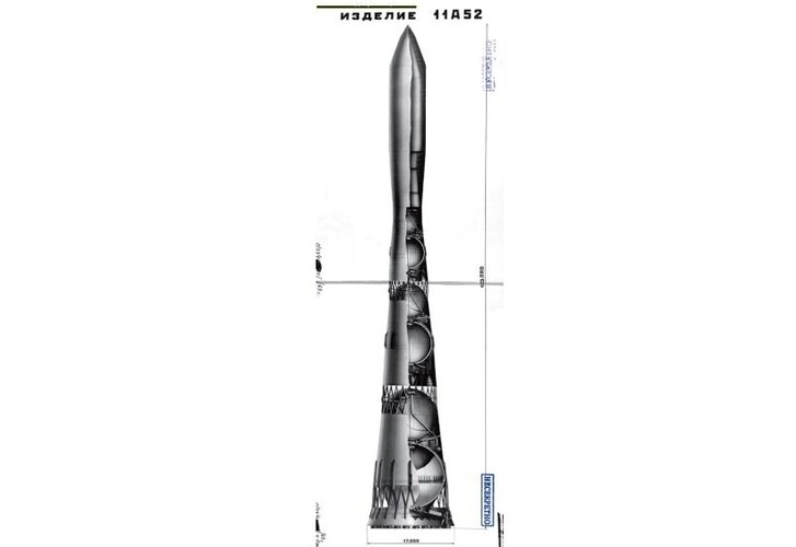

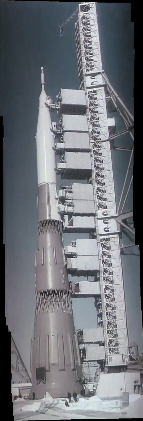

The launch tower leads one to believe that even taller LVs were looked at.
Even though I respect Glushko and Energiya (the RLA series was what he really wanted)--I do wish Korolev had lived and N-1 perfected.

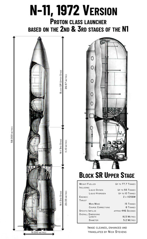

Yes, many versions with hydrogen upper stages and uprated NK-33 were studied that would have been taller; from basic Blok SR for the reworked early 70s lunar program View: https://x.com/RussianSpaceWeb/status/1759985183099359564
to much, much taller ones that would be more comparable to starship in size. Astronautix has some drawings but I'm not sure how accurate they are.

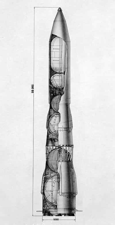

Just looking at the cutaway diagrams of the N-1 shows just how structurally inefficient its' design was.
