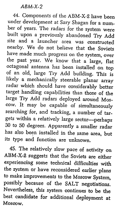

SOVIET STRATEGIC DEFENSES 11/2/1972
[Too much to type, please see attached picture.]
Note that the radar is "octagonal" and "little progress has been made".

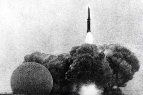

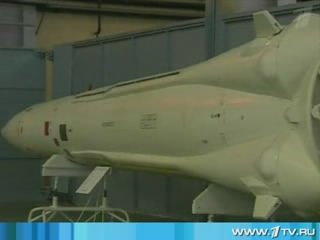

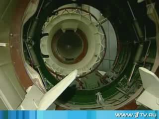

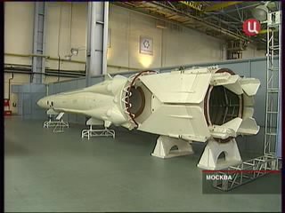

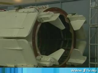

What's this? (Found from http://forums.airbase.ru/viewtopic.php?id=50559&p=3)
And SOC, I'm waiting for that GE locations file update. :)

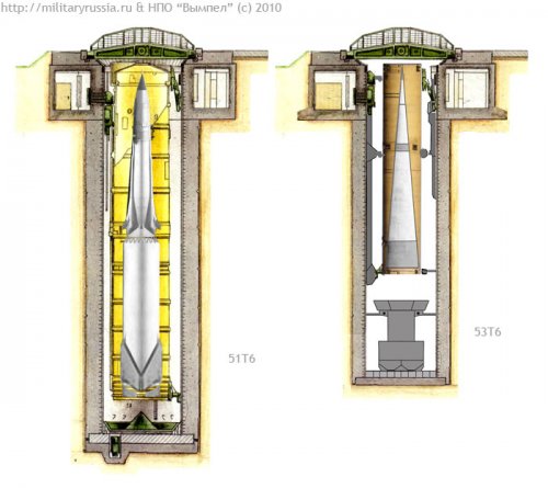

overscan said:
Possibly 51T6 missile from the A-135 system
Overscan, this missile is not 51T6, this is Fakel V-825.

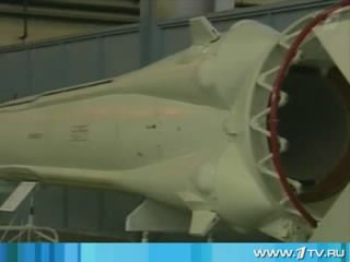

SOC said:

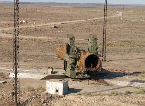

Here are some more ABM photos that haven't been posted.
GORGON first stage:
http://vk1.bmstu.ru/?module=photos&topic=1&pid=56
May be you mean GORGON second stage? :)

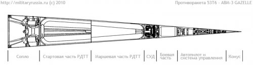

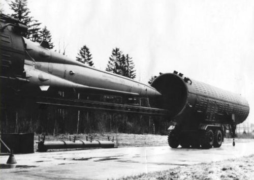

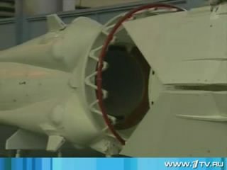

SOC said:
New systems: 45T6 missile, 55T6 missile (51T6 follow-on), and 53T6M (modified GAZELLE)
Fakel 55T6 is not 51T6 follow-on as you notice. 55T6 was the alternative project to Novator 5Ya26/PRS-1 missile for A-135 system and was canceled (circa 1984) in favour of Novator 53T6 design.
Thank you for visiting our forum ;) This is part of Novator 5Ya26/PRS-1 missile at Priozersk (as monument).

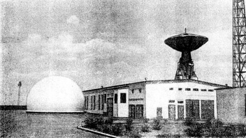

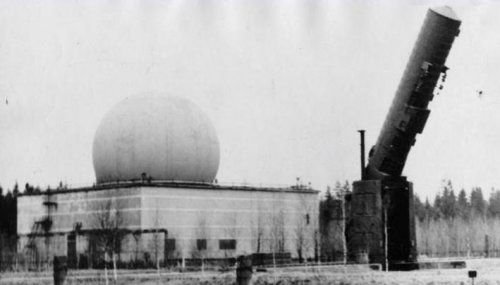

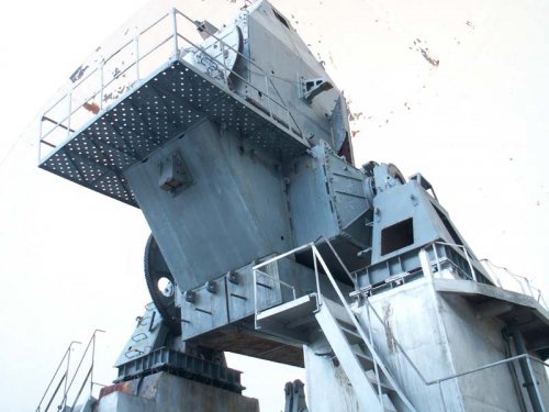

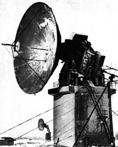

I have a question about Hen Nest and Hen Egg designation. To what radars they were assigned?
muxel said:
Important note! 5N25 Argun is designation for whole missile complex. The radar has designation 5N24/RKTs-35TA Istra.
Could you please clarify which missile complex this would be? Aurora?
Unless I'm mistaken HEN NEST was the RSV-PR missile acquisition radar and HEN EGG the RTN tracking radar of System A.
So can anyone tell us anything about the 45T6 missile?
As I thought...
I don't know what radar on your first picture, but on second and third pictures is RTN radars from the A system.

found some pics of the A-350 system

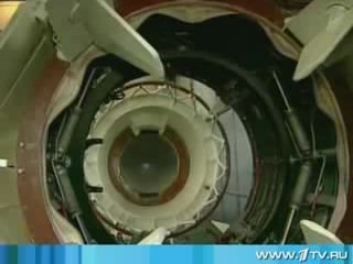

Here's a video report about Putin's visit to the Avangard missile plant last year, toward the end there's a detailed view of a 51T6 missile including its first stage:
http://www.1tv.ru/news/polit/125331
If only we'd see similar footage of the 53T6, by now we've seen enough 51T6 pics to last us a lifetime :-\
As for the mobile ABM radar, could this be it? Sort of a Green Pineski.
That's it, the MARS radar. The image I saw was different but it's the same radar. A concept at this stage I think, likely for the S-500.

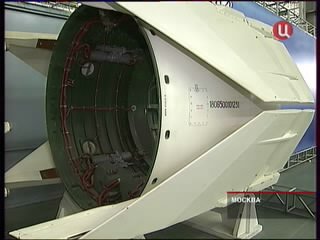

some 51T6 screenshots. note that first stage is missing some pretty much part of it

53T6 cutaway, A135 system launch silos reconstruction by DIMMI (www.http://militaryrussia.ru) with a little help of yours truly.
Sprint drawing used as spare parts.
Accordiing to those who saw real hardware, 53T6 looks pretty much close.

http://military.tomsk.ru/blog/topic-350.html
