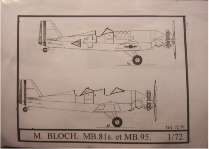

Thanks for the link with the drawing of the MB 95 Hesham :)

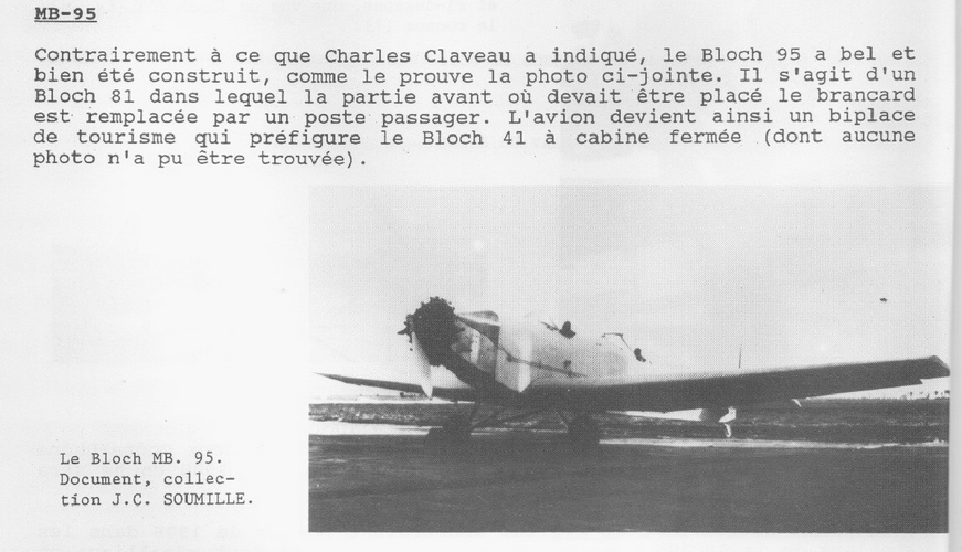

But I don't think that the TU speaks about the MB 81. Because MB 95 is a derivative of the MB 81, and (as said in the TU's article ) MB 41 is a "derivative" (foreshadow) of the MB 95.
The MB 41 is described as a "cabine fermée" (enclosed cockpit) in the TU's article. The MB 81 don't get an enclosed cockpit.
So
MB 80 --> MB 81 (one open seat and one enclosed bunk) --> MB 95 (two open seats) --> MB41 (x enclosed seats)

I think not,here is a proof from TU magazine 171.
Just a clarification: it's me who wrote this in TU magazine some years ago. From that time, I tried to look for the origin of this MB-95 designation, and finally concluded that it was probably a mistake, but I don't know from whom it comes.
A surprise,are you Charles Claveau ?,I find also this ?!,

No, I am Philippe Ricco. The text you have presented from TU magazine was a complement to Charle's chronicle about French manufacturers. I provided the photo to illustrate the 2-seater derivative from MB-81. More recently, I have published a history of MB-81 in Aéro Journal, with other photos showing this version modified in Syria.
I also provided some documents when Jean-Pierre Dujin designed this model. The plans were drawn by A.J. Roy.
