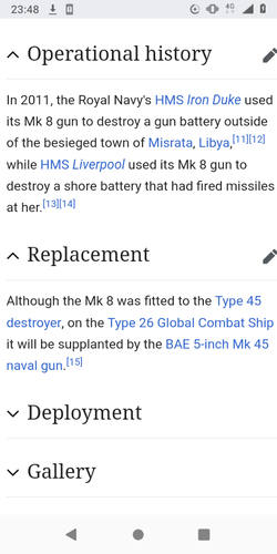

I fear post-Cold War you are right on gunnery. See attched fm Wiki.
