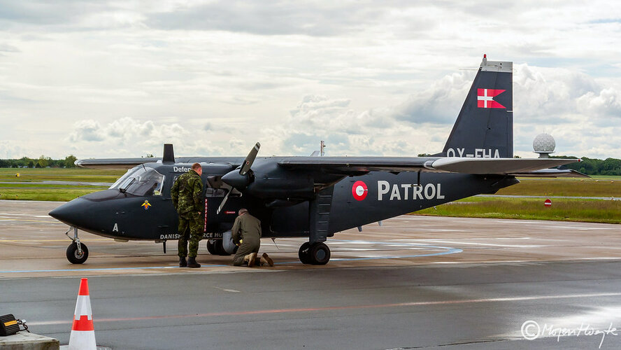

Armed Defenders have been used for COIN and/or anti-drug operations by quite a few countries. Here are a few: 3 x Belize Defense Force, Madagascar, 2 x Rhodesia, 3 x Mauretania shown with 8-cm SURA rockets and drop tanks or, possibly, gun pods. All taken from various web sites.
Two Defenders are used by the danish homeguard (Hjemmeværnet)
