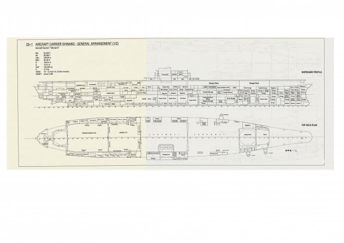

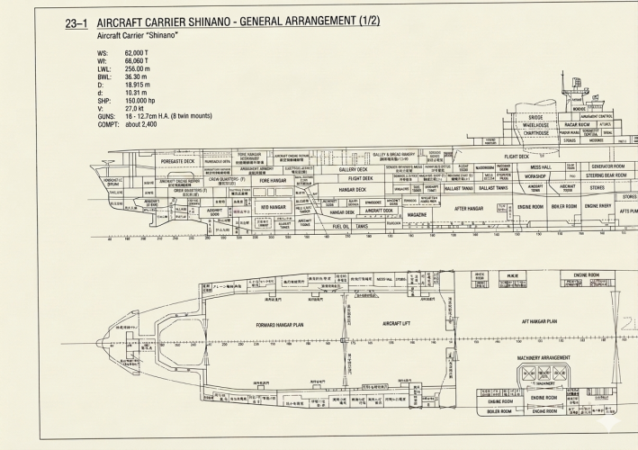

The practice in the armoured carriers of Britain, the USA and Japan in the case of Taiho, was that the flight deck armour covered the hangar area between the lifts. So with a hangar 164m long and with a width of 18-34m (from the drawing in an earlier post most of it looks nearer the latter than the former) that is an area of somewhere between 2,952-5576 square metres of flight deck to be armoured. Shinano had 3" of armour on her flight deck but that was AIUI laid on a backing of 1" of ordinary steel as in the Taiho. So that is a total of 4" of metal to be supported at some height above the main deck. At a rough estimate that is somewhere between 2,300-4,300 tons of metal depending on the hangar width being covered. Given my above comments about hangar width probably nearer the latter.
Then the question of hangar height. The hangars in Taiho were designed to operate the same types of aircraft as Shinano, had a clear height of 5m. That means that the c4,000 tons of flight deck in Shinano was carried 5m + the depth of the substantial beams to support its weight above the battleship upper deck.
Add a second hangar into the ship and you have to carry that c4,000 tons of armour another 5+ metres higher still. That has to have some effect on her overall stability.
