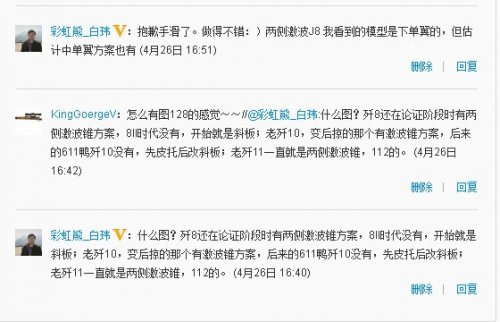

On both sides of J - 8 admission scheme sources Gu Songfen oral 《my plane design career》on page 112
Figure is my memoirs painted according to the designer, OK, do not seem authoritative source ~ ~
But to get Bai Wei confirmed that he claimed to have seen a similar model, but is low wing. And that the mid wing may also exist in
Deion , Baiwei Do you know?
Last year, I see your contact information in your blog, to give him contact you~

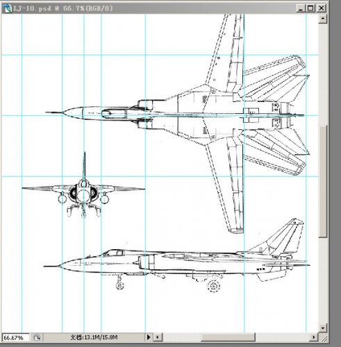

Hi Lion1984,
about the old J-9 fighter,it was a swing wing fighter and powered by two R-11
engines,I hope to get a drawing to this aircraft.
Unfortunately, the chief designer of the memoirs allow us to clearly understand the Chinese aviation industry for quite a long time to digest the Soviet legacy of darkness and chaos slowly forward in time. Of course, there are a considerable number of projects incomplete information during the Cultural Revolution, this is a pity.
J-8 developed to the J-8I to 80 years of development to the J-8II, not so much a technical problem the whole development is slow, as it is J-9, J-10, J-11's existence, a great little distracted R & D capabilities. J-8 as a very important Chinese Air Force planes were ranked in the final. If science is a little, if not the Cultural Revolution, if less ambitious · · · · · · J-8, and the 1968 program on both sides of the intake appears to be earlier than expected. ::)
Throughout the 1960s, after all, China is the enemy of the Soviet Union the United States, there is no formal channels to get technical. For an agricultural country for thousands of years, just basic support that point of the rapid development of industrialization and the aviation industry, too difficult ~ ~ and that even when manufacturing satellites, missiles and nuclear weapons :'(
What you say is the old J-10, there is currently only a CG figure, drawing my paintings, but I'm not sure what time of completion, I am not a professional, I tried to take the F-111 + j-8 to splice ~ ~Now drew these old J - 10 is a canard, I haven't painted

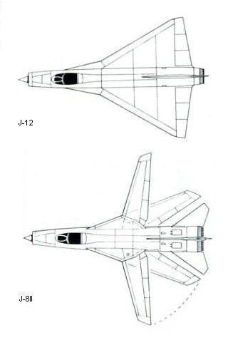

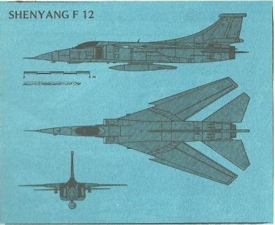

That's right Lion,
it is too hard to get a drawings to old China projects,here is a real drawing
to old F-12 or J-12 of late 1970s and early 1980s;
http://www.secretprojects.co.uk/forum/index.php/topic,679.msg99883.html#msg99883
This is more like MIG-23, in Chinese MIG-23 obtained from Egypt, China conducted a comprehensive research and mapping. Some network news that the Air Force intends to mimic the MIG-23's production on the Cultural Revolution, the only fighter to manufacture qualified Nan chang Aircraft Factory.
As Shenyang has not put fake MIG-23 No. J-12 is not clear :'(
There's a top and side view of your CG here in this thread. http://www.secretprojects.co.uk/forum/index.php/topic,679.msg51969.html#msg51969
Sorry guys, but either I'm completely wrong - and even more the CG's Bai Wei made for my book - but both this J-10 and the J-12 are simply fan-arts, nothing more. The J-10 was indeed planned as a swing-wing design in its initial stage but later converted to a MiG-25-delta-wing style type and the J-12 is nothing more than a joke, the true J-12 was a tiny bantam fighter similar in appearance to a mini-Mig-21 with neww wings.
Quite interesting, the J-12 swing wing design was taken over in the West when the first reports of new fighters under development appeared during the late 1970 and early 1980, but in the end, they were all J-9 and J-13 configurations, which were misidentified in the West.

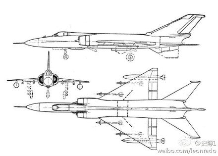

Also, according to the author of some of China's aviation history description, Shenyang order to accelerate progress, trying to use J-8 loaded variable sweep wing swing-wing program verification
Interesting! Although I would say your drawing looks more akin to the LTV V-507 or Dassault Mirage G8, than a F-111!
Regards
Pioneer

Dear Hesham, sorry but the model You describe never existed; it was only a what-if drawn at a time when the West barely knew anything about the CHinese Air Force, its industry and even more its aircraft types under development.
As far as I'm correct, this type You know is a "we expect to look like" image of the J-8 and similar models were at first described in a book called "The Chinese War Maschine". Here the Q-5 was shown for the first time - then mislabled as a J-6B - as well as two other types, which were reportedly under development, the first one a delta winged fighter called J-12A (= was in fact J-9) and the other one a VG-design, which were labled J-12B (= was in fact Q-6).
Sorry, but they never existed !
Deino

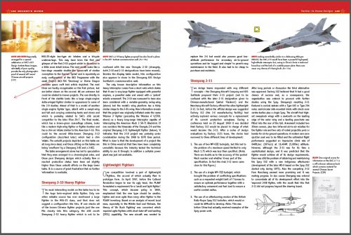

Thanks a lot and to admit this text about the J-10 I did not know (sadly it's too late for my book , which will go to the 'printer' in about two weeks), but I think all the info is included since bai Wei - please note the same artwork ! - was my main consultant for the book.
Do You have any more information regarding the also mentioned "No. 4" or "Mission 4" VSTOL-type ??
Best regards and thanks a lot,
Deino

Yes, at present domestic about the plan of reconstruction and senior researchers seem to only BAI WEI, CG models are made of him. Gradually, some of the other data to enrich and prove that the presence of these models.
"Mission 4" today, only 2 or 3 piece of text, mainly motor, fan, there is no figure. Fuel tank J-6 was the result of the "Mission 4"

New, Chen Ying Ming "Chinese aircraft encyclopedia" published in a number of projects screenshots, but no new about J-10,(old) J-11 (old)more introductions
All I got so far is this ....
There have been rumours about proposals, or perhaps better to say suggestions, for a V/STOL type aircraft. One known project was an engine study called the ‘Number 4 Lift-Fan’, which in fact was one of the first Chinese proposals for a turbofan. For some time nothing was known in regard to what type of aircraft this would be used for but recent research has revealed a concept known as the ‘Mission 4’ VTOL fighter which is shown on a commemorative wall at SAC’s No. 601 Design Institute. It shows close similarities to a small J-6-based design but, instead of having ‘lift-engines’ in the normal sense, it shows a propulsion system similar to that used in the 1960s by the American Ryan XV-5 Vertifan. The design reportedly had four lift-fan engines – two at the forward fuselage and two behind the wings in front of the tail – that would retract into a conformal pod underneath the fuselage. The stone wall ‘model’ shows only the two rear engines deployed, plus a nose intake and highly swept wings and empennage. The chosen engine was a variant of the WP-6 and the ‘Mission 4’ was considered as an operational type for use as a close-airsupport fighter and for the anti-tank role, but the design never left the drawing board.
Deino

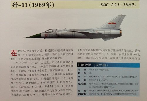

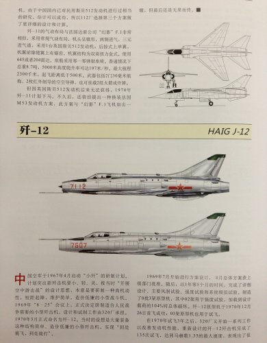

J-11,No new content
lion1984 said:
J-11,No new content
Ohhh this book seems to be a real gem !?? ... any idea where to get one copy ??? (and even more a translated version in English !)
Anyway, that's what I have for the J-11 (old) again via Bai Wei ...
Deino
ha ~ ~, a side view of the famous aviation artist Glen Chin painting, this book is currently too expensive, 4 BOOK,each of the 300-600RMB, :mad: without any particular information, so I did not buy it.
There are some figure not seen, if someone scans, I will occasionally posted over
In addition, J-11 seems to be the model which Mirage F-1 modified wing seems wrong.
