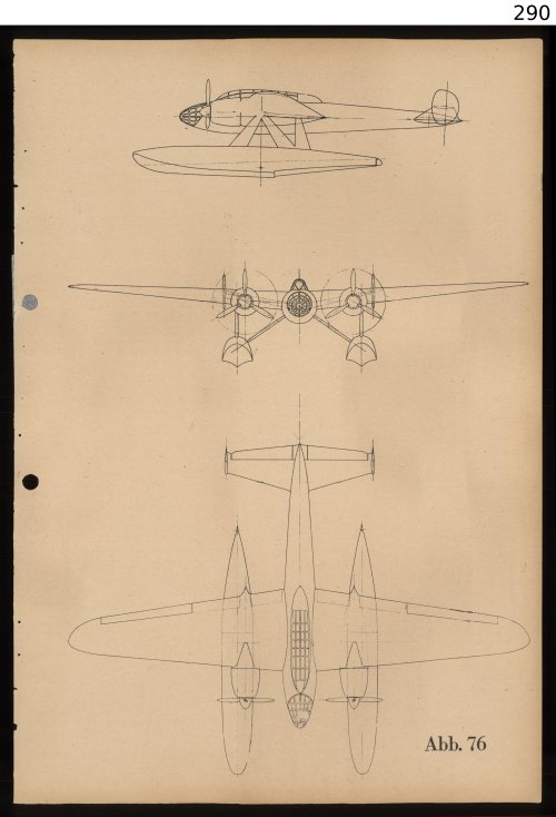

120S was a seaplane or flying boat Project,maybe developed from Type-110S ?
As in reply # 29,it was just a float seaplane version of Amiot-120.
The SECM 120 S (Spécial) is described in the clipping in reply #29 as "Raid". So, a long-distance record attempt aircraft. Photos of the 120S (modified 120-02 prototype) show it on the usual wheeled land undercarriage. So, not a floatplane variant.

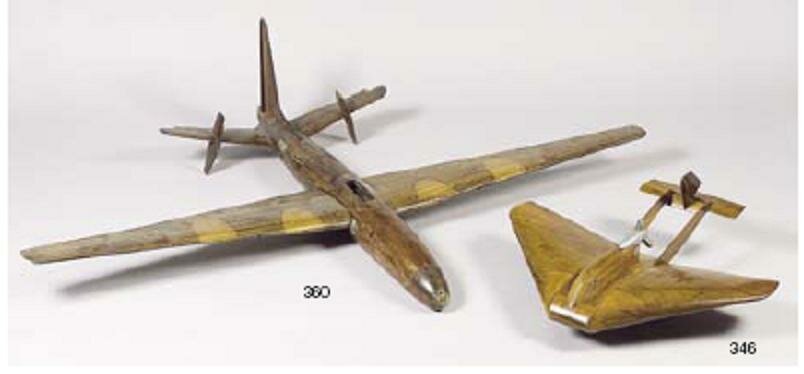

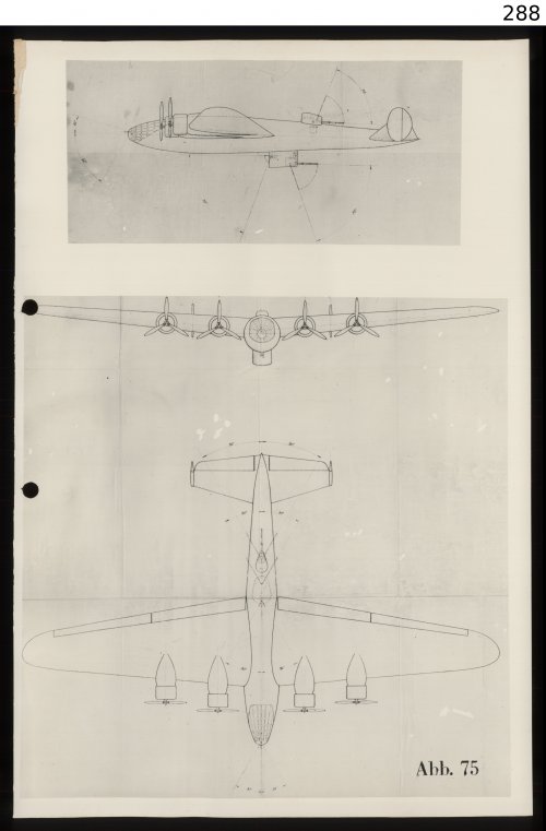

I think they meant this one,the Model on the right ?.
Those are two projects for Amiot,but they were not related to Amiot-540,
because it was just a wing configuration (not aircraft).
