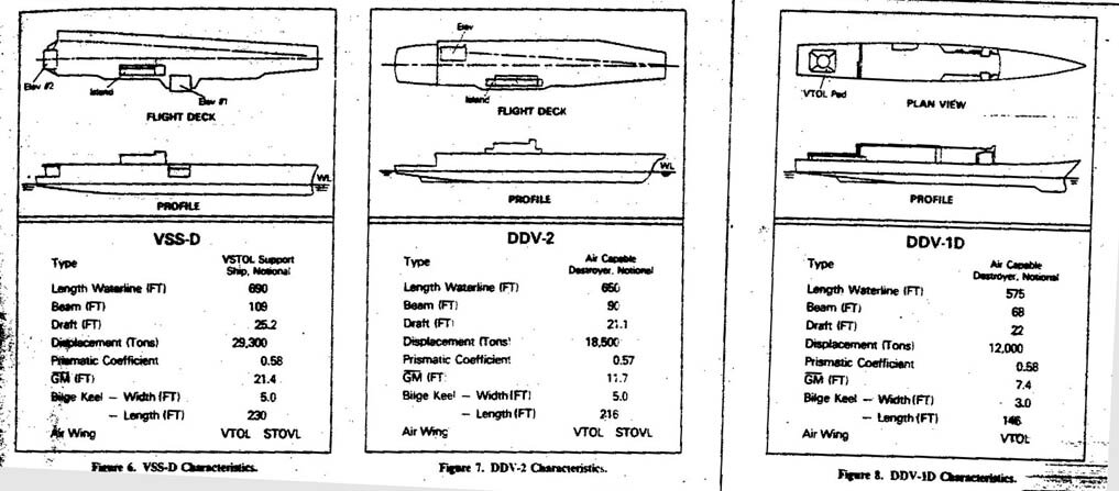

Also attached is the range of concepts that were under study as part of the Sea Based Air Platforms Project. Note the inclusion of VSS-D, this was a "hardened" V/STOL support ship and is the design shown here. There was also a feasibility study of VSS-D with a ski jump, I would assume 12 degrees, it would be great to find a drawing of that. The DDV concepts, certainly the Santa Fe DDV-1b, are probably here.
