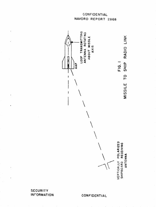

It simply wouldn't work on 1950s tech. The probability of radar even detecting something as small as shell was far too low. It would require conical scan radar to make several revolutions just to reliably be sure where exactly shell is.
A beacon in the base of the shell would allow it to be tracked even with a low RCS.

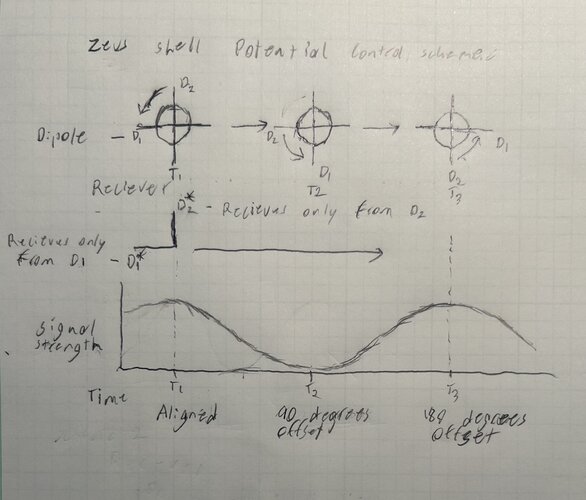

In a similar vein one idea I had for tracking the rotation was using two of the fins at right angles as dipoles (operating at different frequencies or with a different PRF or some other method to distinguish them) paired with two antennas on the ship also at right angles. When the antennas are aligned you get a maximum strength signal while when they're at 90 or 270 degrees with their paired antenna they have a minimum signal.
It's not perfect, at 180 degrees you'd also get a spike but if you have tested how many rotations it makes before signal acquisition you could possibly eliminate that 1/2 chance of triggering at the right time and thus have a system that works most of the time.
Additionally, depending on frequency used you could use these dipoles as your signal repeaters and then tracking their relative position (which one is higher, is one to the left or right of the other) you could have a far more certain way of determining orientation though this is dependent on the angular resolution of the tracking radar so with only a few inches between the two it would probably have to be done with something in X-band and preferably quite close to the firing ship.
Here’s a sketch I’ve done to illustrate the idea.
With a single dipole on the shell you can get a similar counting method but with two you can potentially get that initial orientation to aid the counting over an “informed” coin flip on the divert charge’s orientation.
Actually, now that I think of it there's an even more basic way to track orientation.
Have a single dipole on the ship and a single dipole on the shell.
On the ship there's continuous wave broadcast through the reciever dipole and from the shell dipole at the same frequency. When the shell dipole aligns at 0 degrees you get constructive interference, increasing the peaks. When the shell dipole is at 180 degrees you get a dip in the pattern from the destructive interference.
The issue is the timing of this. You have to be quite precise to make sure they're in-phase which would be a headache.
I'm just an amature with RF engineering so if someone who knows better has any ideas that would be helpful.

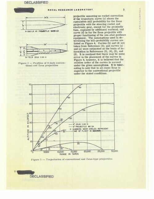

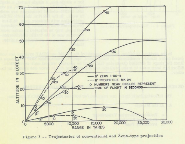

Someone recently just posted a deep dive on Zeus Arrow on TXitter.
View: https://twitter.com/MassiasThanos/status/1777715068576076049

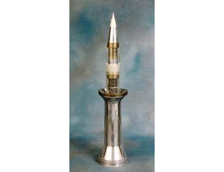

Turns out the navy did have Plans for a 5 inch launch version. With that being the actual ISSUE caliber and not 8 inchs.
And well... Its easier to list which classes of US surface ships that DID NOT have 5 inch guns then did.
Both the Albany and Long Beach did. So assuming that the guidence gear was small/light enough?
3 layers of guided defense are better then two, or one. Or None in the FRAMcans case.
Even with only 6 degrees of deflect capacity the US AA fire control of WW2 average around 4 or less so an ability to correct that will vastly increase the capabilities of 5 inchers against all aerial threats.
Rip picts attached for when the txits disappeared

https://apps.dtic.mil/sti/trecms/pdf/AD1214394.pdf
"A Comparative Study of XRAT and XRAM Guidance Systems Being Developed For The Angled Arrow Projectile"
May 23, 1950

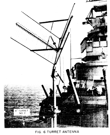

This dives into two methods they looked at to track the angular motion of the Zeus shells and their control mechanisms. These, as the title suggests, are XRAT and XRAM.
XRAM, standing for "experimental radar angular mirror" used a radar reflector, angled so that the RCS varies as the projectile rotates. This was tuned to S-Band and X-Band, the prior being used in radars such as the SP-1M radar which was used for testing of the Zeus and the later being common on fire-control radars such as the Mk-25 radar which was also used for early missiles such as Terrier.
The command link for the XRAM guidance system would be through this S or X band radar though by the wording of the paper it didn't seem like this had reached operational status. Another interesting factor was discussion of using a separate transmitter on the ship to detonate the VT fuze, potentially as a countermeasure to low reflectivity targets like the issues the U.S. had against Ohka Kamikaze missiles.
XRAT, standing for "experimental radio angular transmitter" was a bit more complex. The shell had a transmitter operating at around 160 MHz made out of a modified VT fuze. This transmitter would also act as the reciever for the command signal and they were also looking at using it as the VT fuze or possibly a radio-command detonation fuze similar to the XRAM proposal. That being said later it appears they at least experimented with S and X band transmitters, likely to reduce the amount of equipment on-deck.
The signal, and thus rotation of Zeus from the XRAT was picked up by a vertically polarized Yagi antenna through the modulation of the shell's signal and the commands were issued through a separate circularly polarized helical antenna. One potential mounting solution was to put the tracking antenna on-top of a turret to quickly aquire the projectile this was also looked at with the XRAM type guidance system possibly in a similar manner to the Mk 63 and Mk 64 GUNAR systems.
They also looked at guidance channel limitations.
With XRAM they looked at having one radar per turret so they could fire independently. They came up with a couple different solutions to the channel guidance problem. One was to have a so called "Bracket-Gating" method which, if I am understanding it correctly, would act like a countdown with command pulses opening sequential gates before a final pulse activated the divert charge. Each XRAM-linked radar was to operate around 100 MHz apart. Narrow beamwidth (around 2-3 degrees depending on type) would reduce the risk of interference between ships.
XRAT, as always, was more complex. Around 0.3 MHz of drift in the transmitter was experienced with firing so to reduce interference a 0.5 MHz channel separation was what they figured on for their calculations. The transmitter on the shell itself can be tuned through 17 MHz between 150 and 167 MHz, similar to fuze setting. They figured around 34 channels were available though several would need to be left unused for VT fuzes since XRAT reuses VT fuze mechanisms. In this concept each individual gun would have a dedicated channel (and reciever horn) compared to each turret in the XRAM system having a dedicated channel. Since there wasn't much directionality to speak of, interference between ships could be significant meaning those channels had to be shared over a formation.
