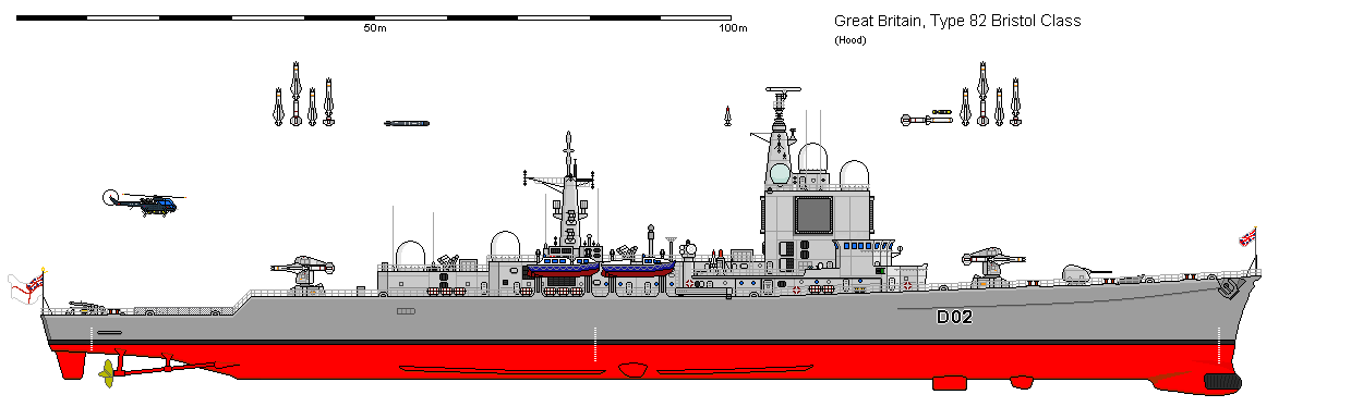

Another possibility might be the Stretched Type 82:
index.php
