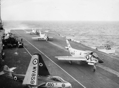

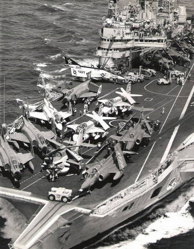

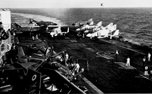

The RN attached great importance to "crossdecking" with US and other Western carriers. The attached pictures give some idea of what this looked like on Ark Royal in the 50s and 70s.
I suppose CVA01 in the 80s would have been able to crossdeck F14s.
Certainly CVA-01 had the potential to take the F14 in that her systems were rated to something around 75,000lb per plane and her recovery length was long enough.

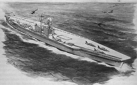

I always think this 1963 drawing of CVA01 which appeared in the addendum section of Janes showed what the Carrier Vessel Attack was hoped to be. It is much closer to a US carrier in appearance. The two types of jets allude to the fighter/attacker jets mentioned in Friedman.
Would need a bigger pic to confirm, but I think that the jets in that picture are representative of the OR 346, for which variable-sweep was proposed.
