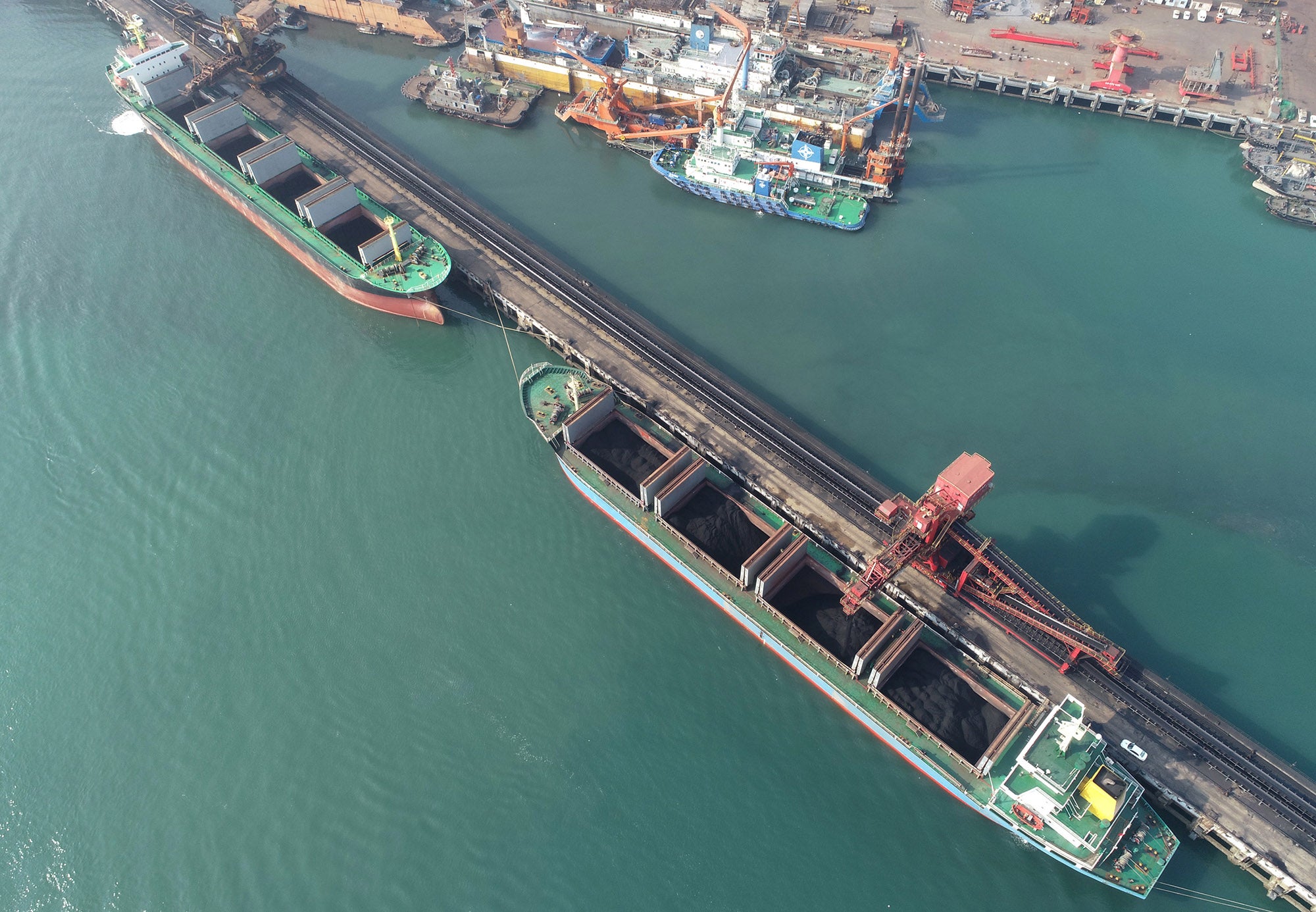

Had my 15-year old asking me questions tonight in regards to this AUKUS and the submarine issue....
He produced this article on his tablet
"He [Peter Dutton] said the Chinese are pumping out submarines, frigates and aircraft carriers at a record rate and so the rest of the world has stepped up its own production."
It's funny, because after our in-depth conversation, he said - 'If we're so worried Chinese pumping out submarines, frigates, aircraft carriers, tanks and combat aircraft at a record rate, why doesn't Australia stop selling China it's majority of Iron Ore, Aluminium and coking coal which they manufacture this threat!'
Regards
Pioneer
I thought Australia had stopped selling his coal to China - triggering the present feud between them ?
Did you say oil and Japan??
No, this - except I got it backwards.
It's China which stopped taking Australian coal in repraisals for the COVID critics.
