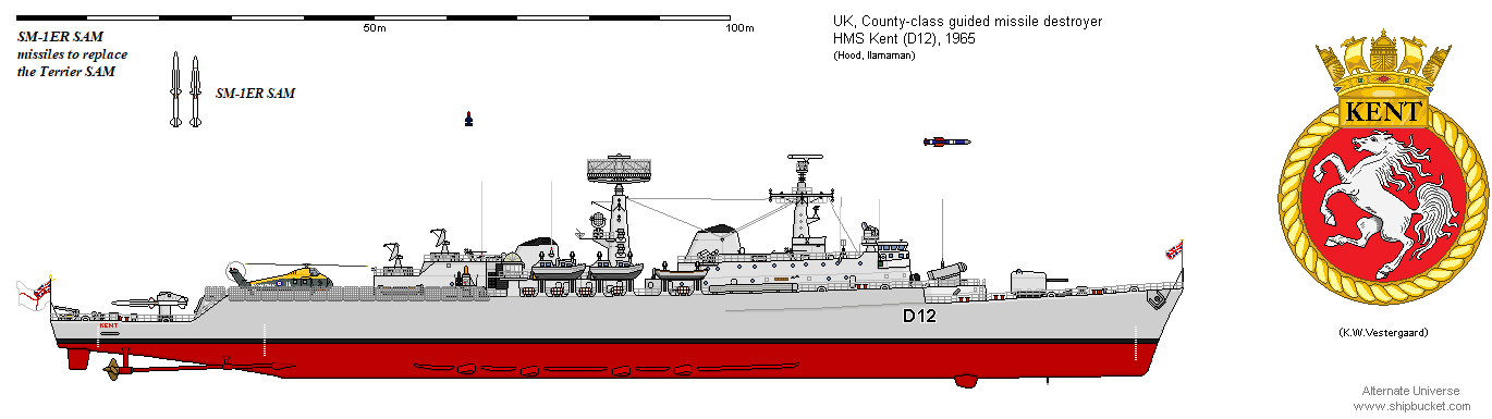

Double ended ships were already obsolete by the 80s so on reflection both my County Mod and T43 were dead ends. A VLS Seadart should have been developed or a successor system.
However, their role as area air defence ships means that they would always be.part of a task group including gun armed T21s.

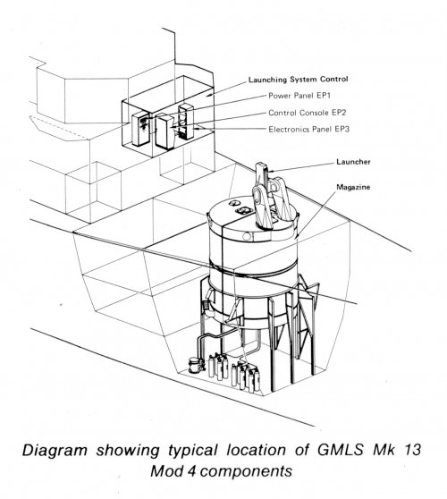

  • By accident or design the GMLS Mks 11 & 13 for Tatar could be made to fire the Standard MR missile and by accident or design the GMLS Mk 10 for Terrier could be made to fire the Standard ER (which was Standard MR plus a booster). The fantasy is that the British are able to work the same trick and design a new missile that can be fired from the magazine & launcher on the Real-County class.
  • It also turned out that the GLMS Mk 10 could be made to fire ASROC and the GLMS Mks 11 & 13 could be made to fire Harpoon. The additional trick that you didn't spot is that Ikara can be fired from the Real-County's Seaslug magazine & launcher, which I fully expect to be 100% fantasy.
The amount of thought I gave to the fine details of the design or for that matter nearly all of the broad details of the design was zilch. If the idea doesn't stand scrutiny, fair enough, because it was only a fantasy, which brings me back to the first sentence of this reply.

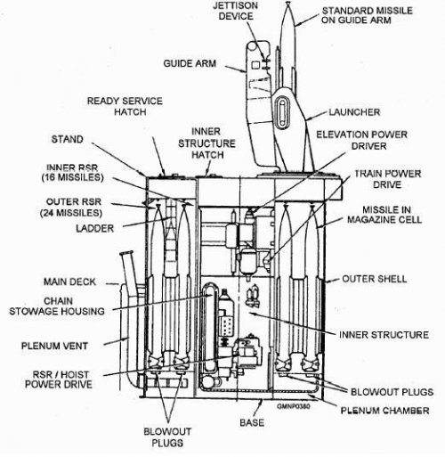

By accident or design the GMLS Mks 11 & 13 for Tartar could be made to fire the Standard MR missile and by accident or design the GMLS Mk 10 for Terrier could be made to fire the Standard ER (which was Standard MR plus a booster).
By design. Tartar evolved as a point-defence version of Terrier without the requirement for manual fitting of fins, and Standard was, if you like, a semi-clean sheet of paper design intended to retain compatibility with the same ships and launchers while improving performance and reliability. Terrier started out as a beam rider, while Tartar was SARH from the start and then Terrier followed not long before both were replaced by a common missile either with (ER) or without (MR) the booster.

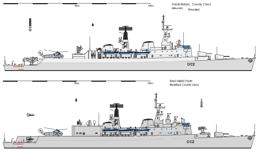

The three RAN Adams class destroyers were a much better buy. Though until Standard MR appeared they might not have been so effective at air defence.
The Type 82 could have been improved with a more reliable power plant and had four been ordered the design might then have been improved.

Interesting idea though the thought of handling Seaslug and Ikara rounds in the same space and with the same launcher, especially with nuclear rounds, could drive one to drink.
What inspired the idea was that the contemporary Mk 10 GMLS which could fire ASROC as well as Terrier & Standard ER. I think a County that could fire an A/S stand-off weapon as well as area defence SAMs would be a useful bit of kit.
I agree, but mainly on personnel grounds. According to my copy of Conway's 1947-95 the County class had a crew of 440-471 (which aught to be less with all GT machinery) and a Perth had a crew of 333-350. The Adams also had 2 tracking radars instead of one, but it didn't carry a helicopter.

On the RAN Counties, the RAN wanted a complete redesign and the RN responded that with the concurrent work underway there was no capacity to do this work. Industry on the other hand were more receptive, while the RN said they were happy to approve the construction of RN baseline Counties for the RAN, but also recommended the Escort Cruiser as a suitable option for the RAN. The US came in with a very attractive finance option that also helped them get over the line.
It actually turned out the RN was correct, the RAN wanted the smallest ship possible, too small in fact to meet its own requirements, the RN suggested that they needed a larger ship for the required helicopters as well as command and control capability. The County or Belknap would have been a better fit and the Escort Cruiser the best fit.
My point was that no one needs to convince the RAN to buy Counties... or to "make them more attractive to the RAN" - it is the UK that needs to be convinced to allow the RAN to buy them!
But the fact is that technically speaking, the RAN was asking for pie-in-the-sky.
Friedman has them asking for a “County” with Tartar, three Wessexes, two 4.5in mountings, twin Seacats, VDS, and all-steam propulsion(!)
On about 3500 to 4000 tons as well. They wanted a violation of every principle of naval architecture and some laws of physics.
I wasn't actually the RANs fault, they had very limited experience (almost none to be honest) in developing requirements or designing warships. Even these days the political classes, finance, contracts and project management types, with no practical technical experience have more say than the experts. They honestly believed smaller is cheaper to buy or build, that modified existing designs are less risky, that upgrades and modernisations are better value than new builds.
Part of the problem was they had, since their formation, relied on the RN to tell them what they needed. There was an assumption the RAN would maintain a suitable number of suitable ships to fill the RNs needs, initially as part of Empire then as part of SEATO and the Five Power Defence Arrangements. The move away from the UK to the US sphere of influence saw access to US equipment, but not the associated know how and depth of experience that had been part of the relationship with the UK.
The acquisition of the US designed and built CFAs was the driver for the RAN to develop and evolve their engineering capability. The level of this capability has ebbed and flowed over decades in line with political will and competence / understanding of its value.
The irony is developing and building a Tartar version of the Daring would have been within Australia's capability (with appropriate UK industry support), had there been the political will and sufficient funding. Building CFA DDGs let alone DLGs or Counties would have been too much of a stretch. I suppose in this was a Tartar Daring or Super Daring as envisioned by the RAN made sense, it's the multiple Wessex and limited displacement that was the killer.
In terms of a rearmed Counties, Australia lacked the expertise to go it alone, the RN said they didn't have the capacity, industry said they did. The only way this could have happened was if the RN had decided they needed a Tartar County.
A Tartar County is one of my favourite what ifs, but I realise it is unrealistic. In reality, even had the RN decided they needed it, the fact Tartar was a more compact system would have resulted in it being fitted to a smaller ship in a (probably failed) attempt to save money.
One thought that does come to mind is if the RN had adopted Tartar as a point defence missile instead of Seacat. I imagine a Mk-22 launcher with 16 missiles replacing the B 4.5" twin, Seacat of course deleted, freeing some space and weight for the rest of the Tartar system. This would free up Seaslug development to concentrate of the high-altitude mission, with Tartar looking to self-defence and anti-surface roles.
