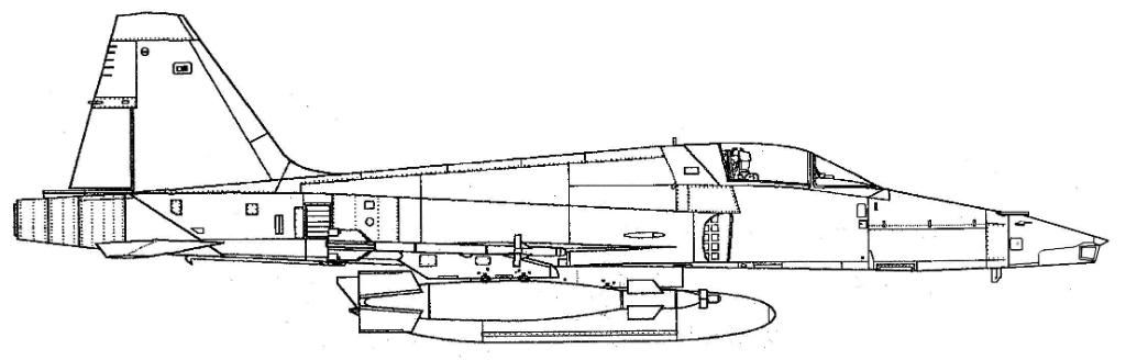

And yet a quick side-by-side comparison would imply otherwise:
Sepecat JaguarNorthrop F-5E
Powerplant2 x RR-Turbomeca Adour Mk.102 giving total thrust of 10,220 ibf (dry)/14,600 lbf (afterburner)2 x J85-GE-21 giving total thrust of 7000 lbf (dry)/10,000 lby (afterburner)
Gross weight10,954kg7,142 kg
Max Speed @ altitude1,669 km/hr (Mach 1.6) at 36,000ft1,741 km/hr (Mach 1.63) at 36,000ft
Thrust/Weight0.4220.4
Service Ceiling46,000 ft51,800 ft
Ferry Range3,524 km (with full internal/external tanks)3,720 km
Combat Radius with typical weapons load908 km1055 km
Take off Run580 m610 m
SensorsGenerally laser ranger/marked target seekerA2A Radar later upgradeable
Weapons2 x 30mm cannon
4500kg bombs/missiles
2 x 20mm cannon
3200 kg bombs/missiles
Now, I am not saying that the F-5 would be exactly equal to the Jaguar but it is remarkable how close they are and, as I said earlier, if the British and French went with the original requirement of the advanced trainer (field by T-38) with light attack capability (satisfied by F-5 for commonality), one could easily see this happen.

What is "typical weapons load" for each aircraft?
"More Buccaneers" is probably a good answer to "we need attack aircraft but don't want Jaguars"; the question may well be "the Treasury won't let us buy Jaguars; what can we get that's cheaper and, preferably, domestic?"
Buccaneers may be the best answer, but the Treasury's answer might be "Strikemaster," which would be horrible.
No I don't see Strikemaster getting Jaguar avionics and being cleared for WE.177 release.
Whereas Buccaneer is already cleared.
Jaguar has better payload/range capability than F-5E, and an even larger margin over the F-5A. It helped the UK out with a decent strike capability before MRCA came along.
T-38 + F-5 is probably a better answer to the original requirement however.

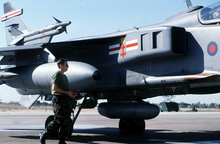

F-5E: 2x 20x102mm M39A1 with 280rds/gun, AIM-9s on the wingtips, 570/1040L drop tank on the centerline, and 4x 1500lb ish rated pylons under wing. The inner wing pylons were also plumbed for fuel tanks if you needed the ferry range or loiter time. Thai AF even put 2x GPU-5A 30mm gun pods on theirs. Total payload of 7klbs.
Jaguar: 2x 30x113mm ADEN or DEFA with 150rds/gun, drop tank or ECM or targeting pod on centerline, 4x under wing pylons. Total payload of 10klbs. (the overwing pylons weren't added until the 1990s)
Hrm. Jaguar has better guns, but loses 4000lbs of payload to carry any sidewinders for self protection, and another 2000lbs for a centerline drop tank. Jaguar's typical bomb load would be about 4000lbs, while the F-5E's is more like 6000lbs. Difference being that the Jaguar could carry 2000lb bombs while the F-5E could only carry 1000lbers.
Jaguar could be fitted with overwing pylons to carry Sidewinder or Matra 550 AAM. The RAF adopted it after Gulf War I but IIRC it had been available on Jaguar International for quite some time before that.
In the real world, the F-5E max payload is 7000lb, the 275 gallon / 1040L drop tank weighs about 2000lb for pylon, tank and fuel, so a 6000lb bomb load is not achievable with Sidewinders and a decent sized drop tank. 2000-3500lb is more realistic, and more often at the lower end if you want to fly a reasonable distance.
The wingtip Sidewinder pylons are useful, however, hence the overwing Sidewinder pylons fitted to the Jaguar from 1990.

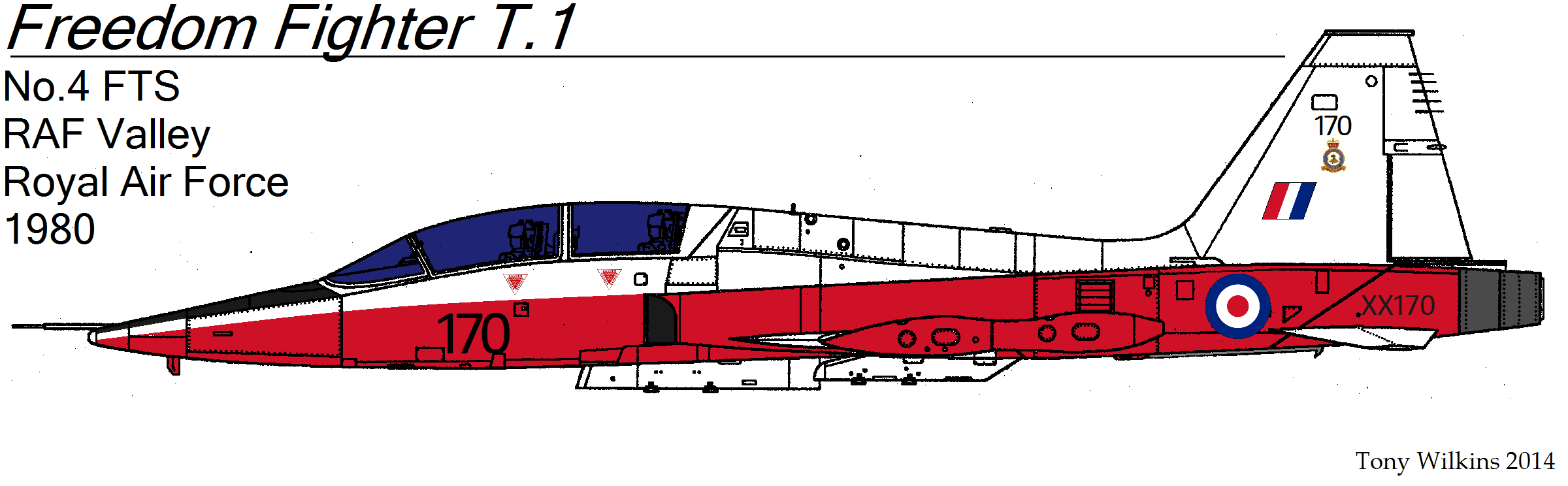

Well the T-38 was the template for AST.362, the Air Staff wanted something like it - but with VG wings (and possibly with V/STOL too just in case it wasn't ambitious enough).
The F-5 itself was of no interest it seems; it doesn't crop up in the files as an inspiration like the T-38 does.

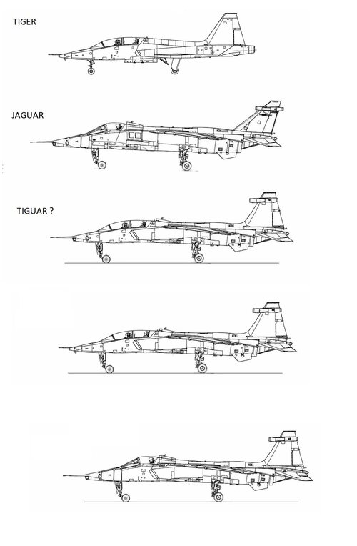

And guess what ? this is the very "mission creep" that affected the Jaguar. At the beginning it was to be a strike trainer, very ironically like the German Alphajets or... the Hawk 200. Except with a supersonic dash capability. Nowadays, South Korea A/T-50 nailed it. Back in the day, so did Northrop with the N-156. But Jaguar got some serious RFP / mission creep, direction MRI, to the point that the final Jaguar E (the two seater) could no longer be a T-38.
Typing this, I wonder if the N-156 escaped that fate because the J85s had limited power. The aircraft couldn't be made too heavy for strike, and this probably saved Northrop and the F-5A/E. It remained light and agile enough for air combat, but let's face it: the F-5 sucks for strike: not enough bomb, not enough range (if any range at all).
Northrop did a better job that SEPECAT. Working from the same basic requirement (T-38: supersonic trainer) they kept the "combat aircraft" away from strike: only dogfight.
Where it gets really interesting is: whatif Sud Aviation had won ECAT with a N-156 licence from Northrop ?
"There is your ECAT. Can do supersonic training, can do air combat, but only limited strike."
Somewhere on this forum are Sud Aviation F-5s lookalike, 1965...
How about a Sud Aviation enlarged N-156 with a pair of Adours ? Somebody should really kitbash a Jaguar / T-38 hybrid...
Hey folks, remember "Bruce almighty" ? They're a new breed. Cross-pollination between tulips and daisies. I call them... tudaisies.
This is a new breed of aircraft. Hybrid between a Tiger and a Jaguar. I call it... a Tiguar

But T-38s or F-5F two seaters would definitely be better for the original plan of the aircraft.

I knew I had this elsewhere.
What's the point in inventing ECAT when
a) Northrop already made it with N-156 ?
b) Sud Aviation is willing to take a licence and improve the design ?
And, on top this... what is an enlarged F-5 with a pair of Adour engines ? or a single M-45 ? Answer: a proto-F-18 and a proto F-20... unbelievable !
Just think about it. By adopting Northrop N-156 for ECAT (via Sud-Aviation, later Aérospatiale) the anglo-french ends, not with a half-failed Jaguar, but F-18 and F-20 look alikes... by the beginning of the 1970's !
Well maybe I went a bit too far talking about P-530 / F-17 / F-18. Ching-kuo might be a better comparison: those F-125s are similar enough to the Adour, India considered swapping them in their Jaguars... :D
Something similar I did years ago - mine is much more subtle though:
