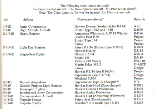

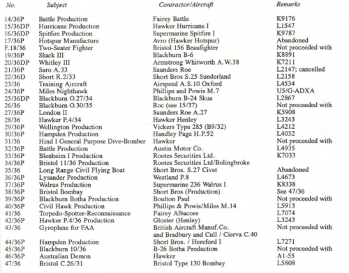

RAF Specifications for Aircraft from 1920 to 1949

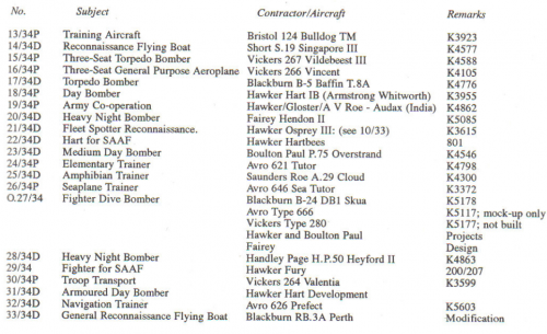

And for the year 1934;

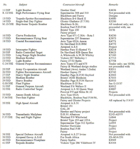

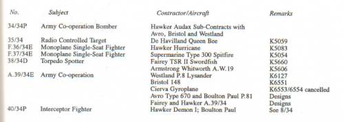

And for the year 1935,with some additions;
M15/35E ship-borne torpedo bomber, also Vickers and Handley Page submitted a proposals
F9/35E day and night fighter, also Vickers involved
G24/35E general purposed recce, also the Boultom Paul P-86 was in
F35/35E high speed aircraft, also Martin Backer entered
F37/35E day and night fighter, also Supermarine Type-313 purposed

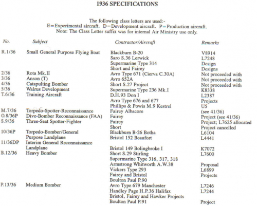

And for the year 1936,we can add;
B.12/36 heavy bomber, those companies and designations were involved, Avro,Blackburn,
De Havilland,Gloster,Hawker,Saunders Roe,and Armstrong Whitwoth
AW-42
P.13/36 medium bomber, also Shorts and Vickers Warwick

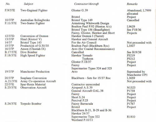

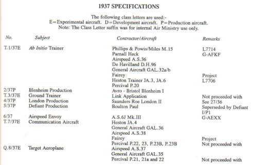

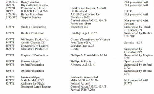

For the year 1937,there is some additions;
F.11/37E two seat turret fighter, also Supermarine 319 was involved
F.9/37E two engined fighter, also Bouton Paul P.89 was in

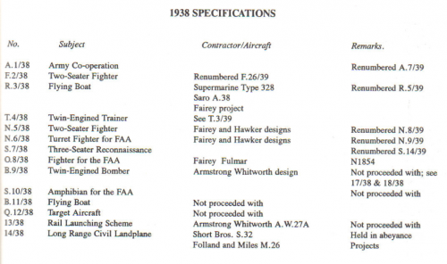

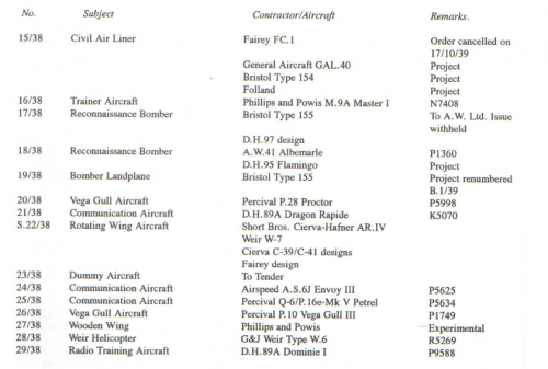

And for the year 1938,with some explanations;
B.6/38 twin-engined bomber; the Armstrong whitworth was AW.41
15/38 civil air liner; the Folland proposal was Fo.106

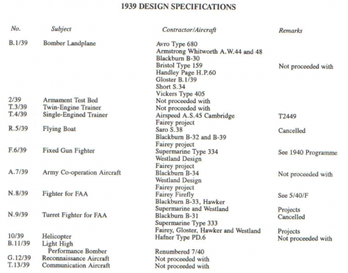

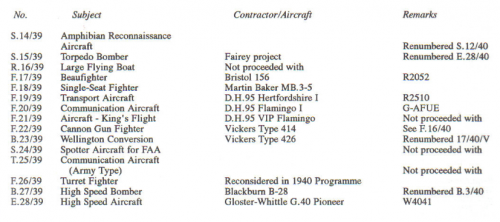

And for the year 1939,one addition;
B.1/39 bomber landplane; also Fairey submitted a proposal

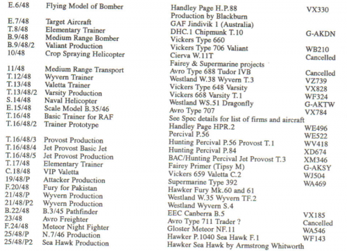

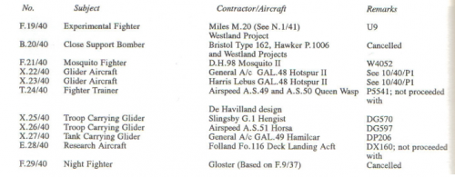

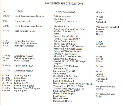

And for the year 1940,with some explanations and additions;
B.1/40 light recce bomber; also Folland Fo.113 & Fo.114 were involved
B.3/40 light recce bomber; Blackburn B-28,Avro-681 & Avro-682 and Armstrong Whitworth AW.47
F.4/40 high altitude fighter; Supermarine-337 was in
B.20/40 close support bomber; also Boulton Paul P-95 and Armstrong Whitworth AW.49 were submitted
E28/40 research aircraft; Folland Fo.115,Fo.116 & Fo.116A

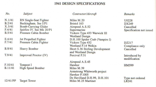

For the year 1941,with one addition;
N.1/41 RN single seat fighter; also Percival P.33 was involved

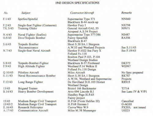

For the year 1942,there is some additions and explanations;
E.5/42 Gloster Halford Fighter; the Westland proposal called J.15
F.6/42 single seat fighter; Hawker P.1018,P.1019 7 P.1020,Boulton Paul P.98,P.99,P.100 & P.101Folland Fo.117,Miles M.42,M.43 & M.44,Airspeed,Supermarine,Vickers and Westland J.14

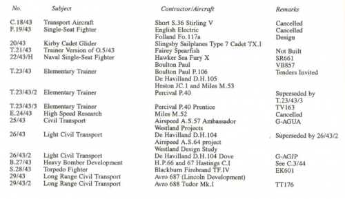

For the year 1943,with some additions;
F.19/43 single seat fighter; also Folland Fo.118 was in
26/43 light civil transport; also Airspeed AS.63 was involved
Hi All...
O.5/43 also Cunlife-Owen and Folland Fo.119 projects
S.6/43 also Cunlife-Owen and Fairey S.6/43 projects
N.7/43 also Fairey project
Q.10/43 may be Miles M.50?
S.11/43 also Blackburn and Fairey S.11/43 projects
My dear AM,
you are right,I forget them,but for S.6/43; I never heard that Cunlife-Owen involved in it.

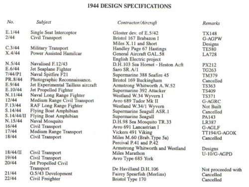

For the year 1944,with some additions;
18/44 civil transport; also Miles X.15 and De Havilland proposal were involved

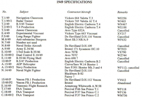

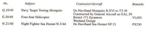

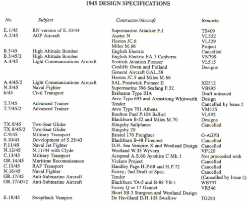

For the year 1945,with some additions and explanations;
A.2/45 AOP aircraft,the tenders were; Scottish Aviation,Heston JC.6,Miles M.66,Auster Type M & Type N
6/45 civil transport,the tenders were; Armstrong Whitworth,Avro-690,Avro-692 & Avro-693
T.7/45/2 advanced trainer; also Boulton Paul P.109 was in
E.20/45 four seat helicopter; also Fairey submitted a proposal

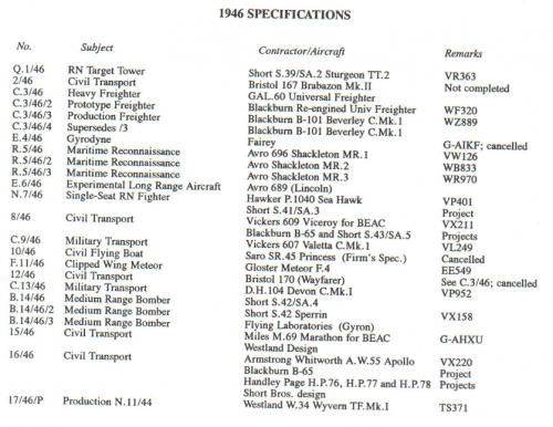

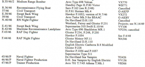

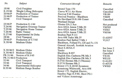

And for the year 1946,with some additions;
N.40/46 RN night fighter; also Westland PJD-142,PJD-143,PJD-144 & PJD-129
F.43/46 RAF day fighter; also Martin Baker MB.6

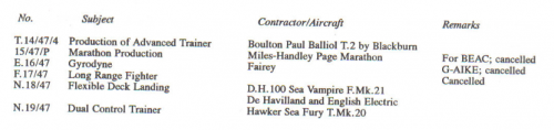

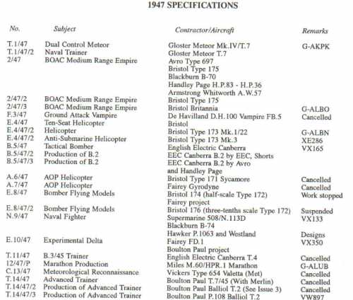

And for the year 1947,with some additions;
2/47 BOAC medium range Empire; the tenders were; Avro-697,Armstrong Whitworth AW.57,
Bristol Type-175,Blackburn B-70 and Handley Page HP.83,
HP.84,HP.85 & HP.86

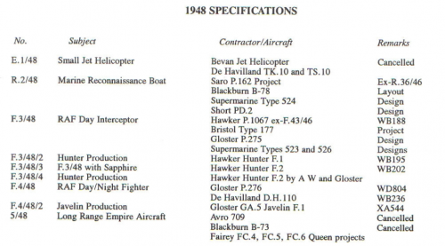

And for the year 1948,with some additions and explanations;
R.2/48 marine recce boat; also Saro P.104 was in
F.4/48 RAF day/night fighter; also Blackburn B-95,Hawker P.1109,Gloster P.272,P.279 & P.280
5/48 long range Empire aircraft; also Avro-708 and Shorts SA.8
T.8/48 elementary trainer; also Boulton Paul P-112 was involved
T.16/48 basic trainer for RAF,the tenders were; Avro-714,Airtech,Air Service Training,Auster AOP A.9,
Blackburn B-80,Boulton Paul P.115 & P.116,Chrislea,De Havilland,English
Electeric,Elliotts EoN 2,Fairey,Folland Fo.132,General Aircraft GAL-?,Heston,
Handley Page Reading HPR.2,Miles,Percival P.56 Provest,Planett,Slingsby,
and Westland
T.17/48 elementary trainer; also Percival P-66 and miles M.59A

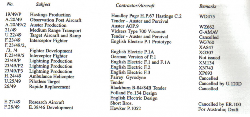

And finally for the year 1949,with some additions and explanations;
A.20/49 observation post aircraft; the tenders were, Auster B.5 AOP,Percival P.68 & P.69
26/49 Rapide replacement; also ML Aviation,Scottish Aviation,De havilland DH-114,Westland PJD.203
and Shorts were involved
