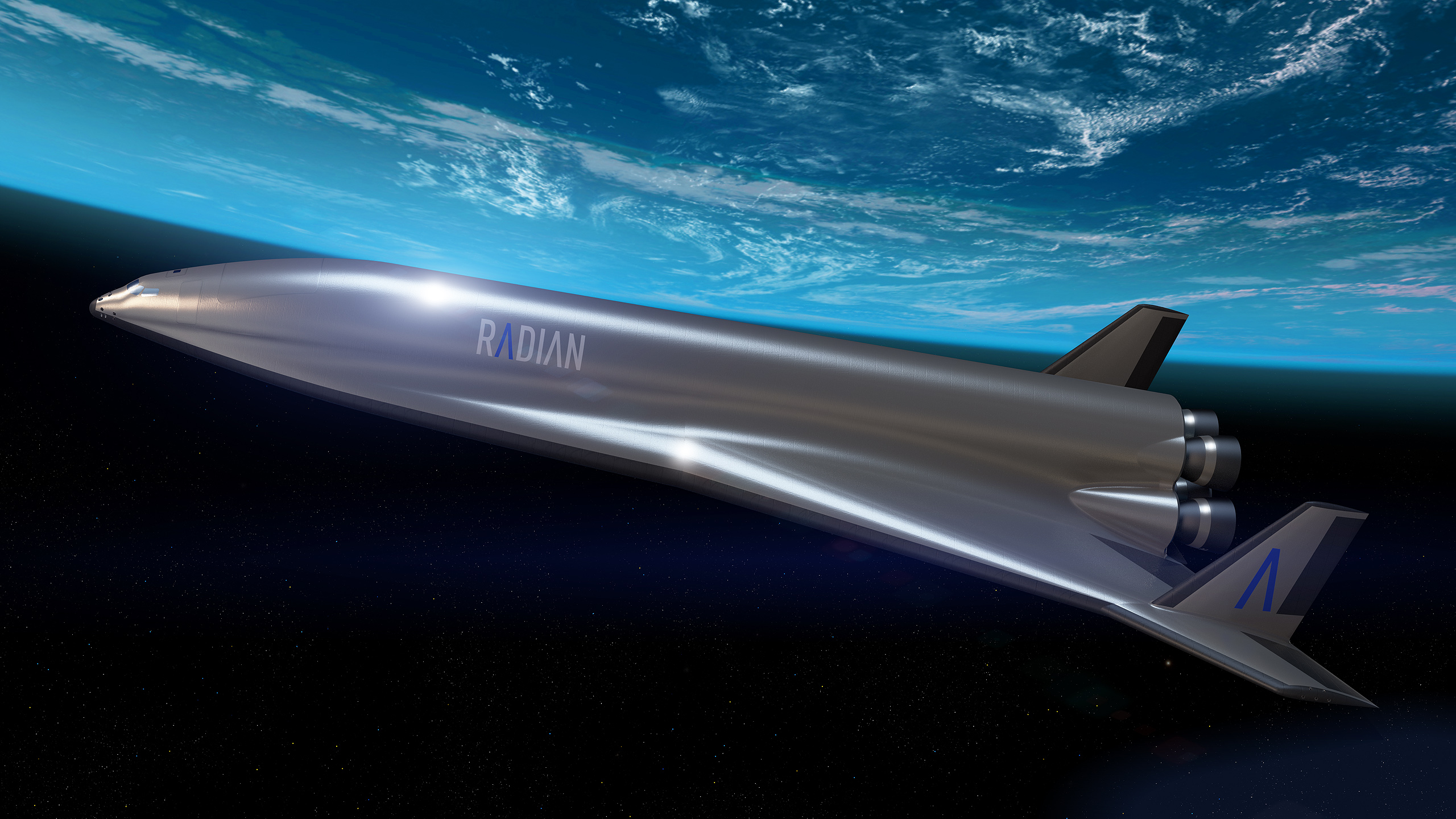

Ok so
-they plan to use methalox. SpaceX claims they can get a specific impulse of 375 seconds, which is pretty high for a non-LH2 propellant combo.
-And then there is the sled up to Mach 0.7. This should scrap 1000 m/s out of ascent to orbit delta-v.
These two elements make Radian SSTO slightly more realistic.
Dumb math
9.81*375*ln((100)/(10))+1000 = 9470 m/s
So
-orbit, maybe
-except with zero payload
-and a propellant mass fraction of 0.90 which will be no picnic for a winged SSTO.
-Boeing built a section of RASV hydrolox tankage, propellant mass fraction 0.88 in 1983 for DARPA HAVE REGION
Dense propellants like methalox can drop ascent to orbit delta-v to 9124 m/s (from the attached document)

I get 1 ton of payload to
9.81*375*ln((100+1)/(10+1))+1000 = 9156 m/s
Conclusion: as usual with SSTOs, payload and even orbit are on the ragged edge, it takes very little to wipe out both.
  • nsto.pdf
With the above caveats, I still think Radian is worth trying. A daring and bold atempt at SSTO, using SpaceX breakthroughs in methalox rocket propulsion.
When non-hydrolox, every single second of specific impulse makes a difference. Before SpaceX the highest non-hydrolox isp was the Russian kerolox RD-0124 at 360 seconds. Raptor pushes that to 375 seconds, a non negligible gain particularly for SSTOs.

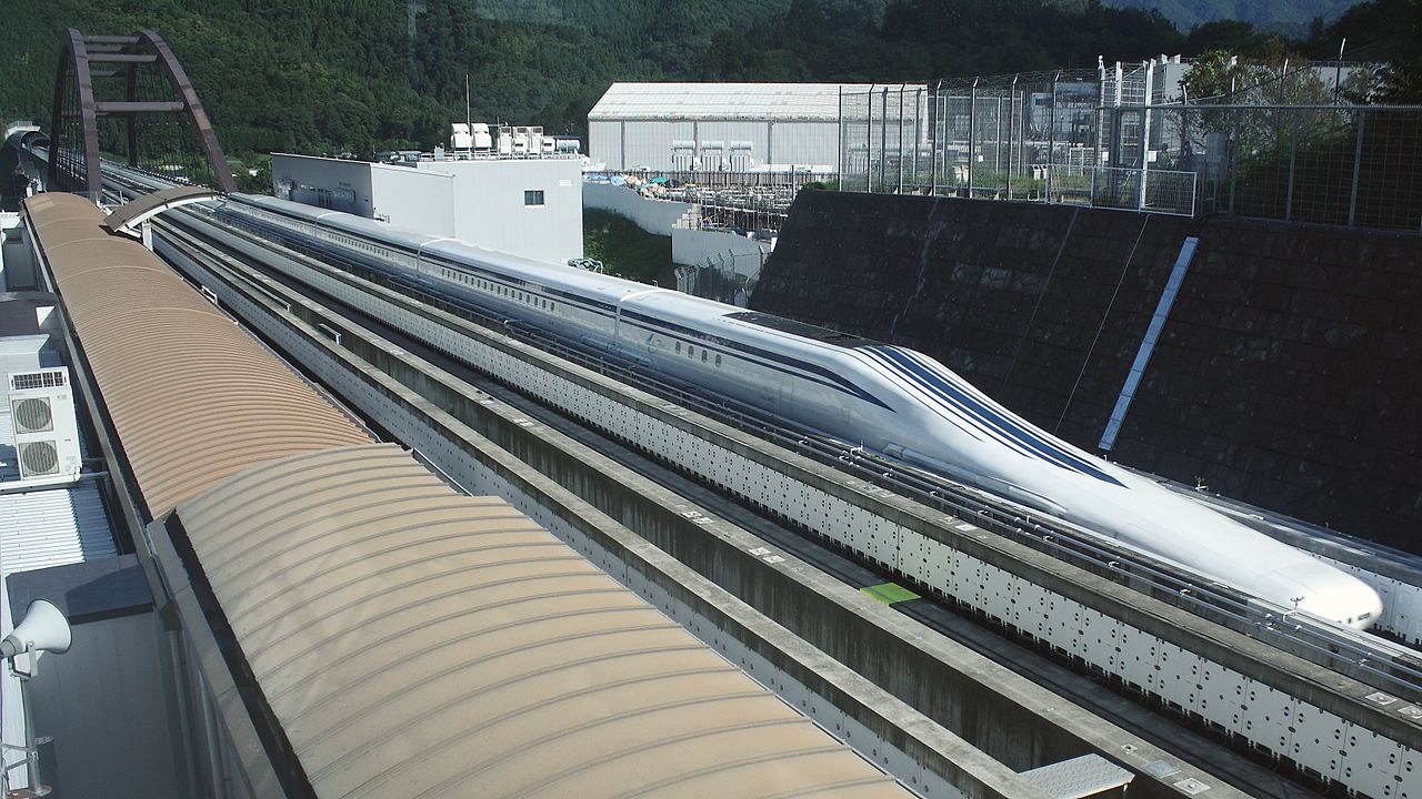

I browsed an old concept called Maglifter, studied by NASA 30 years ago. The maglev sled would have accelerated to 600 MPH, approximately Mach 0.8: seems Radian will use the same trick.
The present speed record for Maglev train : 375 mph. Wonder how it weights...
At completion, 14-car L0 series MAGLEV trains are estimated to weigh 420 ton and carry 1000 passengers
That's it: 420 tons at Mach 0.6

From the above, I would say that Radian sled should scrap 1000 m/s out of ascent to orbit.
Also Raptor 3 seems to target a specific impulse of 380 seconds, methalox of course.
9.81*380*ln((200+2)/(20+2))+1000 = 9265 m/s with 2 tons payload, a PMF of 0.90 and a MTOW of 200 tons.
