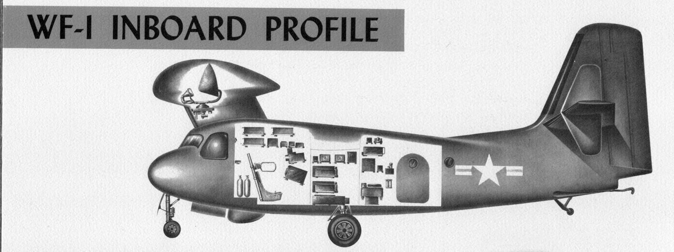

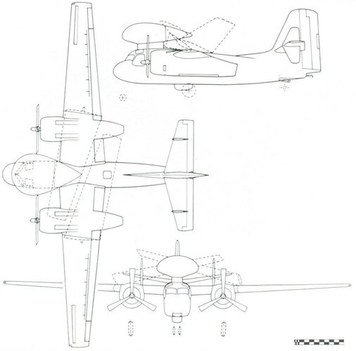

The initial plan for the WF-1 (E-1 Tracer) had a AN/APS-20 radar above the cockpit to retain the top-wing fold & single tail of the S-2 Tracker. Very quickly the radar was switched to the AN/APS-82 on a large fairing, side-folding wings, and twin-tail (with stub center tail).
WF-1:
