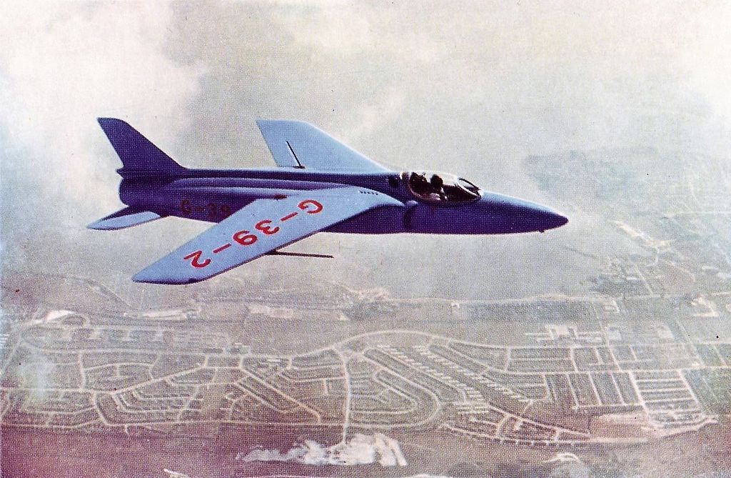

From the Design Challenge thread:
That's definitely an interesting idea. Already has internal weapons bays (for 51mm FFARs) and is a pretty light aircraft overall. 17,500lbs empty and that's with a 5100lb J57, not a 2450lb F414. The F414 is 90" shorter than the J57, so depending on where exactly the engine needs to end up for CG purposes it may open up some significant length in the weapons bays. Also, the F414 is 35" in diameter, not 39" like the J57, which should open up more internal volume.
You'd be looking at a ~16000lb fighter empty, and could maybe mess around with a wet wing outboard of the existing wing tanks to make them into weapons bays.
I'd think it could be even lighter with modern materials and design technology over what the 50's offered. Plenty of room in the nose for a radar and associated electronics, the wing provides lots of room for fuel and 'stuff.' The original F4D had a phenomenal rate of climb for the day and I could see that copied here and bettered.
You have room for a weapons bay, and if you are updating the cannon armament, there's more room in the wings from that at about mid span.
So, let's say you end up with modern construction, design, and materials a plane empty at around 15,000 lbs. that is carrier capable as well as operates from land bases.
