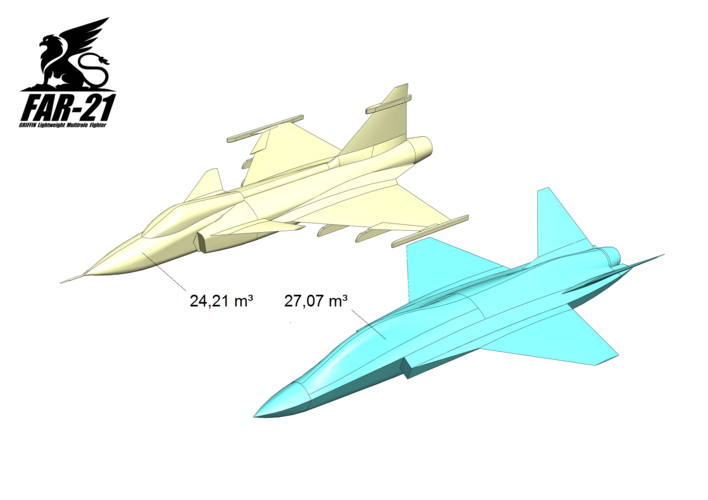

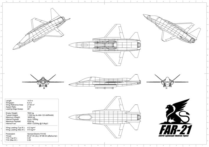

The F-35 weighs 50,000lbs, which is heavier than most Gen 4/4.5 fighters. On physical size, do you only measure length and span, or thickness (top-to-bottom) too? It also forgoes pop-out sidewinders and a little more wing wouldn't go amiss either.

Look at the list of weapons supplied to Germany along with the F-35, there are only three medium-range missiles per plane!
I disagree. 4x AMRAAM and sufficient fuel carried internally in a Gripen sized fighter is absolutely feasible. Check it out here:
https://www.secretprojects.co.uk/th...eight-multirole-fighter-lmf.38539/post-512527
4 MRAAMs is a bit slim for CAP and whilst that looks nice as a drawing, there are a lot of things that look nice on paper that aren't feasible in practice. The internal fuel fraction is also less 30% sans missiles, which is worse than a Typhoon or Rafale, and not many would argue that they have sufficient range on internal fuel alone for all missions.
The ideal stealth air superiority fighter would have 8 missiles (6 MRAAMs, 2 SRAAMs pop-out) and near 1000nm combat radius (2000nm range) on internal fuel. With deeper bays you could even try a 2x4 MRAAM rotary launcher and 2 SRAAMs. The range requirement probably means and internal fuel fraction of nearer 40%, or at least 35% maybe with advanced adaptive cycle engines or something.

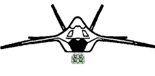

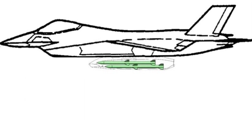

So here’s a rough mash-up of the Boeing Model 24F with the Super Hornet’s weapons pod…
This produces a 9t empty fighter with 5.5t of internal fuel and a single streamlined external load. It is about 500kg lighter empty than an F-16 with CFTs, with 20% more fuel (about as much fuel in fact as an F-16 with CFTs + centerline 300 gallon tank, or an F-16 without CFTs and with 2x 370 gallon tanks).
So it should comfortably outrange & outperform the F-16 even when fully armed with 6 AAMs (or 4 AAMs + 6 SDBs).

Pod will affect above estimated range. Here you are just trading the CFT drag for the one from the weapons pod. Essentially there is only a slight improvement, if any, probably cut away by the stealth shaping of the airframe.
Stores drag should be in favor of the LO fighter:
F-16: 300 gallon tank + external weapons
Model 24F: 1 Enclosed Weapons Pod
So even if the F-16 with CFTs has slightly less drag « clean », I would expect the LO fighter to have slightly more range overall… unless the LO airframe was very draggy.

The Boeing EWP only holds 2x AAMs and 6x SDBs. And IIRC the Model 24F holds a pair of Sidewinder-sized missiles in side bays, with a single 2000lb class bomb amidships.
Yes I was assuming that the stealth fighter with EWP would retain the side bays for 2x AAMs (hence 4x AAMs total + 6 SDBs) and replace the center bomb bay with an internal fuel tank to achieve useful “F-16 like” range.
