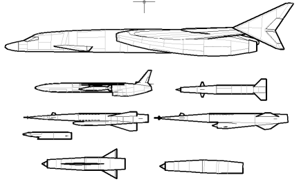

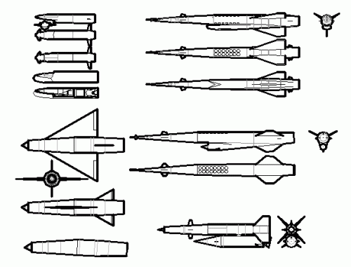

For the next issue of APR, I am putting together a series of in-scale three-view drawings of several Pluto variants. To make it a big more interesting, and to give a sense of scale, I will also be including side-view drawings of the Snark (a roughly equivalent cruise missile), the Atlas ICBM (what basically killed the Pluto) and the Convair NX-2 (the closest there was to a manned equivalent of the Pluto). IS there anythign else that would fit in here appropriately?
I was thinking that since it was to be silo-launched a comparison to Titan II, Minuteman, and Peacekeeper might be interesting.
the sovjet Buran missile and GNOM

by way this Picture
wat is this Pluto design on down left ?
Maybe a conventional winged bomber like the B-52/B-58/XB-70 (or part of) to give a scale comparison across all contemporary strategic weapon systems.
The one down right is the Convair "Big Stick", I presume.

What's the vehicle on the lower right? An advanced Navaho?
That's a vehicle that I debated putting in this article, and in the end decided "what the hell." (Such decisiveness being a hallmark of the forces on neoconperialism...) It's not exactly a Pluto, and it was not so much a design as a mathematical abstraction, but... the USAF asked the NACA to look into a *manned* nuclear ramjet propelled vehicle at the same time Pluto was getting underway. it's by no means a serious effort, but since the world doesn't seem to be slopping over with manned equivalents to Pluto, I thought it made an inteesting addition.
Rafael said:
And the bomber?
Convair NX-2. Closest the US came to actually building an operational nuclear powered aircraft.

(y'all know where to go to get the higher-rez version... go, if you dare...)

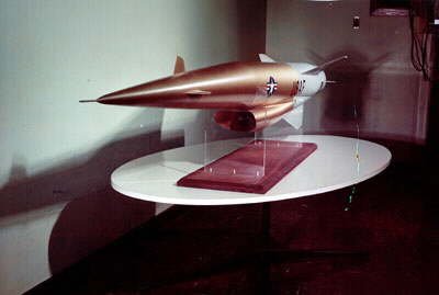

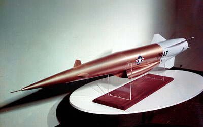

Having not really had much interest in missile projects before, only today I learnt about the Pluto/SLAM project and found the whole concept utterly horrific and fascinating at the same time. Digging around for material of course I came here first and also purchased Scott's APR eV2N1 with the Pluto/SLAM article in it. All amazing material! What I'd really like to see however is some larger size pictures of the 1/10 Vought scale model.
http://www.voughtaircraft.com/heritage/photo/html/pslam_0.html
http://www.voughtaircraft.com/heritage/photo/html/pslam_2.html
Would anyone have these at a larger size please? I'm particularly interested in having a closer look at the air intake configuration.
Join the club. :)

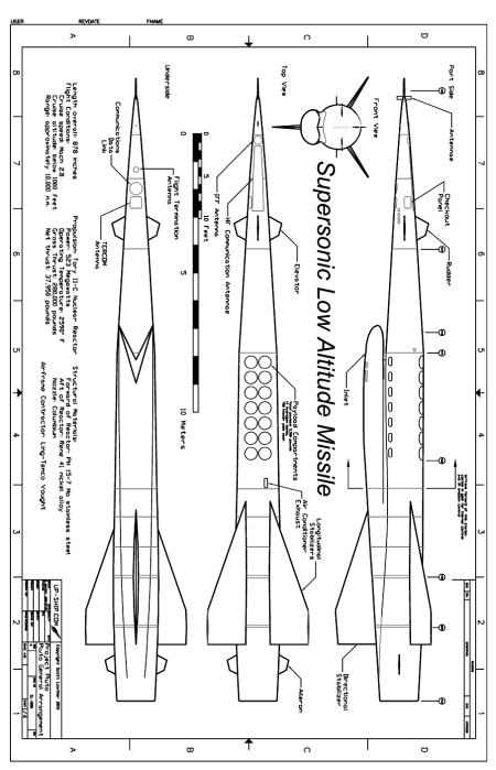

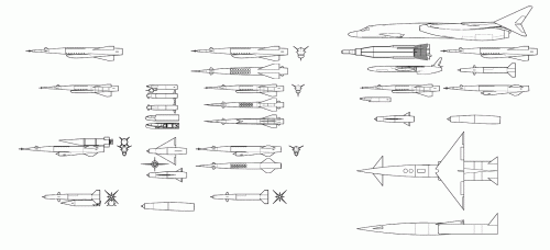

Orionblamblam said:
Very nice! Will you release this in digital format as well? Personally I have no interest in prints, as my main interest in these sort of drawings is for 3D modelling purposes. I do have your eV2N1.pdf about the Pluto/SLAM, but it appears you've made some small changes plus the additional data is useful.
Skyraider3D said:
Possibly maybe someday in GIF format, not in the original vector format. I just got back from the printer with the first production run, incorporating improvements suggested by buyers of the protottype run. They look quite a bit better, even though the tweaks were minor.
