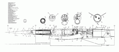

Overkiller: If no-one has any decent drawings of the "Flying Crowbar", I can create images that might be useful to you based on my 3D model. Curiously, the intake shape is a bit of a puzzle. On the image on a previous post - the red 1/10 model - it shows an oval intake, cut back in the centre. However, other images show a more conventional circular intake with an intake cone set in the centre, which from an aerodynamic/engine/ramjet perspective seems to make much more sense, so that's what I went with. Though the Vought Heritage site says "The classical spike inlet was replaced with a scoop-type inlet invented in the program, which gave pitch/yaw performance over a wider range and a pressure recovery of 86% that was much higher than the initial program objective" - and shows a cutaway with what appears to be a spike inlet. Odd.
Here's the cutaway image I made from my model:
Since a model of the Pluto *is* on my schedule, and thus competition is to be despised, opposed and mercilessly crushed into oblivion, you'll pardon a bit of stinginess with the imagery.

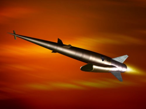

Here's a first quick look at SLAM with new surface texture, and with the cone spike inlet. I'll have to try the scoop type inlet just for the sake of completeness.
Stinginess with source material is completely understood. By "model" I'm assuming you mean a 3D/CGI model, and not an actual physical 'thing'? Still, the pics you posted are immensely helpful!

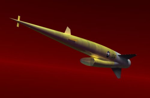

Just been updating my Pluto/SLAM model in accordance with the various comments/new info, and here's where I am at present:
I think that looks pretty close to the two images we've seen of the model that was made. Any comments or suggestions anyone? This will be what I base the drawings on - I can dissassemble it to provide decent drawings of the components, and I should be able to take slices through it too.

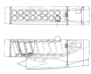

From the drawing attached earlier, the doors were no bigger than they had to be... they'd pop open and slam shut as fast as possible.
Also, one of the diagrams of the internal layout shows the weapons would have been ejected at a slight forward facing angle. Any ideas as to the reasoning and/or desirability of this approach?
By launching forward, with the bomb pointing forward, the bomb would generate a bunch of lift. This would help raise it clear of the vehicle. If launched pointing aft, it would be downwards lift, pushing it back into the Pluto.
