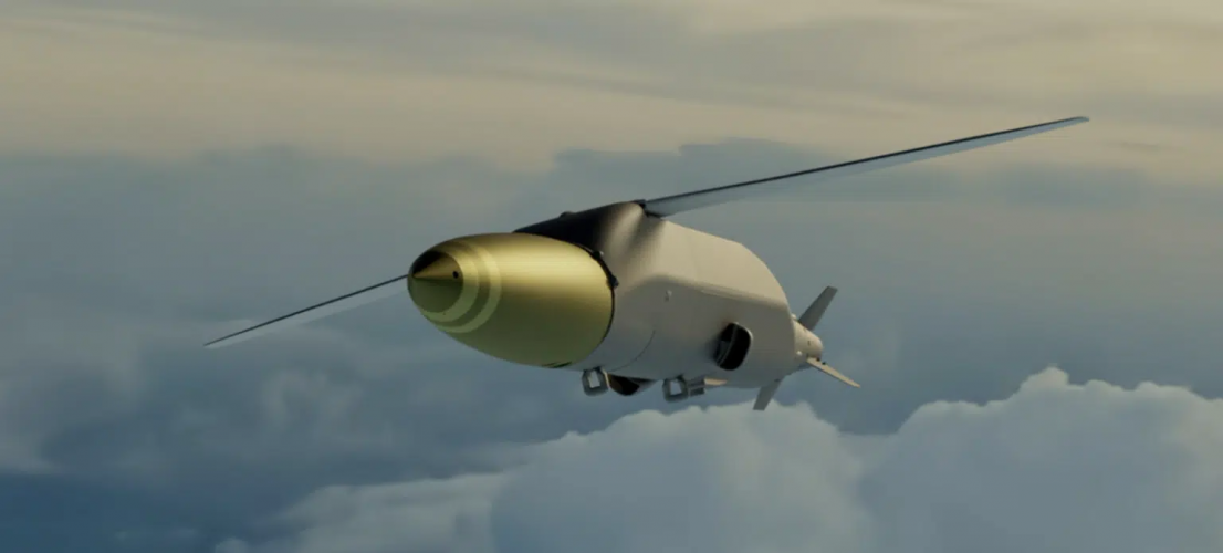

There are a slew of new cruise missile platforms hitting the market. Look at the four entries to ETV. The fact that Boeing is not even in that program tells me that PJDAM falls short. As for the USN, the MACE requirements probably also exclude PJDAM for size/weight reasons.

ERAM contract awards support the weapon efforts for Ukraine. That's how the program came to be. Obviously anything developed will have broad applications across other export customers and partners as well. Same for another similar effort the Navy is running (CAMS). ERAM looks like a pretty straightforward/simple effort to identify candidate open architecture 'air vehicles' (call them launched effects or missile trucks if you want to) in the 500# class that are the parent platforms for a extended range weapon (Mk 82 class warhead, WDL etc). They awarded contracts to Coaspire and Zone 5 after reviewing 16 proposals from industry. Those are fairly short/rapid prototyping awards running through October.
Is money already budgeted for the next phase?
Also that tweet is the first time I’ve seen mk82 explicitly to be a payload option - IIRC the RFI just said 500# which I took to be an AUR figure. The renderings do not look like Mk82 kits.
Tought one could assume an MK.82 effect like NSM does with it warhead. Assuming similiar capabilitys the warhead could be half as large while giving an similiar effect on target
It’s a rough “effect” though I think someone specifically asked whether the AF has a warhead requirement to which AF replied that proposals are free to select their Wh soluition.
