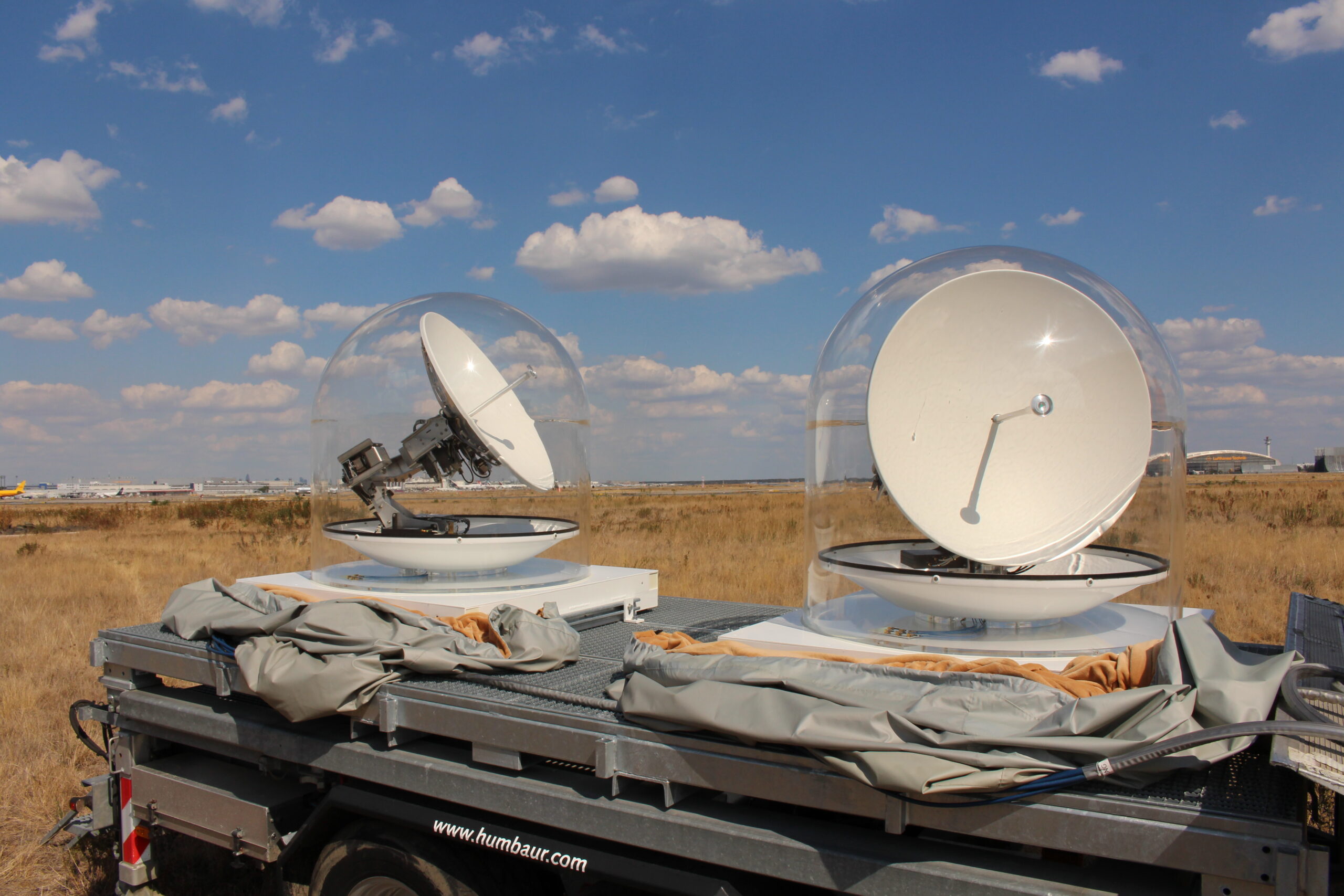

The German Fraunhofer Institute is doing a lot of research in this area with the Sabbia 2.0 project:-Ku Band non-cooperative Bi/Multi-Static radar for low altitude gap filler radar
Using Starlink in this way is not merely a theoretical idea. Research is advancing to employ Starlink downlink signals as an RF source for passive radar. In late January 2024, Germany’s Ministry of Defence announced that the country was developing a passive radar which could exploit Starlink’s signals. The work is being performed by Germany’s Fraunhofer Institute for High Frequency Physics and Radar Techniques (FHR). Reports stated that the system uses a reference antenna which follows Starlink satellites as they cross the sky. The reference antenna detects and copies the signal’s characteristics as these are beamed down to Earth. A second antenna is pointed towards the area of interest the radar is monitoring. The reference signal is compared with those signals coming into the second antenna. This process ascertains if these signals are being altered by targets in the antenna’s field of view.
The abundance of terrestrial RF tends to diminish in frequencies above ten gigahertz. However, satellite downlink frequencies exist in X-band (7.25-7.75 GHz), Ku-band (10.9-12.75 GHz) and Ka-band (18-20 GHz). As Starlink is showing, some of these wavebands could soon have ubiquitous global availability. Employing satellite RF sources is particularly attractive when you want to use a passive radar over the oceans.
The movement of the RF transmitter means that imagery of still and moving targets can be processed. When coupled with the characteristics of Starlink’s downlink frequencies, this movement helps provide a target resolution of circa one metre.
The entire Sabbia-2.0 architecture can weigh as little at 60 kg (132 lb), meaning that it can be easily accommodated on a vehicle. Other applications are being considered for the technology. For example, Sabbia-2.0 could be configured to outfit a ship or aircraft.
