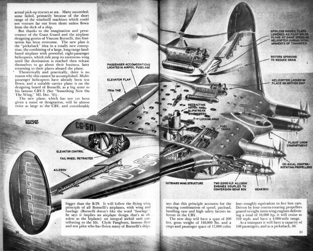

I was trying to follow-up on the information that the December 1946 of the Mechanix Illustrated magazine had an article titled "Something New On The Wing" with a nice picture of a "projected" Burnelli aircraft. I had found the information here :
But the link at the bottom of the page was not working anymore.
Thus, I had the idea of looking it up through the Archive.org website and I found out that this article was not in the December 1946 but 1945 ! Here is a link to the right magazine and the article :
https://ia802300.us.archive.org/10/...m_todays-homeowner-solutions_1945-12_35_2.pdf (See Page 49 and following...)

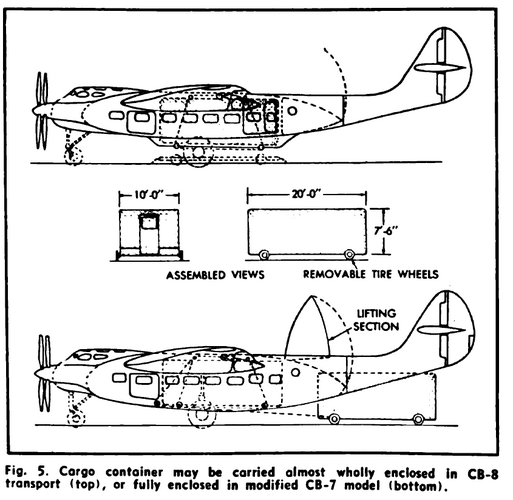

But my search was also interesting in that the December 1946 also had an article on a Burnelli project! A kind of airborne helicopter platform for rescue at sea! This article is called "Helicopter Pickaback" by Roland Cueva.
https://ia802300.us.archive.org/14/...m_todays-homeowner-solutions_1946-12_37_2.pdf (See page 83 and following...)
I have tried my best to add up two pages from that archive and here is what I came with...
I hope that you'll like it...
And now, I am wondering if that December article would also work in different years! Who know what we are missing...
