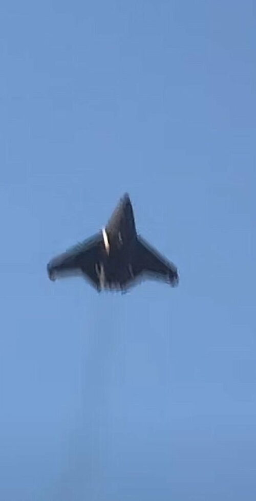

I feel somewhat confident there are no vertical tails/v tails; what we do see are split flaps on the trailing edge, not dissimilar to what is seen on some other flying wing airframes in the world.

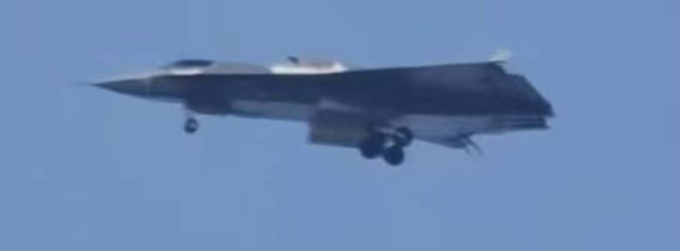

Doesn't really seem like 3 engines but it kinda has a vertical tail? Or an very big antenna...View attachment 753658
I know they have them but they are / should be mutch further too the front and in can see the end of the wing. I stand by it but then again the resolution ain't great.
There's nothing much to stand by. In the picture you've first quoted, the aircraft is banked to the left and the photo is taken slightly from the behind, diagonally facing the aircraft. What you think is a vertical structure is just the ruddervator/split rudder of the starboard wing.
In that case the flaps can be used for yaw control. All aspect RCS reduction across radar bands is the focus for this design.
Depending on whether there is TVC the design may actually be more maneuverable than people give it credit for. True it is probably a 40-50 ton monster, but don’t forget that it has three engines.
Probably split flaps/ailerons hinged diagonally to raise in their extreem open position and act as rudders.

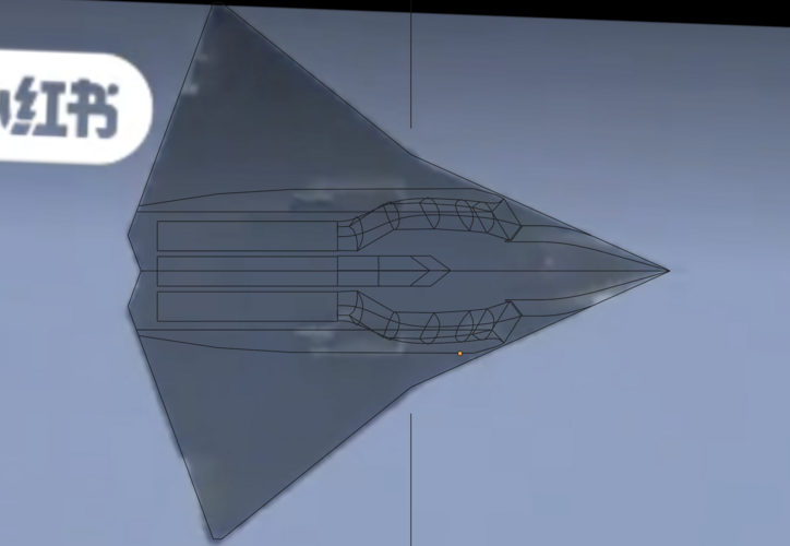

Notice, I count only 2 engines. Could someone point where they see a 3rd one?
In between those two is the supposed "third" engine for which the the "extra" air intake on top is. But im with you too me it looks like 2 engines but maybe they have an extra power / cooling unit there.

The image is a bit blurry but is each flap actually a “split flap”? Looks like they open both top and bottom. Could be used as effective air brake despite lack of vertical control surfaces.
The straight conclusion b/w the number of intakes and engines is too an hasten one IMOHO.
They can have 2 side inlets for max power situation and the top one for stealthy cruise.
The extra intake could be for so many things. Airframe cooling, cooling the exhaust or avionics and maybe even boundary layer or air flow control .

Anyway the main landing gear reminds me really the MiG-31's one....
I think TSR2 style in line wheels, but on the inside of the gear leg from the few pictures. Probably a fairly straight rotate upwards/forwards.

Someone said this is 3 engine plane which the third engine similar to the italian ARIETE have aa freely switchable engine intake that opens only when extra thrust is required
