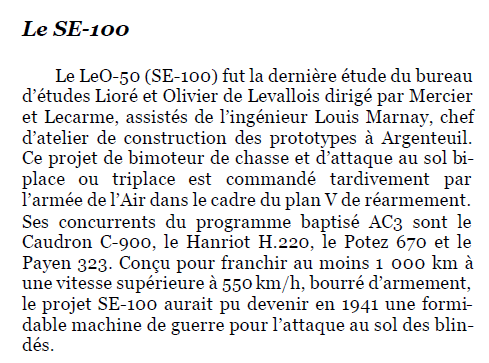

there was anther source for Pa.323,Hydroretro site.

OK, there are at least two sources with the Pa.323. And I did not have this source from Hydroretro. Thanks Hesham :)

hesham is right, the "Pa.323 AC3" is mentioned by Gérard Hartmann in his article "Les réalisations de la SNCASE"
(via http://www.hydroretro.net/etudegh/ ) as one of the contenders for a twin engined attack aircraft.
But the Pa.321 AC3 isn't mentioned there, which definitely should have been, as it was a well-proven entry for
that contest !
