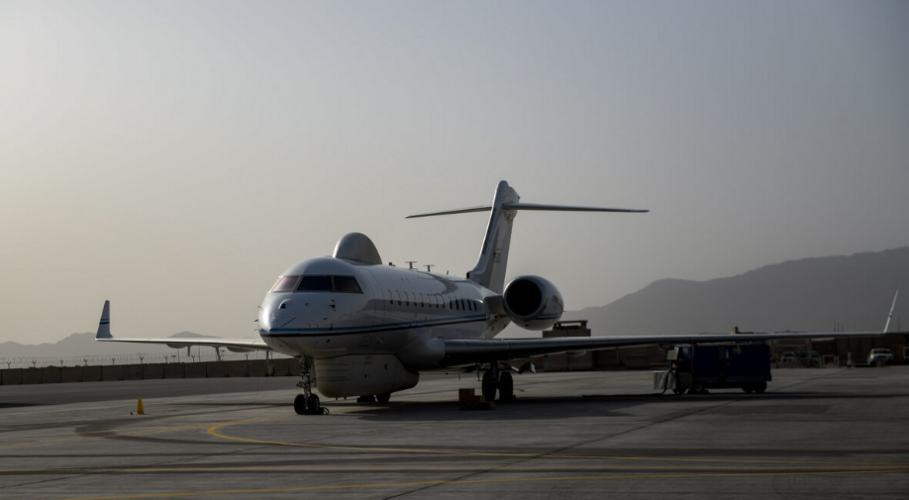

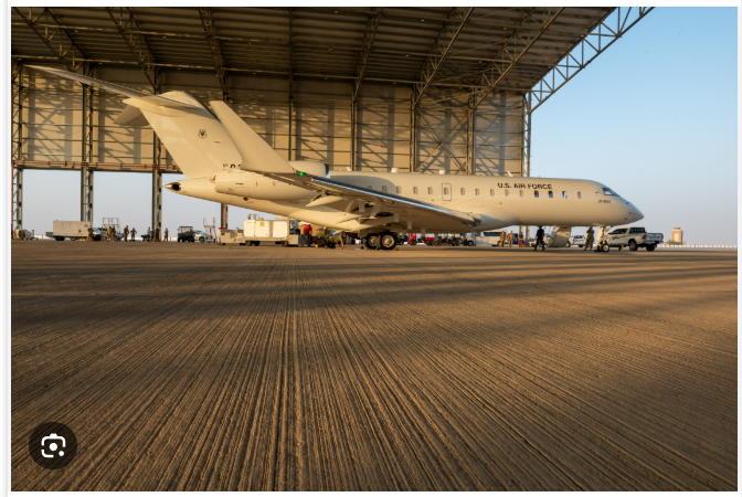

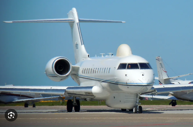

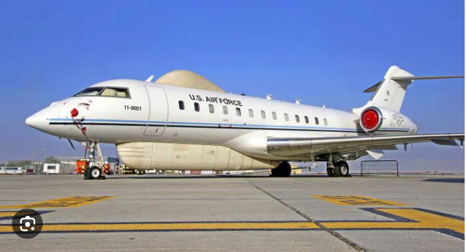

Am I nuts, or are there two very different configurations of BACN E-11s?
This clean-looking airframe:
And this version, with two very large antenna fairings
Is it possible they decided to differentiate these two? Or am I just missing something basic about the BACN aircraft?

These do not look doctored, but the first one did (especially the serial and markings on the fuselage, which incidentally DON'T appear on your other photos.
11-9001 is well known as a BACN airframe.
I figured it out -- apparently the ex-RAF airframes have those radomes left over from their surveillance role and they are not required for the BACN function. (See the end of the article below)
11-9001 is, I think, the "prototype" aircraft, which has been retired.
The first 4 E-11As were based on the Global 6000. The newer aircraft are based on the Global 6500. It's possible that the 6500-based aircraft could be designated E-11B but at least one has been delivered and has been referred to as an E-11A.
Originally there were 4 E-11As and 24 EQ-4B Global Hawk (Block 20) BACN aircraft. The 24 Global Hawks were retired and the E-11A force was to expand to...... 7. This was now many years ago, but they are still not at that number. 1 E-11A was lost, the "prototype" was retired, and 1 new aircraft was added.
