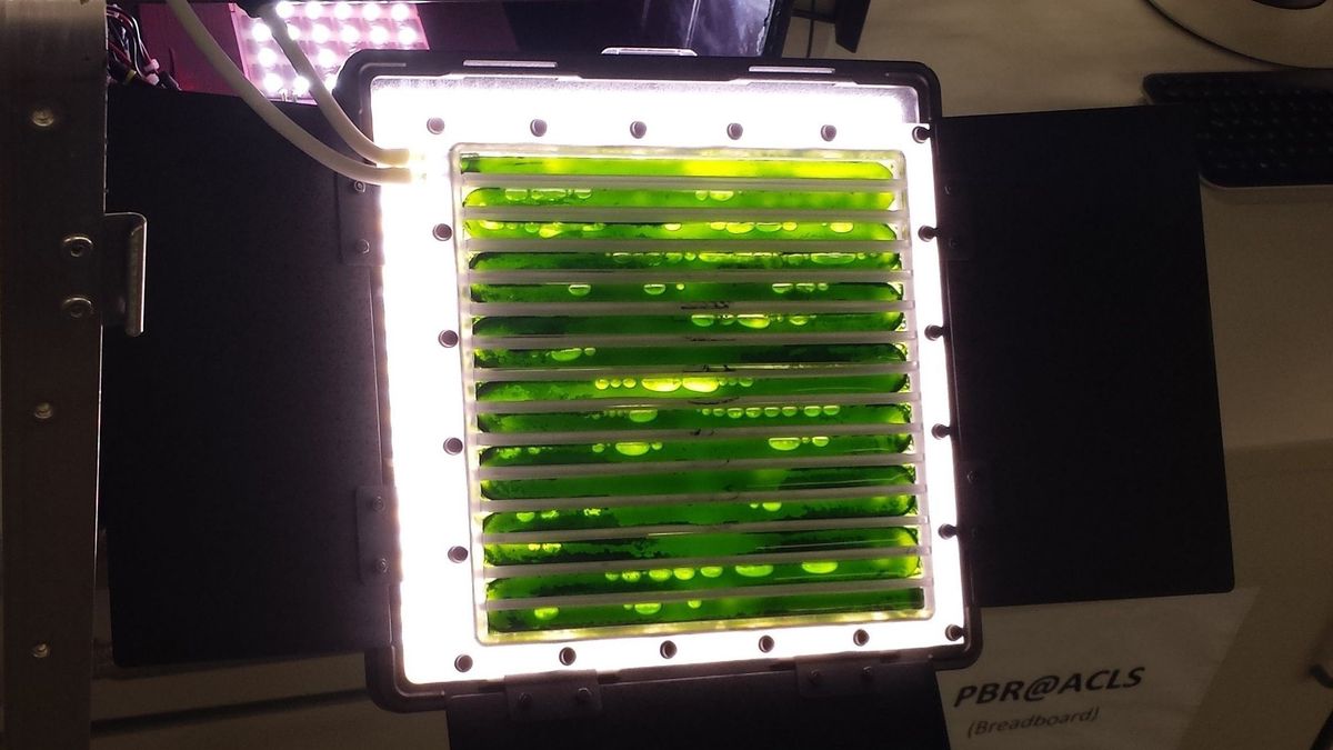

Algae for biofuel might be an interesting contender considering the miserable amount of sunlight on mars but there still is the oxidiser problem, which is needed to keep the engine runningThere is that melanistic fungi in reactors to look at too. Algae for biofuel. Kerosene needs no reefers.

Algae farm.
