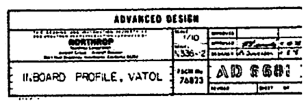

PaulMM (Overscan) said:Inboard profile from same PDF appears to depict N336-7
After going over the same document, I think that the caption looks more like N336-2. What do you think?

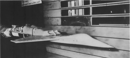

Sundog said:Top Mounted Inlet System Feasibility for Transonic-Supersonic Fighter Aircraft
T. L. Williams, W. P. Nelms and D. Smeltzer
http://ntrs.nasa.gov/archive/nasa/casi.ntrs.nasa.gov/19810015531_1981015531.pdf

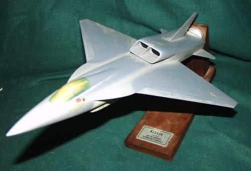

That would be my concern in general - I suspect one could make an inlet that worked well at high-AOA, but I find it very difficult to believe you could make one that worked at high AoA *and* a reasonable degree of yaw. All those images show straight-line AoA, which is great until you start to get near the stall boundaries.PaulMM (Overscan) said:The Saab design had good high AOA performance too. The main objections were difficulty of placing a second seat without disrupting airflow into the inlet, and possible problems with combined high AOA and yaw.
