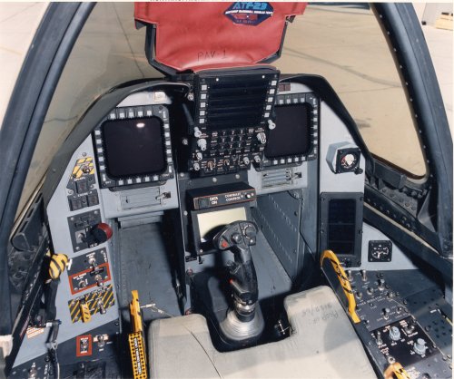

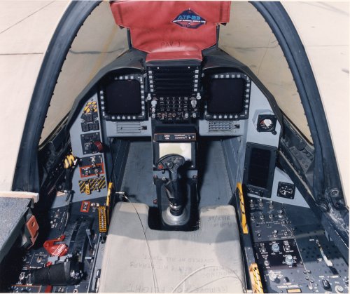

thanks to Anxiety for finding this exciting new stuff at http://uscockpits.com/
note complicated faceted pattern of instrument panel's shroud

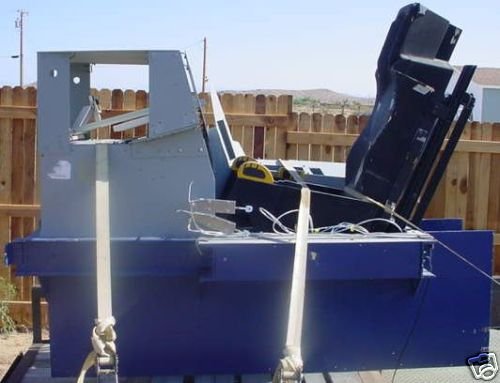

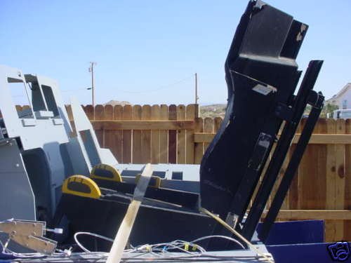

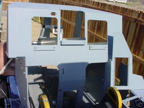

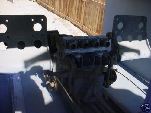

http://cgi.ebay.com/ebaymotors/NORTHROP-GRUMMAN-YF-23A-F-23A-COCKPIT-SIMULATOR-RARE-NR_W0QQcmdZViewItemQQhashZitem1c1045b513QQitemZ120532088083QQptZMotorsQ5fAviationQ5fPartsQ5fGear
That's a new for me. ::)
With the YF-23 Northrop paid attention to some details affecting RCS in ways we have not fully seen in a production aircraft, let alone the YF-22. No wonder it's RCS is still classified.
New cockpit shots... that's great ;D

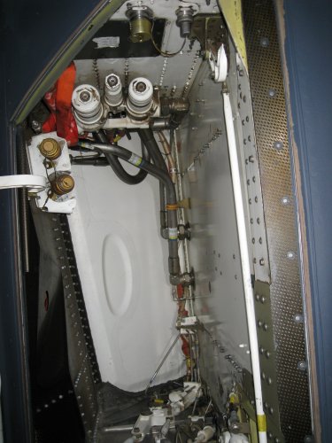

If you look carefully at the PAV-2 bay pics of Tony Chong, you'll see that the V swing arms are quite light gauge (there doesnt even seem to be a hydraulic actuator for the arms), so I'm thinking that PAV-1's bay was the same except for the colour
bay is the same, but V-arms have nothing to do with launcher and nothing common with PAV-1 bay
my request to you - can you take pen and plain sheet of paper and try to imagine YF-23 bay as you see it after reading WB description in YF-23A Flight Manual (carefully reading every word) - there are many clues there hidden behind phrases
Ok, let me think about it. I can envision 2 configs, one with just one missile, and one with a full complement. Let me see what I can come up with.
You seem adamant that the V-arms are for something else. If you are sure they are not for the launcher, then what would you say they are for? And I missed the AWST article, do you have the details of what they actually said re the instrumented round?

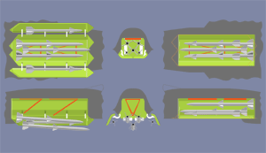

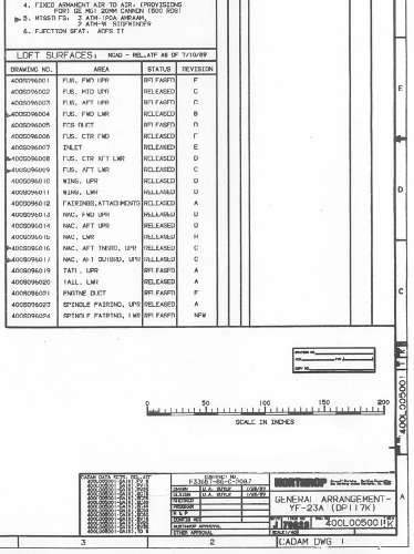

Ok, here is the stuff: the Northrop dwg annotation, and a small teaser of my idea for the weapons bay to let you you know I have not forgotten. It's gonna take a little more time before I upload the hirez version, but you'll understand why when I do. But even with this image, you can make out where I'm headed and probably work out the rest.
Does anybody have a better version of this picture?
Perhaps I missed it in this thread, but has there been a confirmation of the YF-23's empty weight? I've seen anywhere from 29,000lbs to 37,000lbs.
I second that request.
That actually makes complete sence. It fits in with the airforce complain of single point failure affecting the launcher. While the prototype would cary only 5 missiles this way, it it possible to add 1-2 more AMRAAM due to the shorter wing span and with 3 AIM-9X at the front bay for a total of 9-10 missiles.
Northrop were reported to have modified the AMRAAM launcher for the production version to have two separate launching mechanisms, probably each holding 2 missiles.
Still, this particular configuration of the launcher is a complete waste of space.
I think the key really lies in careful study of the factory dwgs, which we can do now thanks to the generosity of people contributing to this thread... you can all see there is a big diff between the PAVs and the EMD, particularly with alteration on useable fuselage volume. I am convinced that Northrop never intended the PAVs to be a viable ATF as such, they were simply conceptual demonstrators.... they put all the effort into the EMD variant which quite clearly has enough volume to fit the ATF requirement in regards to weapons carriage. I think trying to work out how many missiles could fit into the the bay of a PAV from a weapons platform point of view is a waste of time, because it was not Northrop's intention to develop the PAV config. The EMD is really a totally new design from a clean sheet of paper. It shares very little in terms of fuselage cross sections, the structure is totally diff.... only the wing is the same. They just wanted to test acoustics on the PAVs, thats what I suspect, so I think ultimately they may have just made a rudimentary launcher to hold just one missile and thats all. But we wont know until someone at Northrop or the Nat AF Mus at Ohio is generous enough to give us some shots of PAV-1's bay..... hint.......hint........

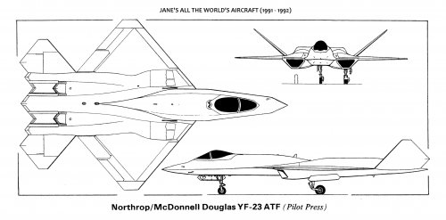

I found this 3-view in Jane's All the World's Aircraft 1991 -1992. Is it of any value to you guys? and how accurate does it seem to be?
