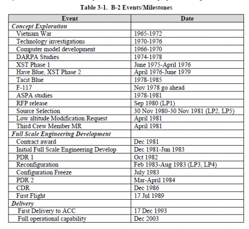

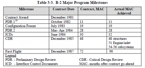

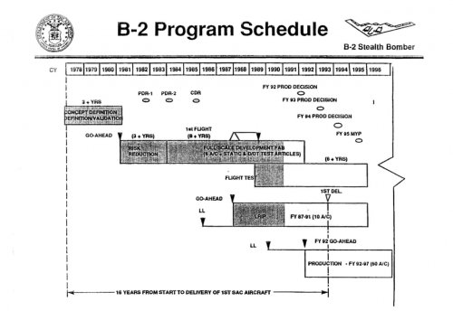

Some tables for a future reference/comparison

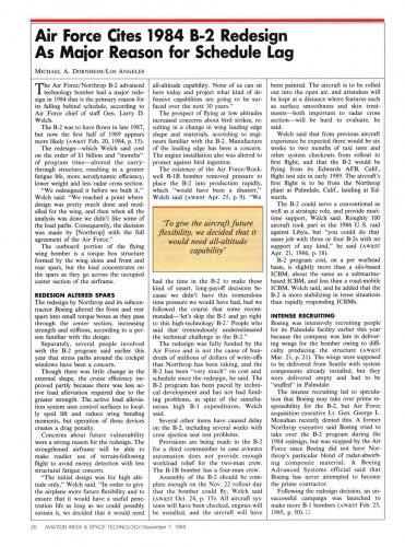

The only problem with this schedule is it doesn't show the delay that took place as a result of changing the requirements from an all high mission, to the ability fly NOE. This necessitated a massive design change, which I am sure you are well aware of, and added a lot of time and cost as a result. Having said that, I agree with your CDR to roll-out timeline. I initially thought they were further along, but knowing when CDR is taking place, I would expect rollout in between one to two years after CDR. I think it can happen in a year, because I don't expect the first aircraft to have all of the production systems and if all of the reported flight testing that has already been done over the past ten to twenty years as technology demonstrations was as effective as claimed, there shouldn't be too many show stoppers.
It does. See right column at Table 3-3.
AWST article takes redesign date a little bit wrong as it was decided that ATB should have been adopted for low-level penetration even prior contract award (see Sweetman's Inside The Stealth Bomber and Grant's Spirit of Innovation) - but only later it became clear how big changes would be.
AFAIR 'months' roughly was a whole year of delay.
But that change was pre-contract award anyway; the agreed upon schedule was padded an extra 24 months relative to Northrop's proposal.

I think a good indication of the delay caused by the low-level requirement is the fact that they had to have a second PDR about 18 months after the first.
That's interesting that B-21 had a second PDR as well, but if in the case of B-2 Sweetman calls a second PDR 'unusual', in the case with B-21 we can call unusual both PDRs
Thanks, I hadn't realized that that was what the second PDR was for and I didn't realize the design change was made before they started cutting metal.
The AWST article reports that Boeing tried to take over as Prime around B-2 second PDR. If one were cynical they might suggest the early production "hiccup" around B21 engine and wings as a driver for a second PDR with the same objective.
With all the lessons learned resulting in RCO, tech maturation and locking down requirements early, perhaps 2 PDR's will no longer be abnormal. PDR prior to contract award and moving directly to EMD with another PDR once the "team" is in place may in fact be the new normal.
I find these timelines hopeful. IoC for B-2 was 7 1/2 years after first flight. If B-21 first flight is two years from a December CDR (and B-2 was ~2 1/2) that would be IoC in mid 2027 using B-2's timeline. For myriad reasons wouldn't it be reasonable to expect B-21 IoC to be a much more efficient timeline?
The redesign of B-2, as previously noted, resulted in death spiral like series of events. Subs were already working on systems that now needed new designs for the redesign. The new sub system designs were different and created new risk, resulting in changes in other sub systems that supported them. These changes resulted in structural changes and even changes to wiring harness. All these changes resulted in wings, which were originally to be delivered "full" of "devices" to be delivered empty and "stuffed" during assembly. So now the delivery of test articles are way behind, resulting in IOT&E schedules all out of whack. And in spite of all these issues, IOC was in 7 1/2 years after first flight.

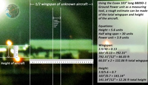

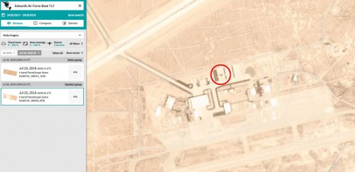

Looks like a B-2 to me. There isn't a clear enough image to say otherwise.
How to write several pages of sighting a plane that even not passed CDR...
Because of course they would never fudge the timescales on a grey project.
That said I doubt they’d park anything other than a B-2 out to be caught on a commercial reconnaissance satellite.

With respect to the photo analysis if the ground power unit is parked normal to the line of sight and a B-2 at some angle won't that give the same result?

Jeb said:
The engine intake dimensions look off, though. Narrower.
One thing I've learned seeing the B-2 over the years is that the dimensions always look wrong. Even a slight change in look angle can dramatically change how the vehicle appears. Which is probably related to LO shaping and flying wings in general.
Jeb said:
Thank you for at least putting forward some reasoning unlike other posters who think it’s sufficient just to make some allegedly snappy response.
