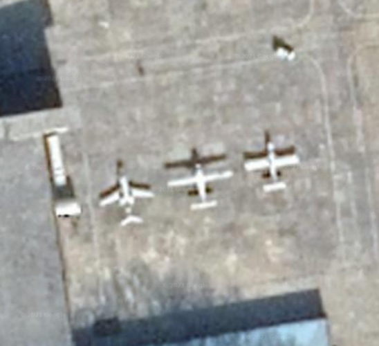

First of all there is no evidence that North Korea is modding up An-2's as UAVs and you are likely confusing them with Azerbaijan or you saw North Korean modifying An-2s with terrain radar for their special forces to fly as low as possible during night and heavy fog.A cruise missile turbofan engine only needs to keep running as long as it takes to cover the 1,500km, it needs to work for probably less than 3 hours. Its expendable, you don't need to worry too much about quality control at all.

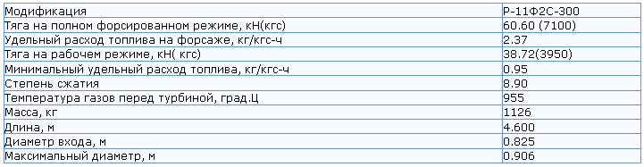

As for the R-25, that's no spring chicken of an engine either. It was first run in 1971, and is wholly inferior not only to current engines, but also last-gen engines like the RB199, F404, and RD-33.

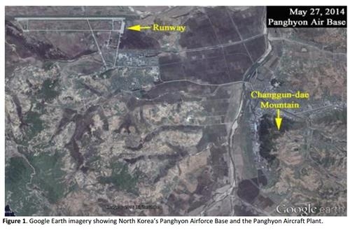

Exactly, we have almost no evidence of any indigenous aircraft industry at all.As for their aero engine industry, we don't know much except very few details that I have mentioned while you choose to grasp straws by essentially asserting that they can't do this or that simply because I have not made assertion that they could do something else too.

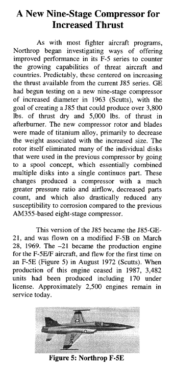

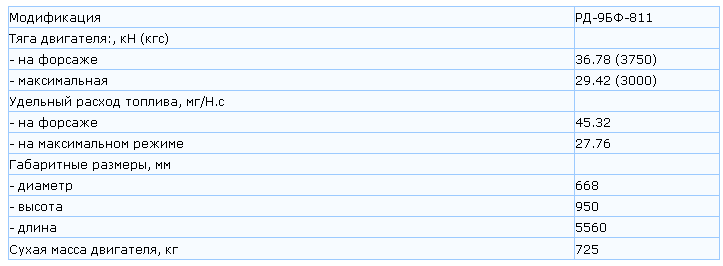

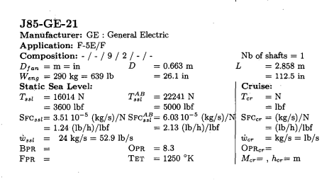

RD-9 is 25% heavier than two J85-GE-21 combined.Also, no, a single RD-9 is not comparable to two J85s. A single RD-9 is less thrust (6600/8300 versus 7000/10,000) for more weight (1600 lbs versus 1280 lbs) and fuel consumption (1.02 lb/(h·lbf) versus .96).

You have zero evidence that that 2.3-fold increase carries over the -21 model. And even if it did that doesn't change all the rest of the advantages the twin J85 setup has over a single RD-9.RD-9 is 25% heavier than two J85-GE-21 combined.

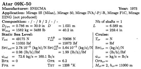

Two J85-GE-21 combined produce 6 percent more thrust without afterburner and RD-9 consumes 6 percent more.
RD-9 when using afterburners consumes (1.66 lb/h·lbf) per kN.
J85-GE-5 on T-38 Talon for example consumes (0.57 lb/h·lbf) per kN and (1.34 lb/h·lbf) per kN using afterburners.
Apply that 2.3 fold increase to J85-GE-21 used on F-5E Tiger II and that would be (2.23 lb/h·lbf) per kN when using afterburners.
J85-GE-21 would be consuming 34% more per kN with afterburners while generating 20% more afterburner thrust than RD-9.
That means that North Korea has managed to seriously developed her aerospace industry so the designing and production of an indigenously fighter aircraft must be considered as likely.

Fair enough. This site has the data for the J85-GE-21: 35.15 g/kN/s (Pg. 16). The same site gives the RD-9F's SFC as 25.48 g/kN/s (Pg.12). So it looks like yes, the twin J85s would consume more fuel than the single RD-9.Yes, without consideration of 2 engines compared 1 engine involving provisions to mount those 2 engines along there being 2 intakes.
Also we don't know if figures you cited are for J85-GE-21 and if you took those figures from Wikipedia where it is vague by not being specific which model of J85 is as maximum thrust is stated as 11-22 kN as 11kN is J85-GE-5 dry thrust and 22kN is J85-GE-21 afterburner.
