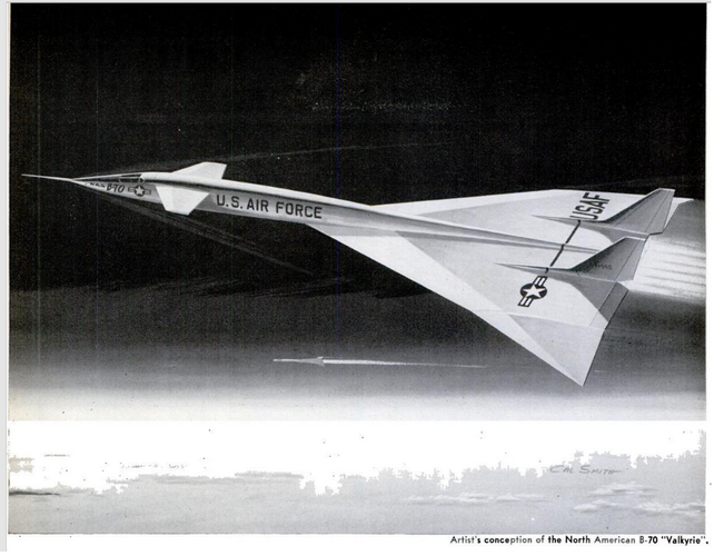

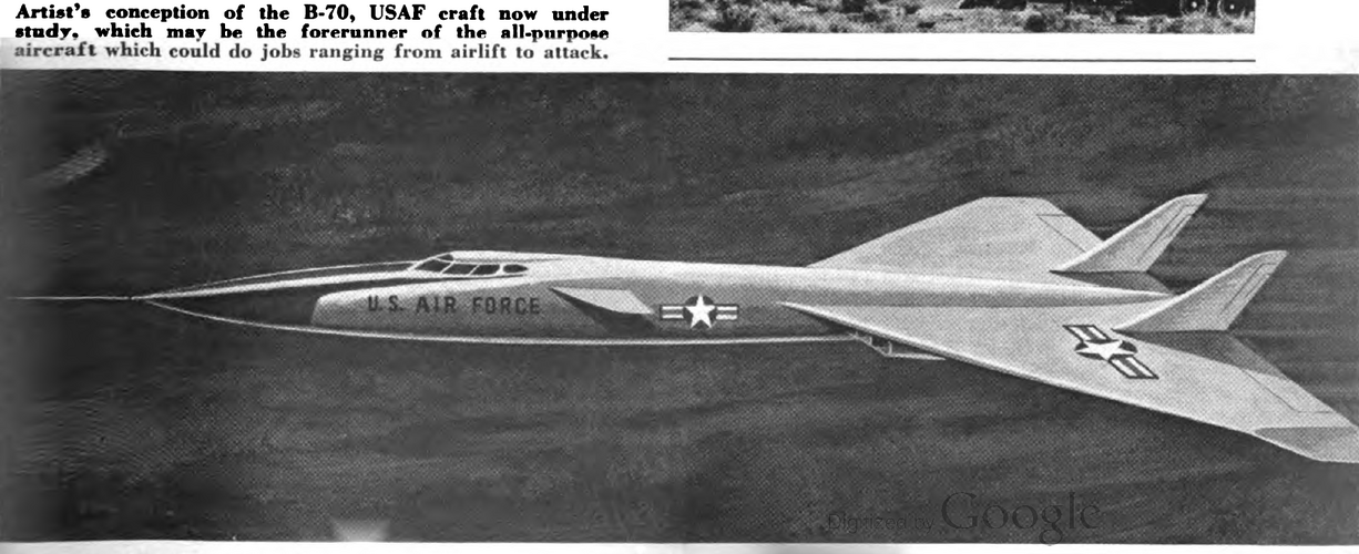

From Interavia 1959,
here is a speculative artist drawing to XB-70,should been,just Wow.
It looks definitely like some unknown version of the B-58 Hustler rather than anything closer to the actual B-70...
That's right my dear Archipeppe.
And from Interavia 1960.

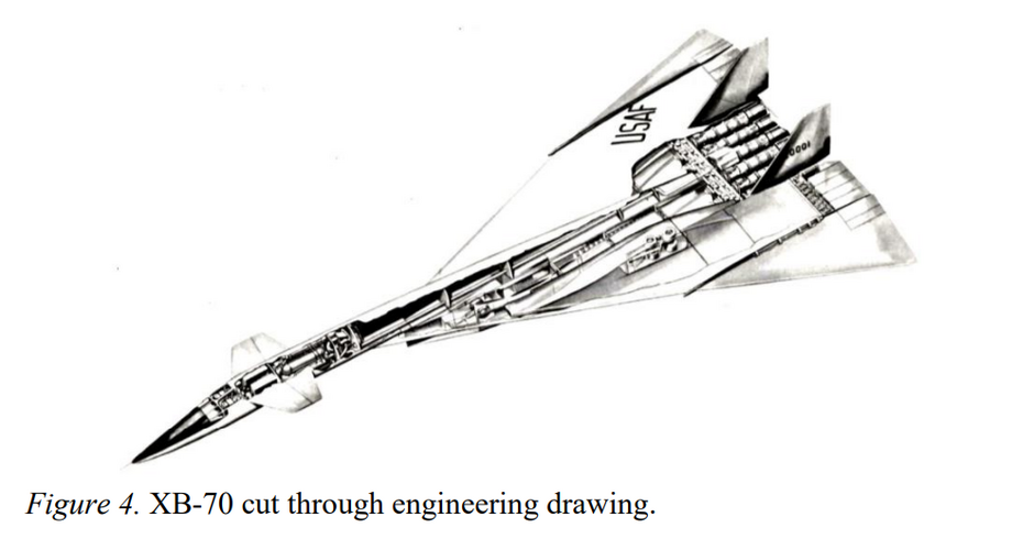

Is this wing cross sectional drawing correct?
Yes, hexagonal wing cross section!

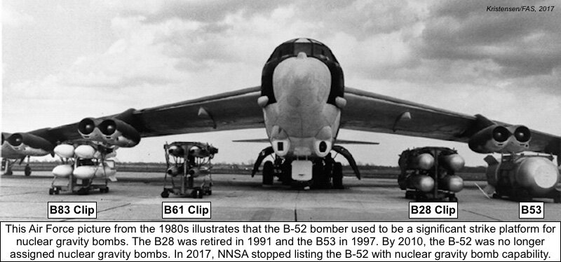

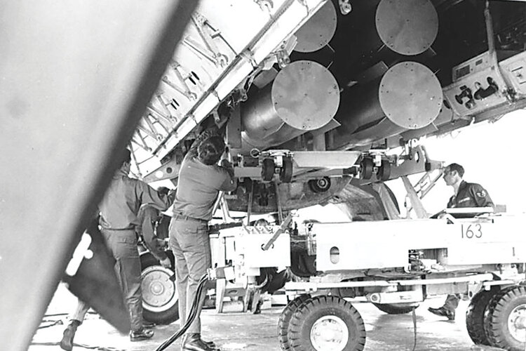

Prior to the introduction of the Common Strategic Rotary Launcher (CSRL), the B-52 Stratofortress carried up to eight 2000-lb or two 9000-lb thermonuclear bombs in a pair of "clips":
As explained in Valkyrie: The North American XB-70 by Graham M. Simons (2011), the XB-70 / B-70 Valkyrie has a pair of 14-foot weapons bays separated by a one-foot section. Due to the placement of the sliding weapons bay doors, each of the weapons bays could only be opened and used one at a time. This meant that the Valkyrie could not carry weapons longer than about 13 feet within its weapons bays.
By comparison, the bomb bay of the B-52 Stratofortress is 28 feet long and 6 feet wide (Baugher, 2022).
Does anyone know if the Valkyrie's bomb bays were designed to carry the same pair of "clips" as the B-52?
While I don't know, I'd be very surprised if they weren't.
Clips are a standard USAF rack, so it'd be easier to design the bomb bay around those existing clips than to design your own custom clips.
That almost brings a tear to my eye :). One of our Nav's, Jester, would always pick a B-28 laydown profile whenever he'd fly the low-level route with us. Referred to them as "Nation Pleasers" as a play off of a crowd pleaser.
And for a considerable period afterwards: for a long time, B-52s assigned to penetration missions carried one Class B/C weapon or a clip of four Class Ds in the forward part of the bomb bay, and eight SRAMs on a rotary launcher in the rear part.
That, plus twelve ALCMs under the wings, was apparently known as the 'doomsday loadout'.
Probable, I would suggest: there are contemporary documents indicating that the operational B-70 would be capable of carrying eight Class D weapons, which only works with the clips.
