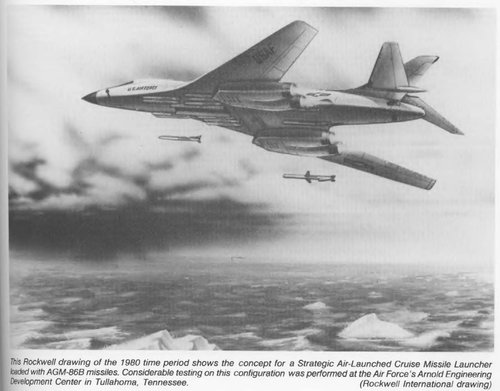

That model art is a good clue. Thanks.
In one of the screen captures flateric posted, you can just make out another pair of missiles on the pylons alongside the engines.
The model art most likely represents Agm-86.

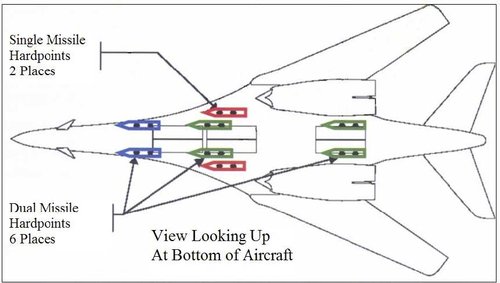

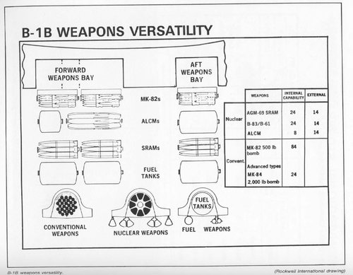

Loadout for Agm 86B on B-1b prior to Salt2 -
Fwd - 2x(2)
Int - 2x(2) main station + 2x(1) abreast station
Aft - 2x(2)

Those are the two station pylons. The two single pylons aren't attached.

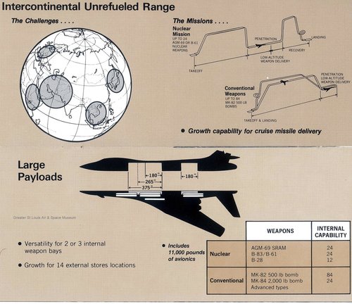

He's right, the B1-B is stated to have been capable of carrying 14 AGM-86Bs externally.
There are smarter people than myself here but the bone never did because of aerodynamics
Evidence? Aside from being forbidden by Treaty (which would be unnecessary if external carriage were impossible) I've never seen any such information. I also read somewhere that the AGM-129 was designed for supersonic EXTERNAL carriage, and the B-52 damn sure wouldn't be doing that. :D

Thanks for confirming. Its 14.

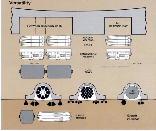

Also second row of graphics show how the bulkhead is moved forward to fit the hypersonic missiles (ALCM in the graphic)
So, a total of 10-12 ARRW could be mounted (6 external+ 4-6 internal (?))
Could it even fit on the existing AF rotary launcher, if yes, whats its weight limit?

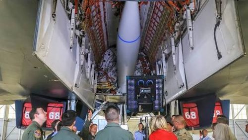

Forward bulkhead position, 8 AGM-186B at 3,150 lbs a piece comes to 25,200 lbs. My guess though is clearance will be the limiting factor, if GBU-31's already have clearance issues then the much larger ARRW will be worse.
