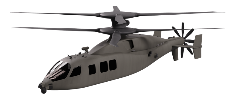

I wonder if there's also a "mild hybrid" option, which would be a conventional helicopter with only some Racer features to improve range and fly at 180-200kts? e.g.
  • Include an optional box wing kit to increase lift and range. This also would have other benefits like providing attachment points for weapons. Make it detachable for easier air transportability.
  • Retain Racer's low drag rotor hub (which also provides some useful lift augmentation)
  • Other aerodynamic tweaks... assymetric tail boom and H160-style biplane stabilizer
  • Ecomode on 1 engine for long range cruise at 120-140kts
  • Include all the latest innovations in materials... composite fuselage, lightweight windshield, replace hydraulics with electric (e.g. landing gear mechanism) etc
But ditch Racer's complex lateral propellers and shaft lines, retaining a conventional tail rotor instead?

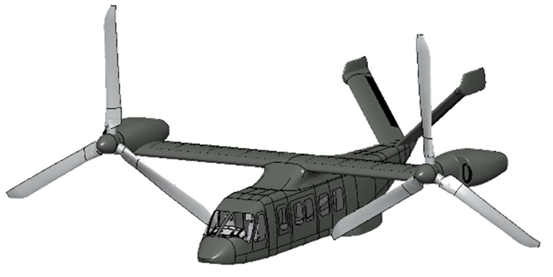

How are tilt-rotors still an adventure in Europe?
I apologize for not being more precise in my language. I intended my "adventure" comment toward Airbus. Clearly Leonardo is looking toward tilt rotor, if for no other reason than to capitalize on the decades long 609 (mis)adventure.
And they have very little to show for it so far, with AW609 certification not likely till next year.
Leonardo's other tilt-rotor venture, the NGCTR demonstrator, is hardly better... late and rather disappointing in its technical scope with only some small technology improvements relative to AW609 (vs what was originally billed as a new 19-22 pax transport opening up new O&G and city-to-city markets). NGCTR's first flight has been pushed (again) to later this year, once they fix the flight control software (which is probably quite complex on a tilt rotor?).

For NGCTR the FBW system apparently is extra complex due to the tilting nacelles, morphing wing elements (moving flaps) and V-tail. They've fitted an ejection seat (!) for the test pilot... which says something IMHO.
I expect the complexity is why Leonardo has teamed with the Bell Flight on the program. If my memory is correct Leonardo has elected to only rotate the nacelle components associated with the prop rotors to reduce the complexity for NGRC. Not surprising there has been a significant body of work done on tilt rotor by Bell and the U.S. Government.
