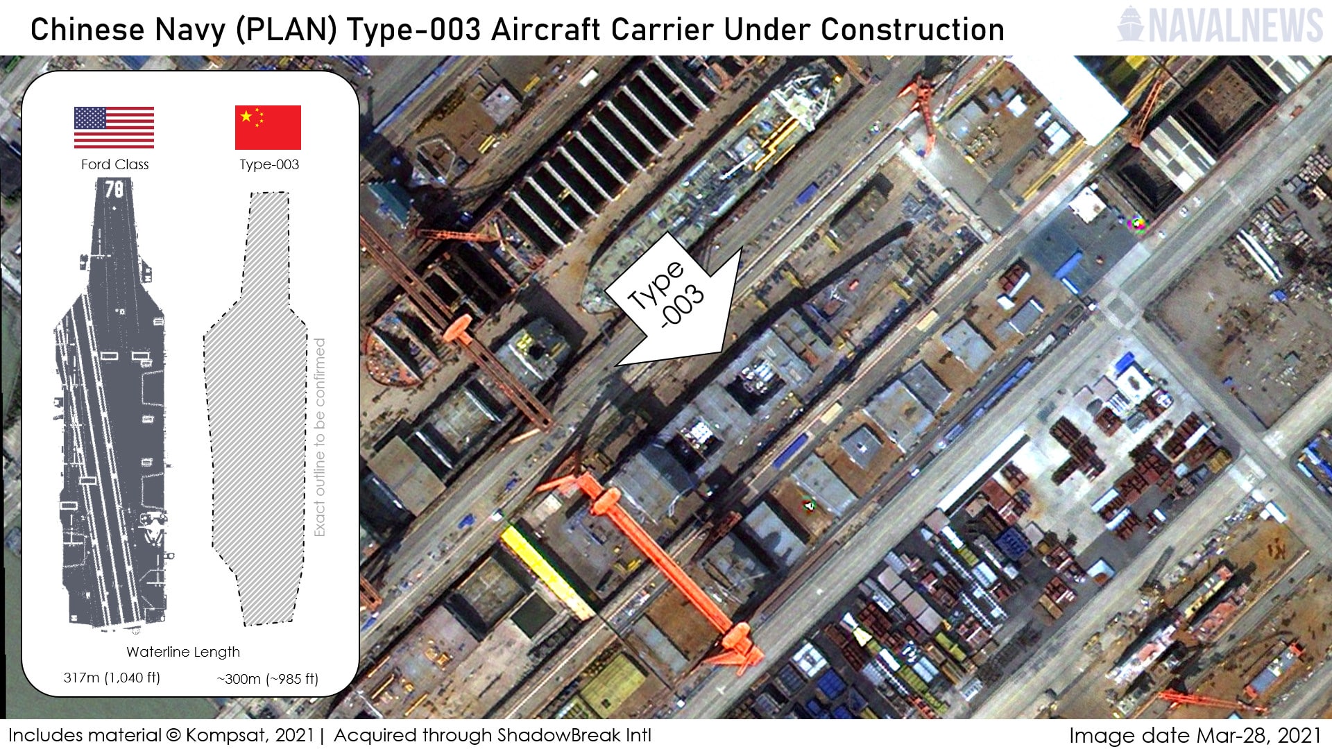

Have anyone try making estimates on propulsion power requirement ?
Tried a bit X3 tho it's very simplified with some assumptions, by using the length and beam of the currently constructed hull (draft is assumed to be 11 m tho) and displacement is 85000 metric tonne.
At first i just running the lines the entire "visible" length of the hull but then. I think those gaps between modules are to be closed and the hull united. (Otherwise it would be some 344 m, impressive size which rival CVN-65) The "united hull" however would be assuming Chinese not put anything more in between would be 305 m.
The speed curve and thus power requirement would look something like this :
Assuming similar Kuznetsov 200000 SHP power it would bring the 003, theoretically reach about 34.5 knot. But that's basically pushing the whole thing with no margin for something else (e.g electric power generation or steam catapult tank) For 30 Knot speed she would need about 135800 SHP
Working from there, the steam boiler parameters and then fuel requirement can be estimated. So assuming that she would need to match Kitty Hawk. Her fuel requirements would be about 12000 Metric tonne, for 19300 km of range. With 23 Knot of cruise speed.
The ordnances and aviation fuel however would be dictated by the campaign endurance and available space.

Again an interesting read written by H.I. Sutton and published at the NavalNews:
China’s New Aircraft Carrier Is In Same League As US Navy’s Ford Class
The Chinese Navy is radically modernizing its capabilities. Chief among these are a fleet of aircraft carriers. A new satellite image clearly shows the Type-003 aircraft carrier taking shape in Shanghai, and it is the largest so far.
