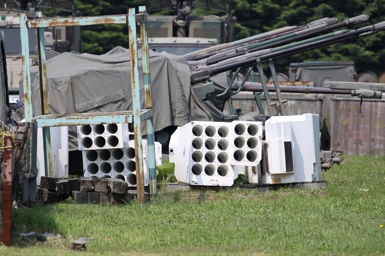

Something like what you are describing did carry onto the Type 90 though. FNBCETiagAgbOOC.jpg
The armored fuel tank rack has 6 rounds raised above the rest for the commander to be able to access easier in an emergency. The gunner also has 4 rounds that sit behind him incase of damage to the autoloading system. No idea about the Type 10 thought since we have no info on the ammo arrangement or even how many rounds it carries.
