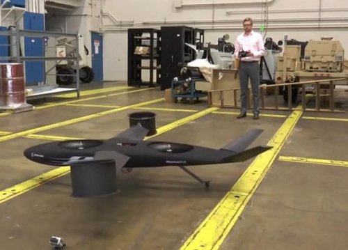

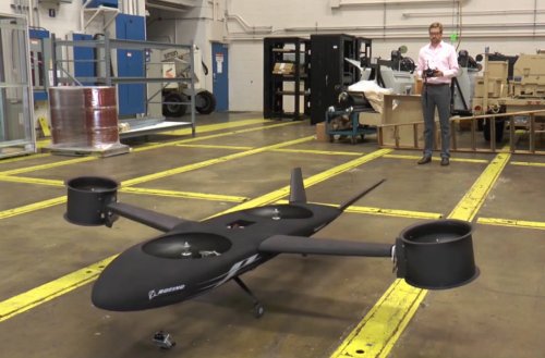

But in the moment I cannot remember another ducted fan design using fuselage mounted, fixed ducts plus swivelling
ones at the wing tips. Maybe the advantage is, that the tilting units don't need to be oversized, just for achieving VTO.
...agree!

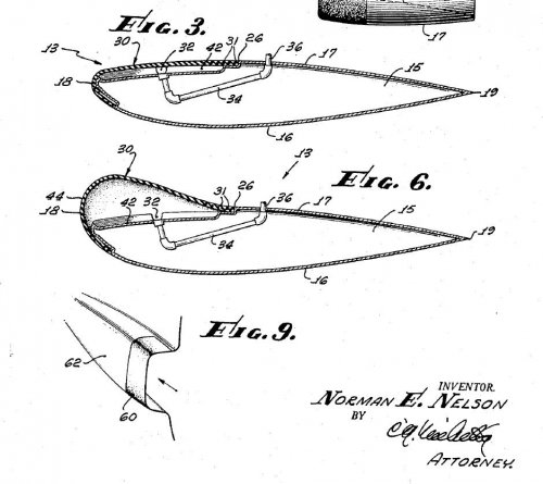

One of the challenges in making ducted fan viable for VTOL is to create a duct lip that is optimized for static thrust but has low drag in fast conventional flight. Creating a variable geometry one seems particularly complex (e.g. doak patent drawing). In case of the Phantom Swift the geometry of the fixed-fans could be optimized for static and the tilt-fans for dynamic thrust.
I wonder how the propulsion of a full scale model would look like...turbine-shaft driven, all electric, hybrid, ?
Btw, I've done some experimenting with a ducted propeller VTOL. Lots of fun ;D

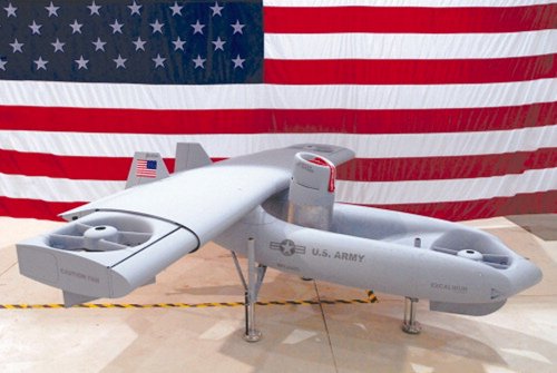

Maybe like this ;)
"Manassas, VA, February 4, 2014 - Aurora Flight Sciences announced today the award of a Phase I contract from the Defense Advanced Research Projects Agency (DARPA) Vertical Takeoff and Landing (VTOL) X-Plane program.
Aurora’s innovative VTOL X-Plane, known as LightningStrike, is designed for efficient hover and high speed, meeting DARPA’s ambitious goals for performance and useful load capacity..."
http://www.aurora.aero/Media/Press/Item.aspx?id=APR-312
...no pics of the LightningStrike so far :(
Btw, has the Excalibur UAV ever accomplished a successful transition to forward flight? http://www.secretprojects.co.uk/forum/index.php/topic,7280.msg62993.html#msg62993
I don't think they got that far before the funding ran out. No one was showing any real interest in the concept.
